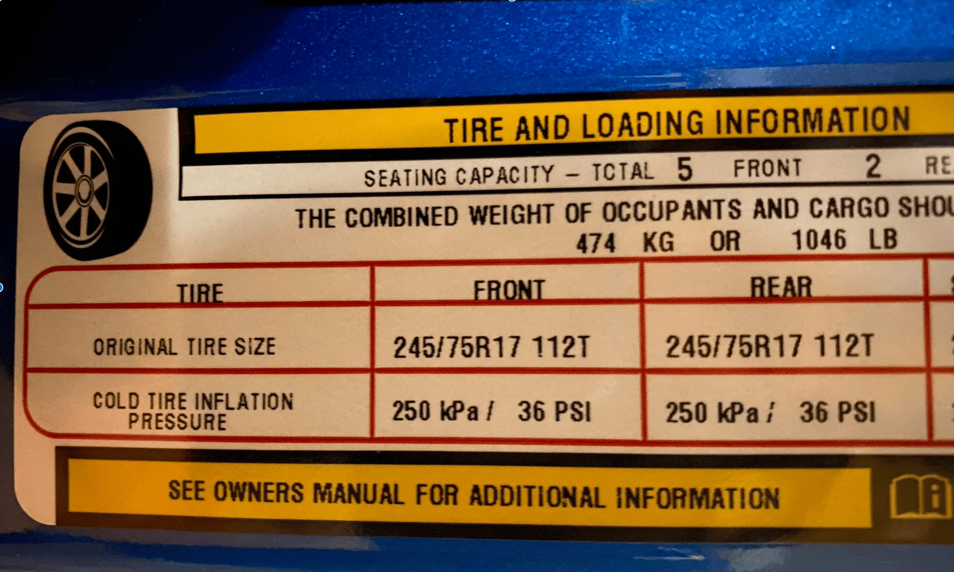

This was also a question of mine, I have a 2022 Sport S with M/T and my door sticker says my payload is 1046 lbs (I thought it should be closer to 1700 lbs!!!), my truck is fully loaded with hardtop, hard tonneau cover, bed liner, leather seats, etc. I still highly doubt that these extra options are 656 lbs!! the max payload is 1700 lbs for my year, model, and transmission based on the Jeep website.
After researching more and seeing this thread, here is my tentative conclusion: it looks like they have subtracted tongue weight (10 percent of 4000 lbs = 400 lbs) from the max payload for trucks that have the Trailer tow package in their build. Thus, when they say 1700 lbs on the website, they assumed you never tow as you don't have a hitch receiver, to begin with.
Therefore, take it with a grain of salt if you would: if you are not towing and only hauling, you can hypothetically add 400 lbs to your payload. That being said, my truck would be at 1446 lbs and all those extra options from the factory should be around 254 lbs which makes sense (@unsavycdr) Just to be safe, I would never exceed the limit on the sticker though until someone from Jeep engineers confirm this. @JeepCares

No, they do not subtract that.
Do you have MAX TOW? A Sport S without max tow is like an Overland, about 1100 or so pounds payload and 6,000 pound towing.
Sorry, that's bad info - they don't subtract anything. Payload is payload.
You must subtract tongue weight, cargo weight, family weight, dog weight, food and water, etc. from that 1046.
Looks to me like you have a Sport S but NOT the max tow option. Your payload numbers match a Sport S
If you do not have the receiver hitch, you definitely do not have max tow, and you do not have 1700 pounds payload and you don't have 7,600 pound tow capacity and adding a hitch can't change that.
Plus - the book's tow rating is the max with base options on a basic truck with max tow. That's the maximum, not a given regardless of options.
They do not subtract tongue weight, they don't assume you will or will not tow. They can't do that. That payload is the payload, period. NO, you cannot add 400 pounds if you are not towing. Doesn't work that way.
We've been down this road dozens of times in many threads, the real info is out there.

My Rubicon M/T with towing package is 1216. Hard top. Metal bumpers, spray-in liner. No other add-ons that affect weight. That's too close to the maximum of 1300 on my trim for them to be subtracting anything else
248
40,497
54,067
Bumpers, skid plates, bed liner, tonneau cover, etc.
Oddly, if I recall correctly, the hard top isn't much different in weight than the soft top. In fact, someone suggested with all the fabric and metal framing and such the soft top was actually a bit heavier. I don't know but seems I did read that here somewhere - someone had one still in the box.
It's really not magic - the number on the door jamb sticker is what it is, and no amount of wishing or trying to figure it out by suggesting Jeep figures you won't tow or whatever will change that. In fact, if you don't have a hitch, that absolutely confirms you do not have a max tow with big payload! That cinches it right there. No hitch, it's not max tow and your payload is lower and your towing numbers are down there, too.
Wishing or equations won't make it different.

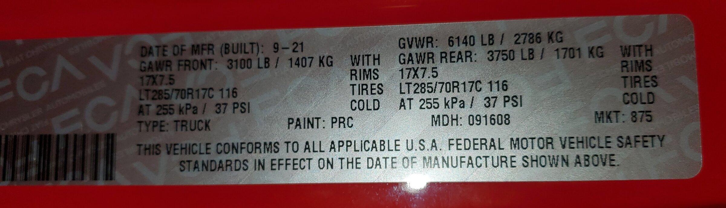

Is GVWR 6250 lbs across the board, all models? I think so, but it's listed on the door jamb. If so, getting weighed at a scale should tell you all you need to know. Heavier jeeps have less payload. Lighter ones have more. We can't go over 6250.
Mojave
Jeep Gladiator Payload Questions 20211104_222618
248
40,497
54,067

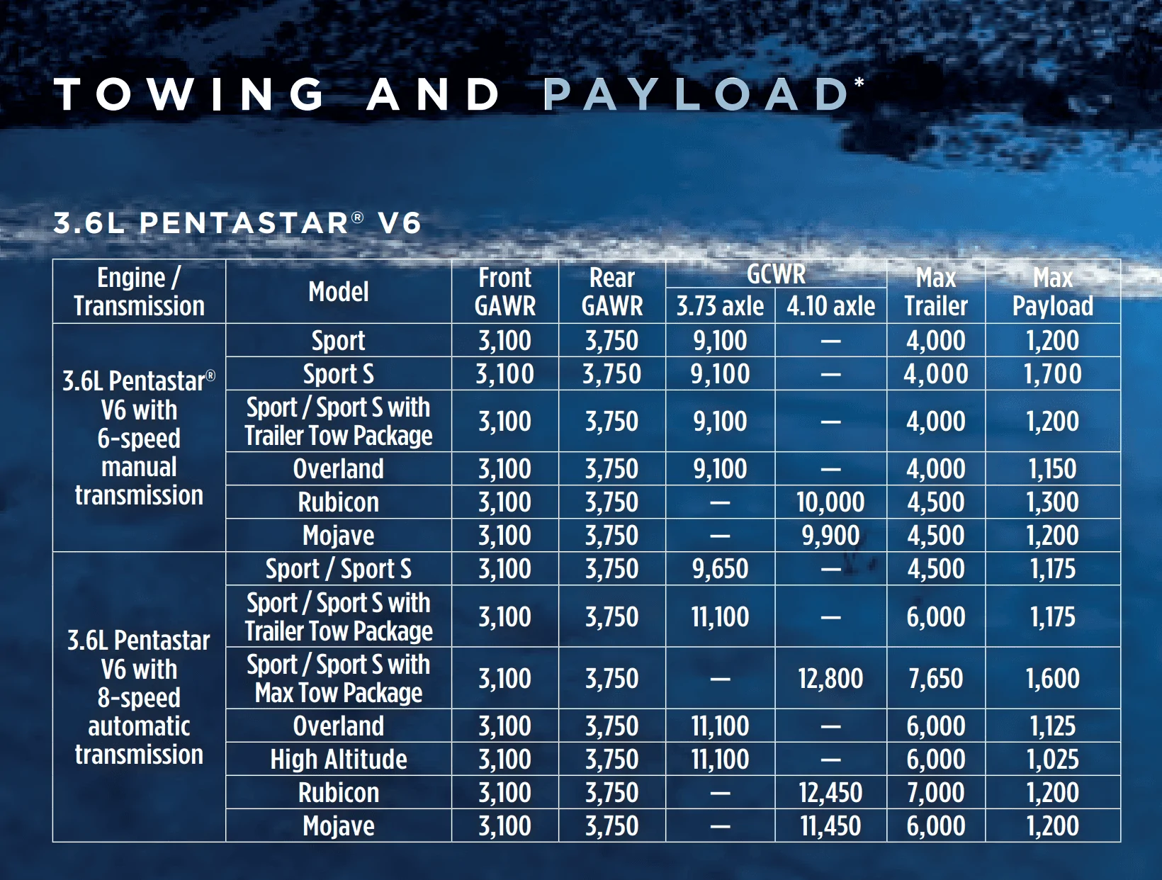

Here ya go.
4 columns are, left to right - Sport; Overland; Rubicon; Mojave ->
Jeep Gladiator Payload Questions 1649955324354
Sport/Sport S and Overland are 5800
Rubicon is 6250
Mojave is 6140
Those are "unless replaced by options" so the Sport with MAX TOW will have higher numbers than these.
These numbers are standard numbers. So a Sport and Sport S have the lowest numbers (with Overland) - and that explains the low payload number posted above.
Now to finish washing the oak stain off my hands and have some lunch........
Again if you read my post carefully, I have a 2022 manual transmission Sport S. None of the manuals come with the max tow package. The point you are missing is that you think max tow is the one that has the max payload. That is not correct. See this table that is from the 2022 Jeep gladiator catalog: https://cdn.dealereprocess.org/cdn/brochures/jeep/2022-gladiator.pdf
Jeep Gladiator Payload Questions 1649956159382
1700 lbs is the correct payload number for the truck's trim that I own. Well, you could argue that Jeep is lying. We are all here to chat and have a good time at the end of the day.
