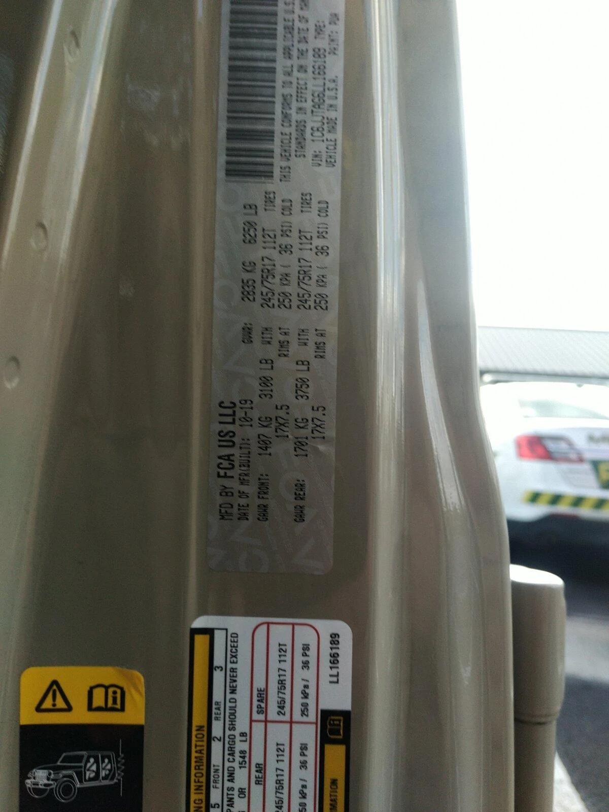

Advertisement shows MAX PAYLOAD "1700" pounds that must be a Sport with Manual Transmission and Soft top and No other options.
For me I don't expect to tow anything...I would rather get the Hard top.... I suppose that subtracts "100" pounds on Max payload.
?? However age 60 is not to far away maybe I should say yes to the auto Transmission??
If I say yes to auto/Transmission, and never towing, just concerned with payload capacity...does the 4:10 axle make a big difference in the overall driving experience ?? Is it worth getting the max tow just for the 4:10 and the wider axle. On a Budget build??
Budget build "SPORT" "HARDTOP" "ENGINE BLOCK" heater, auxiliary switches and Rear limited slip axle and if possible off road tires from the factory ??
