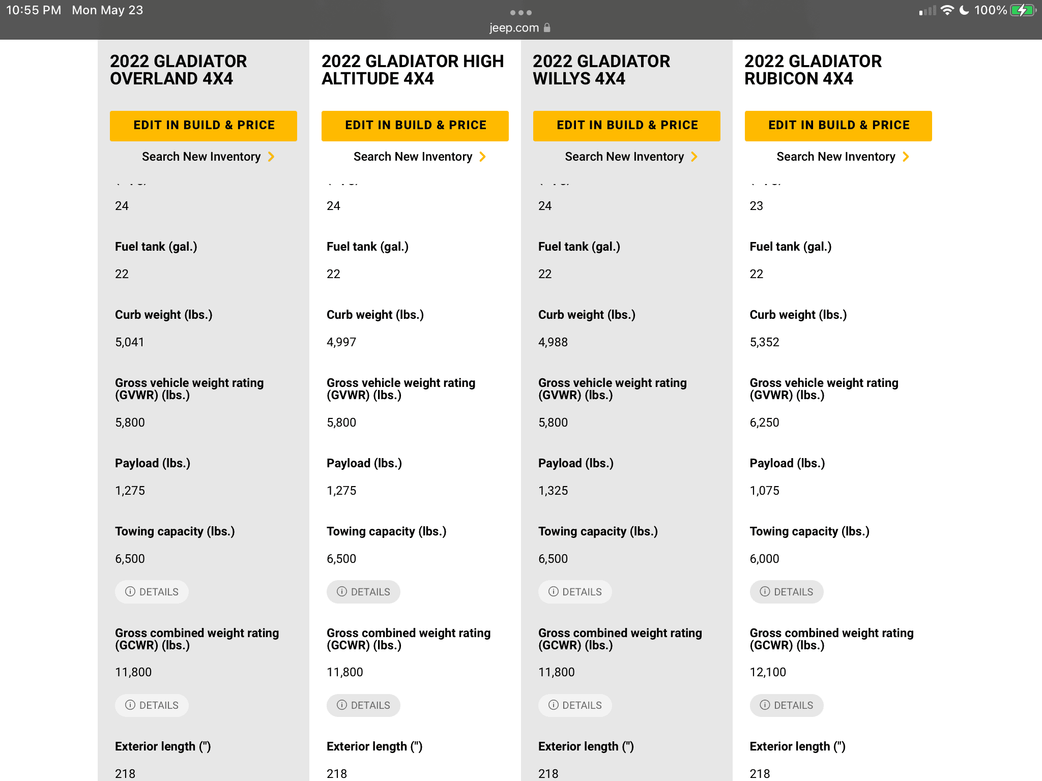

Dealer isn't going to have that information unless they find a comparable truck, same or similar options and check the numbers on it. It's a combination of options, not that each option is worth xx pounds.
If I was towing and hauling fishing gear and with me and the stuff, tongue weight and all, I was within a few pounds I'd not get excited about it. Hundreds over, I'd think again, but not for pocket change.
The dealer won't be of any real help here, unfortunately.
I wish they would of just told me that out of the gate Instead of promising me it would be 1200 plus. I really want one of these trucks but I wouldn’t of signed up for a 12-15 week wait without a truck and went a different direction. I’m almost 6 weeks in now so I guess time will tell…I believe I’ll slow down on buying accessories until it gets here and I know for sure where it’s rated and go on a diet :CWL:

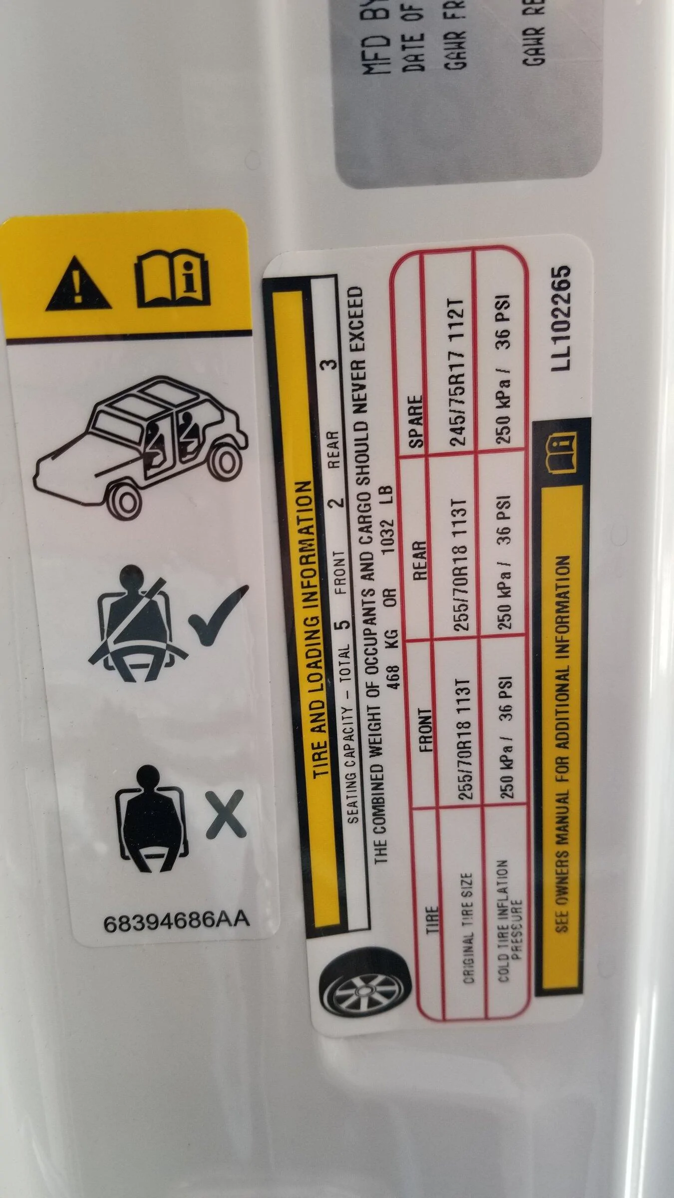

I haven’t configured my truck with anything but a bedliner so my payload should still be 1200lbs but I bet it’s not when I get it, so yeah that number is deceiving
Bedliner is probably the heaviest option available aside from steps and AT tires. I was told Line-X for my bed weighs about 40lbs by the shop if not more because they go a little thicker on the floor and tailgate. Jeep's version is probably lighter to a degree but you're still losing enough you'll have a reduced number.
And again, the payload on your door jamb is 100% meaningless; it's just a calculation of GVWR - curb weight - options done at the factory and it's there for guidance for people who hate math. The real limit is that GVWR so if you really care that much (I know I did after adding mods and had to tow heavy across country) then go to a CAT scale and get weighed up.
