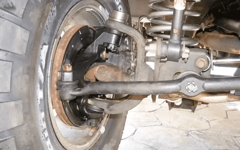

Not a jt but same idea. the castle nuts are the nuts that look like castles.

I believe it was on the lower control arm. There was a TSB reference it. Service tech told me that he tightened mine a little but the gladiator before me was 4 complete turns. My service tech also owns a gladiator so he knows the ins and outs. Pretty lucky there.
Happen to know what year the TSB is for? I have a 2021 Mojave and wonder if this is part of the reason that Iā€™m constantly having to put input into the steering wheel to keep it straight? Out of town and donā€™t have the truck to check and see if anything is loose. Thanks
