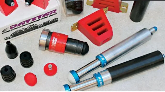

A hydraulic bump stop is essentially a short shock where one end is free floating. The intention is that it allows the suspension to be dampened towards the end of the travel vs a more abrupt operation of a rubber/urethane style.
Take a look at this photo; the red and black bump stops are urethane and rubber respectively (except the one in the middle of the picture, that may have a spring, but I am not sure) The silver and black "shocks" are hydraulic stops.
These do operate like a shock; they are typically pressurized with nitrogen and the piston travels through oil.
