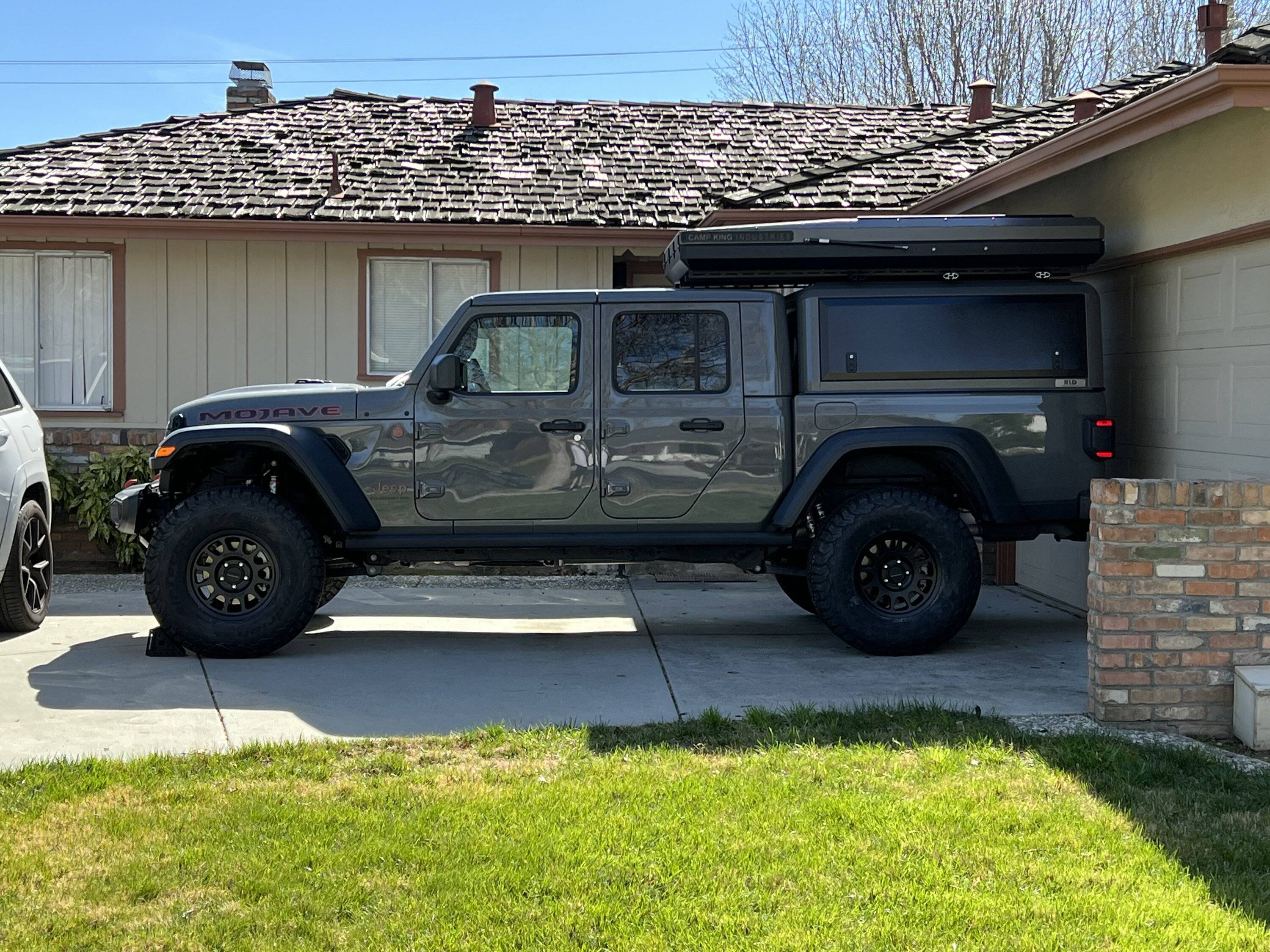

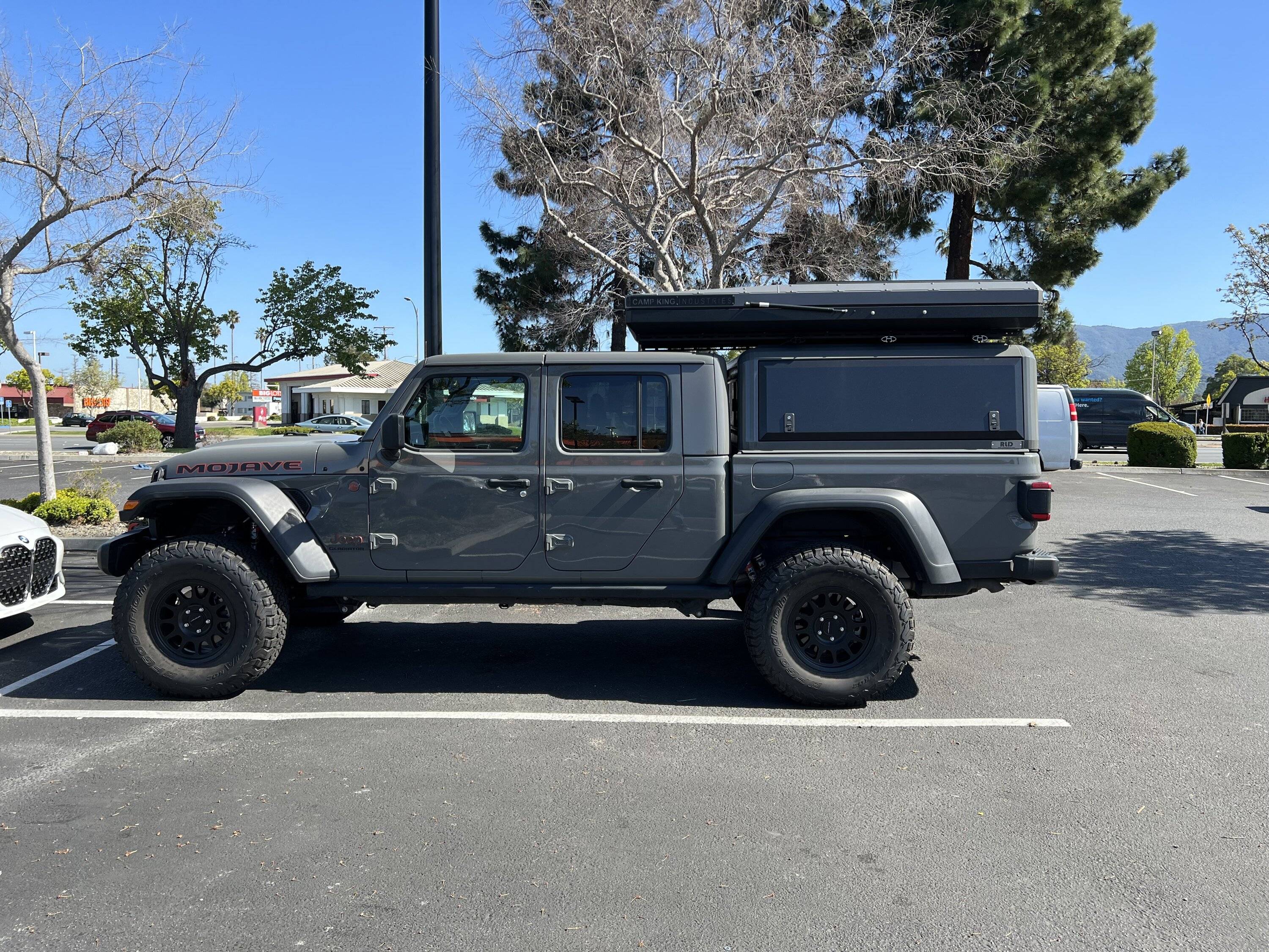

That looks PERFECT. Those rear lower arms are right at the angle I'm looking for but WITH the load! What did you do up front? Their same springs but for the front? Shock extensions as well or work with factory? (I'd like to keep them, hoping they respond similar to the Clayton springs as OEM springs.)
@ajkaz dude... IDEAL, no???
I should mention that the rear control arm angles could look better due to the Teraflex rear geometry correction brackets I installed.

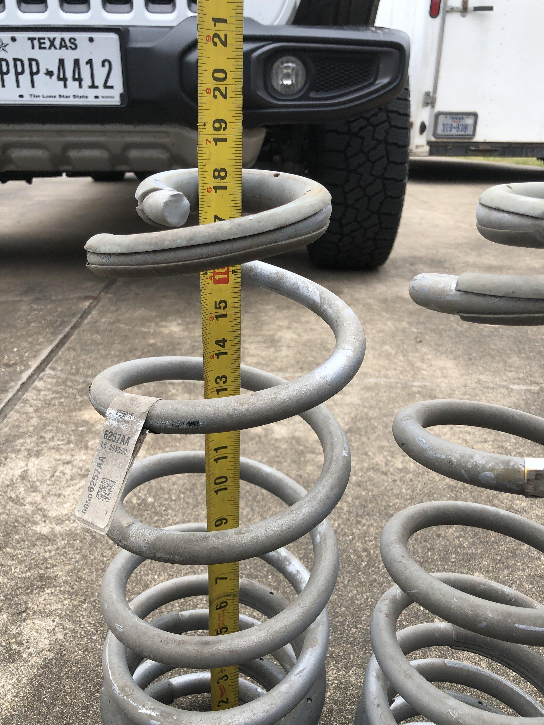

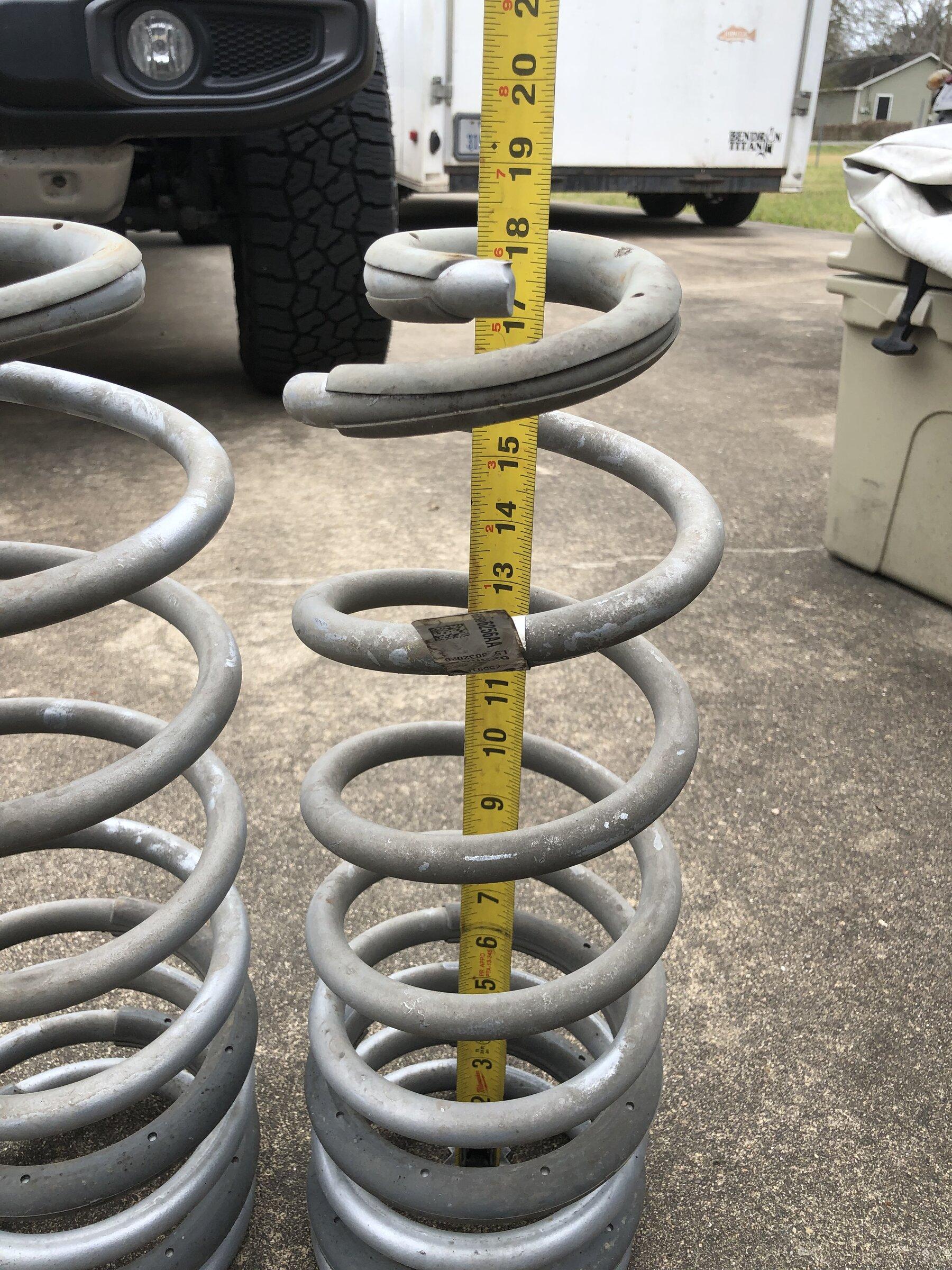

Looking at these Clayton springs:
Jeep Gladiator 1.5" Triple Rate Rear Coil Springs 2020+, JT
Triple Rate
Free Length = 21.250" +/-.25
Spring Rate 1 = 145 lbs/in
Spring Rate 2 = 250 lbs/in
Spring Rate 3 = 320 lbs/in
IIRC, the OEM front springs are 18" long, and roughly 150 lb/in rate. Anyone know the rear OEM lengths? (Rates seem like 170 lb/in I've heard.)
Looking at these Clayton front springs:
Jeep Wrangler JK/JL 1.5" Front Coil Springs, & Jeep Gladiator JT 0.5" Lift Front Coil Springs
Free Length = 18.00"
Spring Rate = 160 lb/in
My GOAL is to keep stock shocks, height, rake, etc... but while carrying the winch, front bumper, Decked, gear in the drawers. I don't love spacers, bags, etc. In my mind, I want the springs to do what they're supposed to do, no band aids, if that makes sense. I don't mind a little squat while towing my 4800ish lb trailer fully loaded. Currently, I'm an inch from the factory rear bump stops when towing the mostly empty trailer, probably around 3800 lb. and 400 lb. tongue weight. I also don't like the idea of losing any up travel with a massive bump stop or something like that...
I don't mind experimenting a little, but don't want to waste too much money getting it right.
