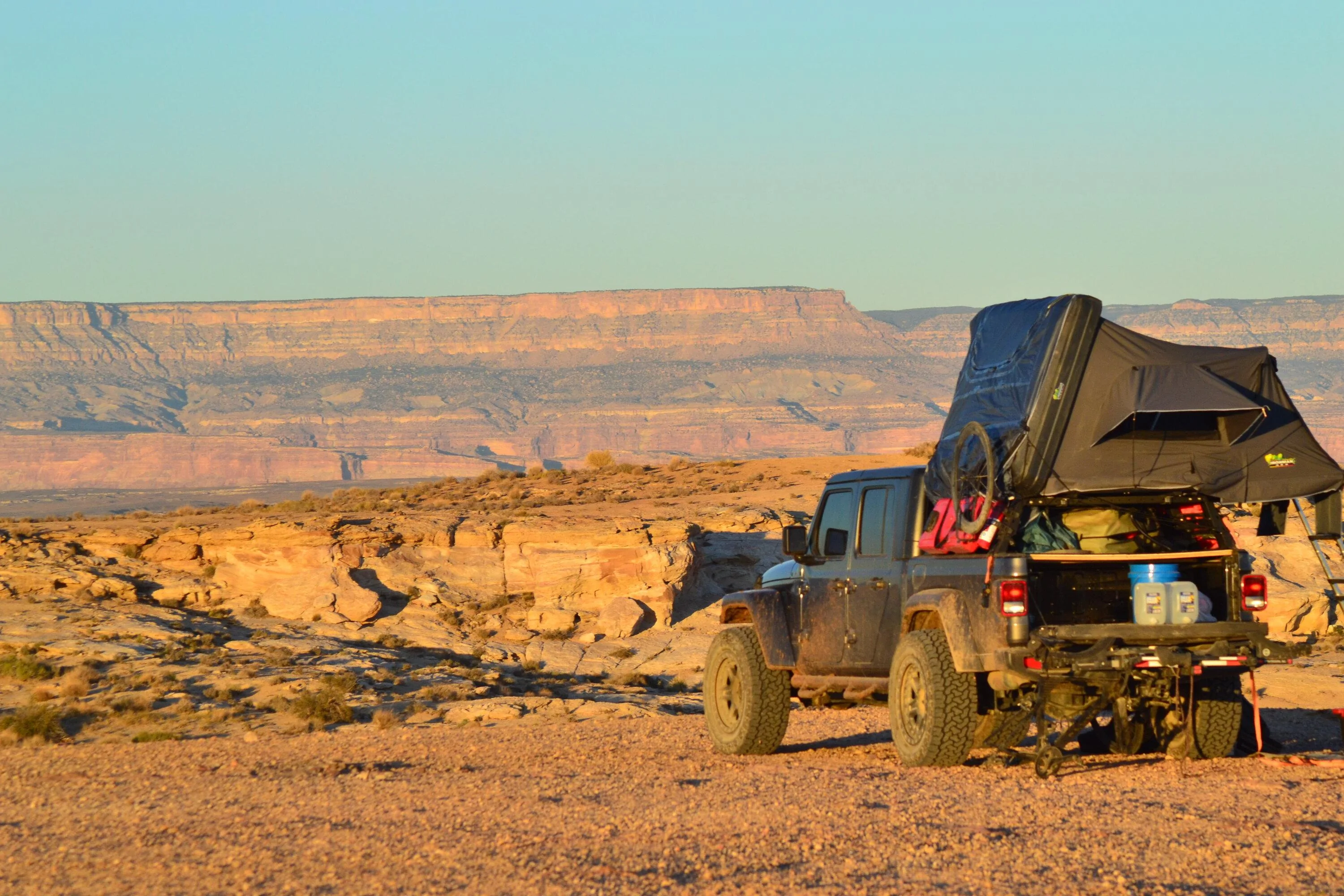

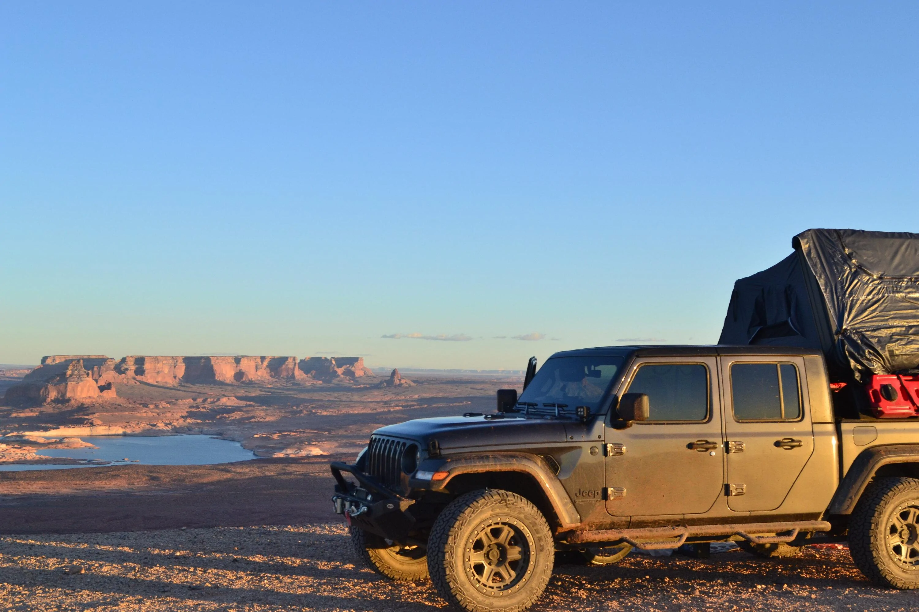

And just because we have to post pics this is from my trip where we stayed the night at Alstrom Point UT
