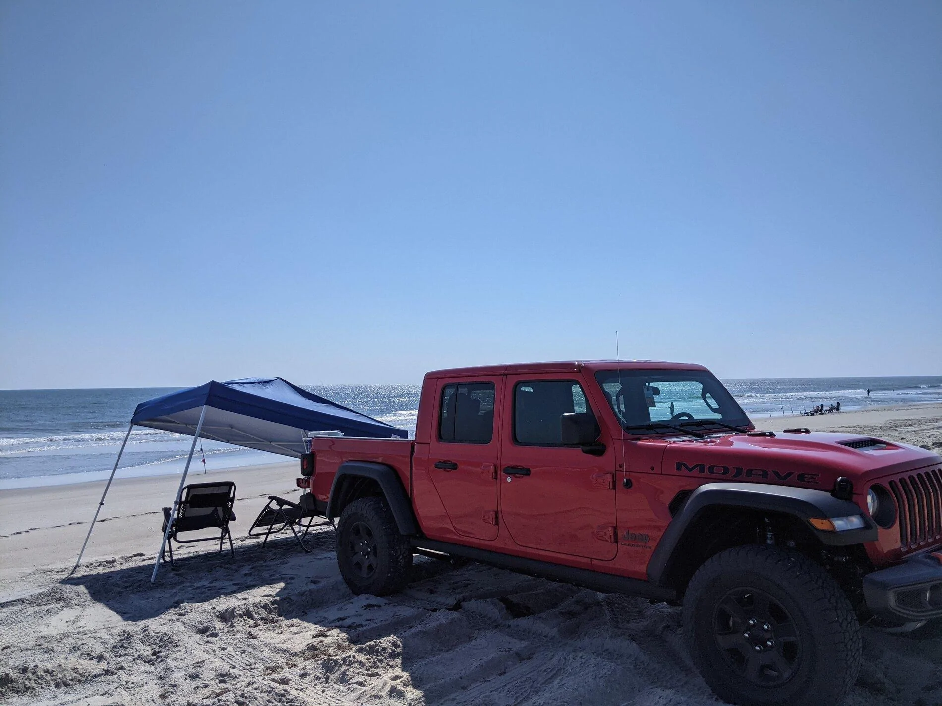

Absolutely did air down—from 40 psi hot to 17 all around . There's a huge difference in traction and ride comfort by airing down. Between the large footprint on the aired down Falkens, off road+ button, and rear diff locker, we literally floated through the sand. Even traversing across ruts was like cutting through butter.
