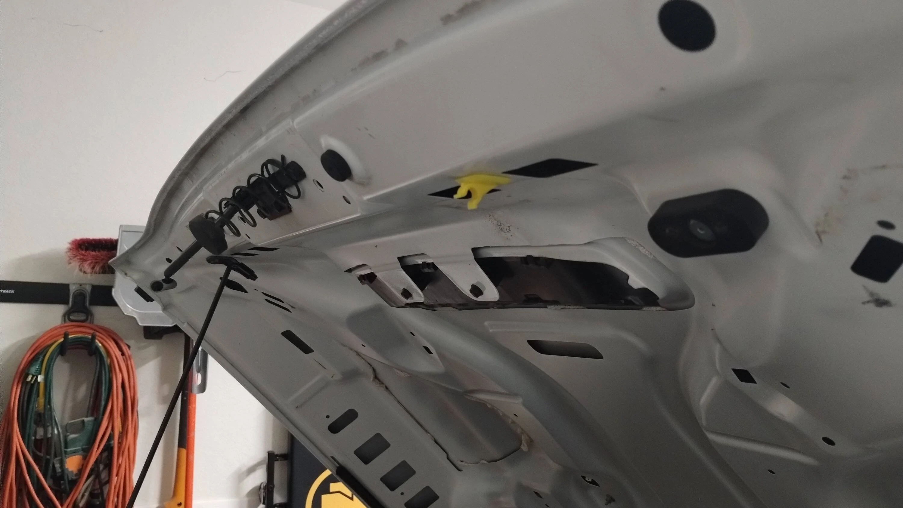

FYI, I've had my Mojave hood scoop functional for about 3 months now and have not noticed any unusual noises, even at 75MPH. I also removed the under-hood liner.

Well hell, this is troubling. Mine is white too, so it can't be that. Maybe it's just me, which is usually the case. Got up to 50mph with my scoop taped closed and no wind howl. I may have to start looking at the firewall for air leaks. I always get a warped one.
The only other thing I did under the hood so far is to reverse the hood prop catch. It was bothering me.

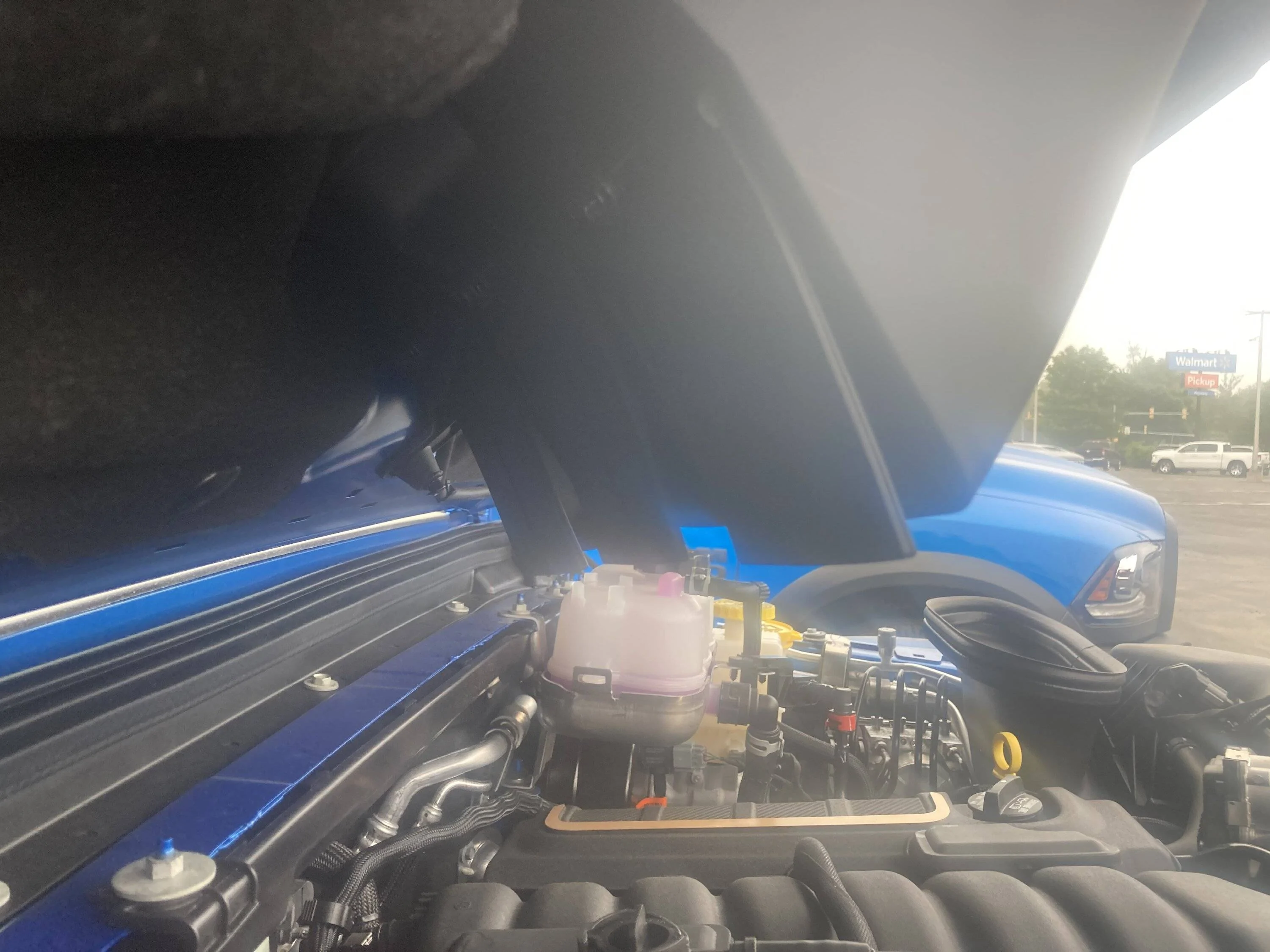

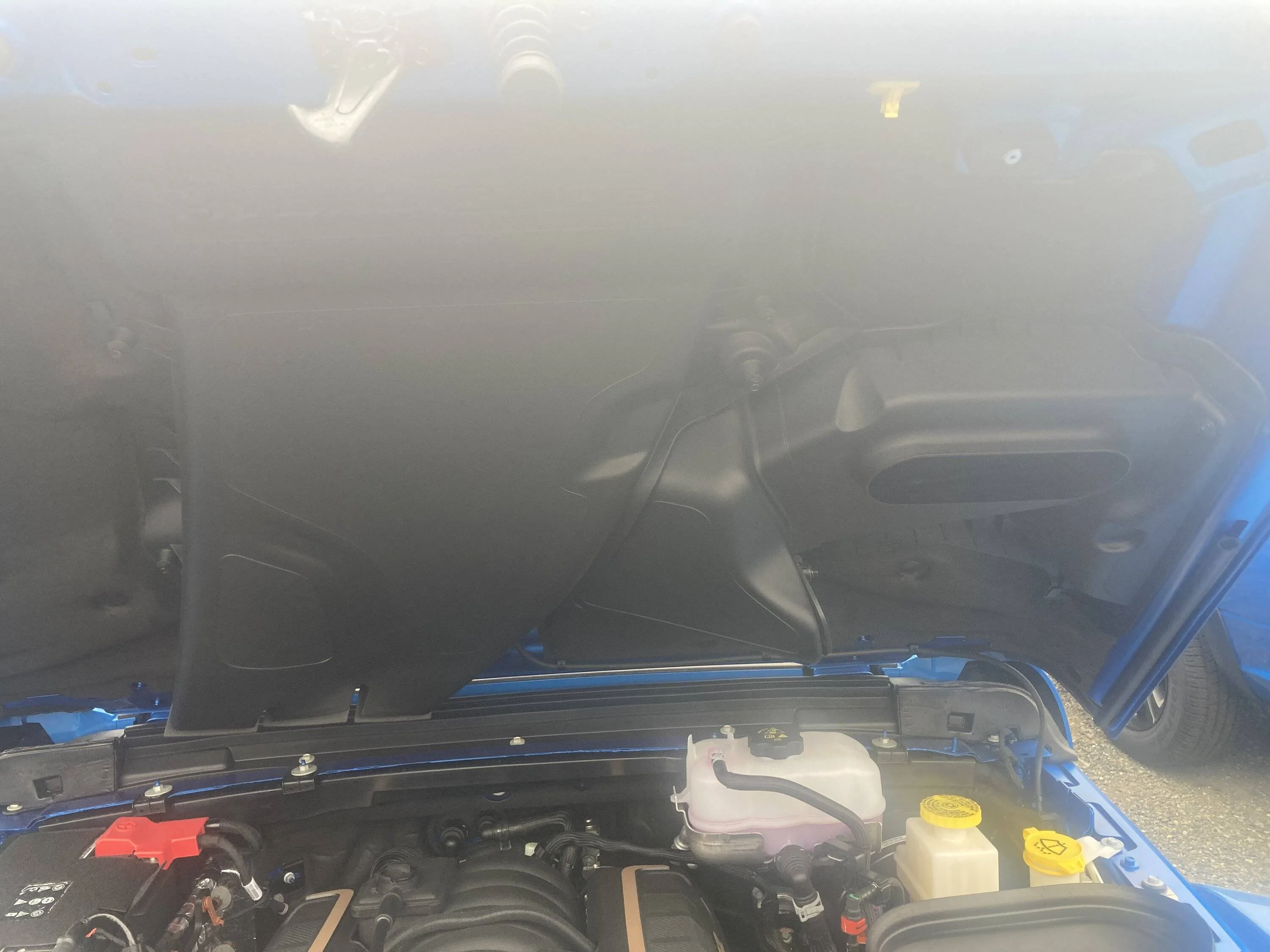

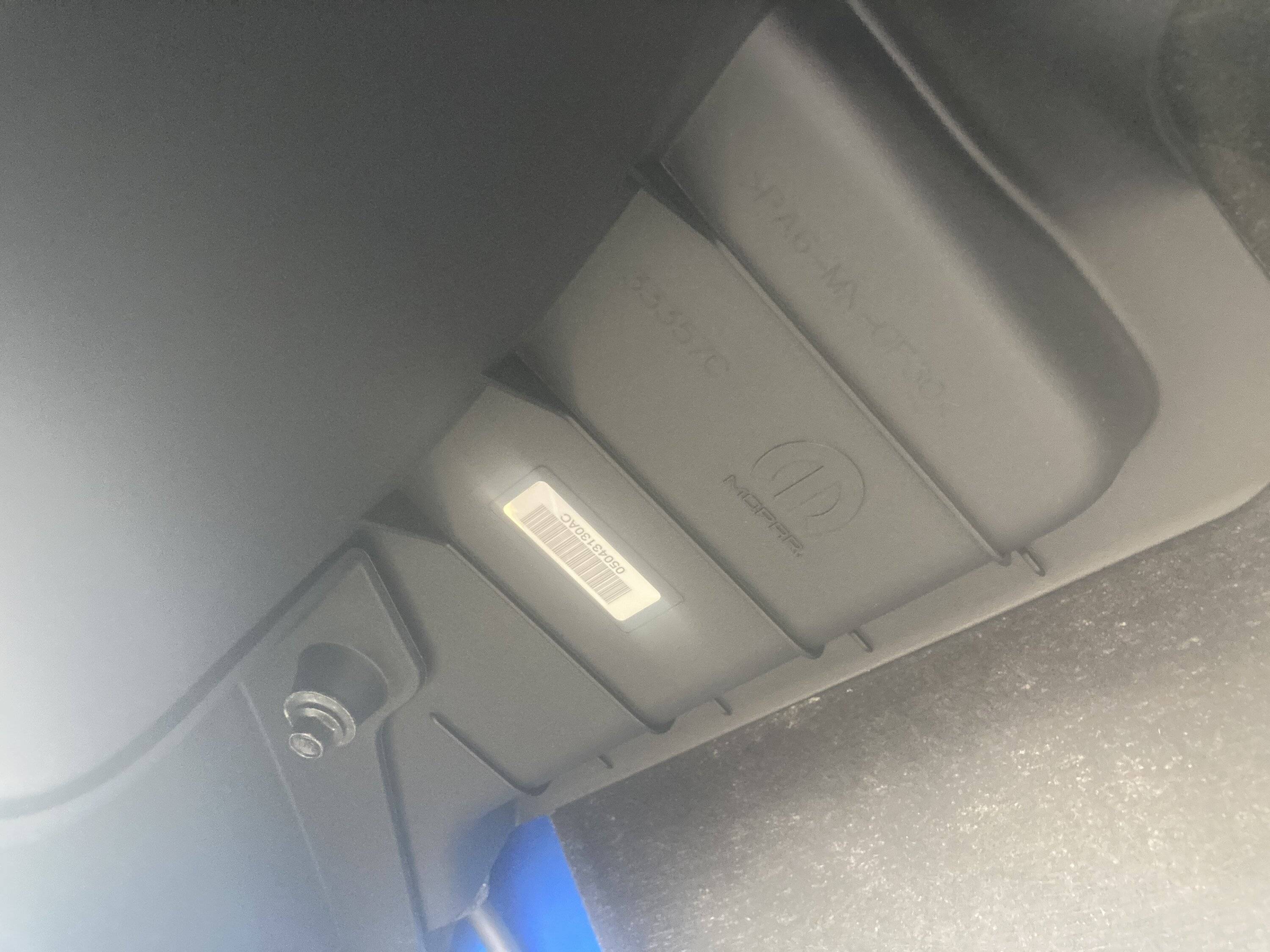

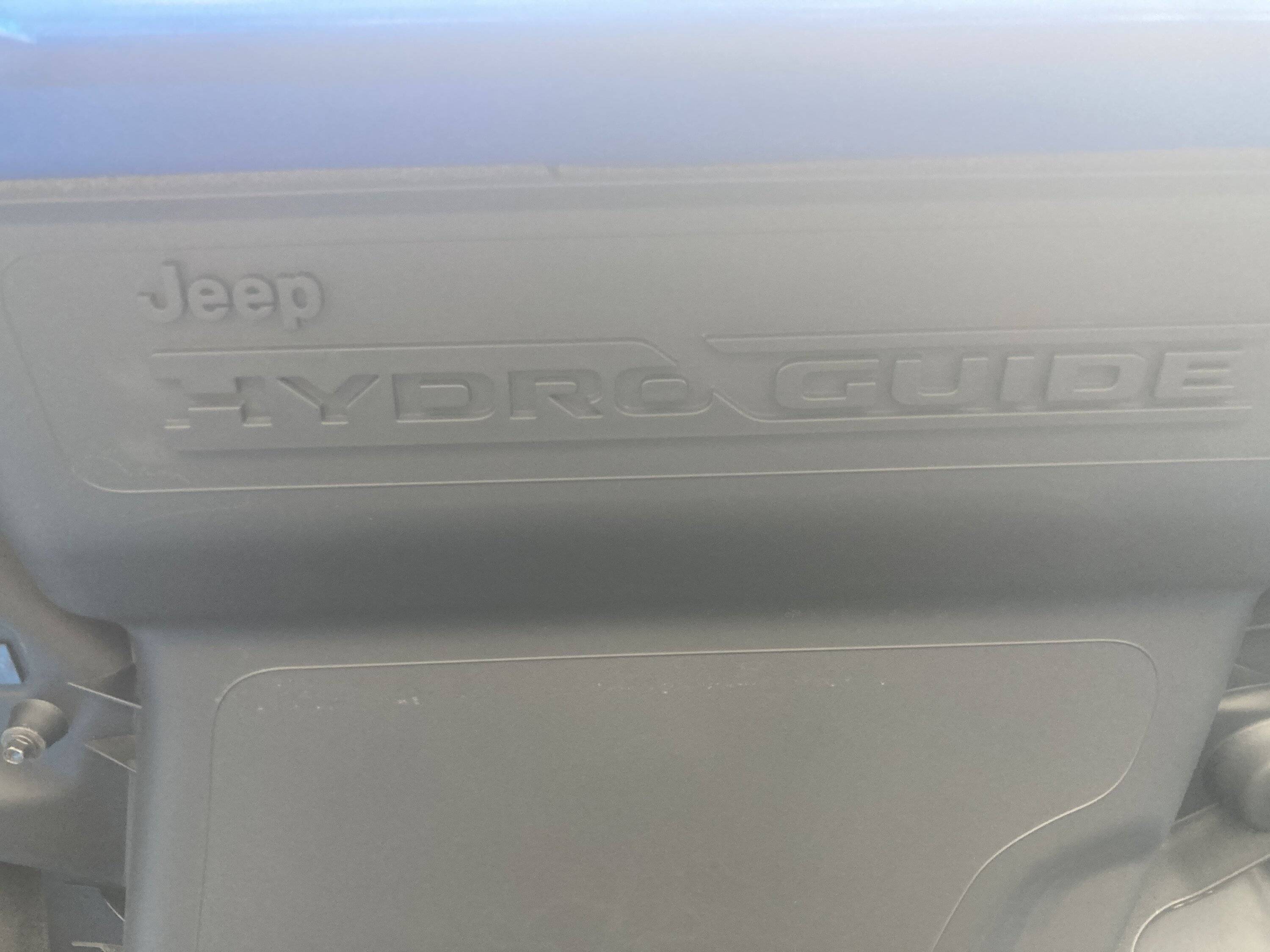

I've measured and priced up getting the Hydro guide system from a 392 hood for my Mojave, checked one out some time ago, pretty neat system, it does have direct air into the filter box but also has a lot of air vents directed towards the wheel well area, battery and exhaust area. The vents have rubber flap valves that shut air coming in when the fan pressurizes the engine bay, I am going to do it , and have a plan to fab a piece of starboard with flap valves in it where air intake for engine lair box leaves. Jeep designed the system to handle tremendous amount of water entering hood scoop but those same vents force water out of air stream before going to engine. A lot of guys say you can't have air come into engine bay from Mojave scoop but Jeep did do it, I also in my mind I think the large fan does nothing for you at high speed and is probably almost freewheeling and not pushing any air until you slow down or stop, thats when you need a lot of air through the radiator and the Hydro Guide system is closed by the pressure then. There are a bunch of guys that have done it, there is a guy that bought a wrecked 392 white hood and swapped it in for short money. So do it others have and we have not died, I'm doing it pretty soon...........
Unless your problem is not the hood scoop but your dog hanging out the window howling as you fly over the bumps and that sand we drive in all the time! I don't think your a dick about this, do you.....Jack
Jaxmax
Jack
Jun 28, 2020
54
2,859
4,640
Bally, Pa.
Electrical Manager
Dick, not the best pictures the words Hydro Guide letters are right about where hood scoop is, my dealer actually gave me keys to a 392 when they first came out to check the hood vent system , when I asked if I could take it home to show my wife he said no way after you asked for the keys to the same color one as yours!…Jack
