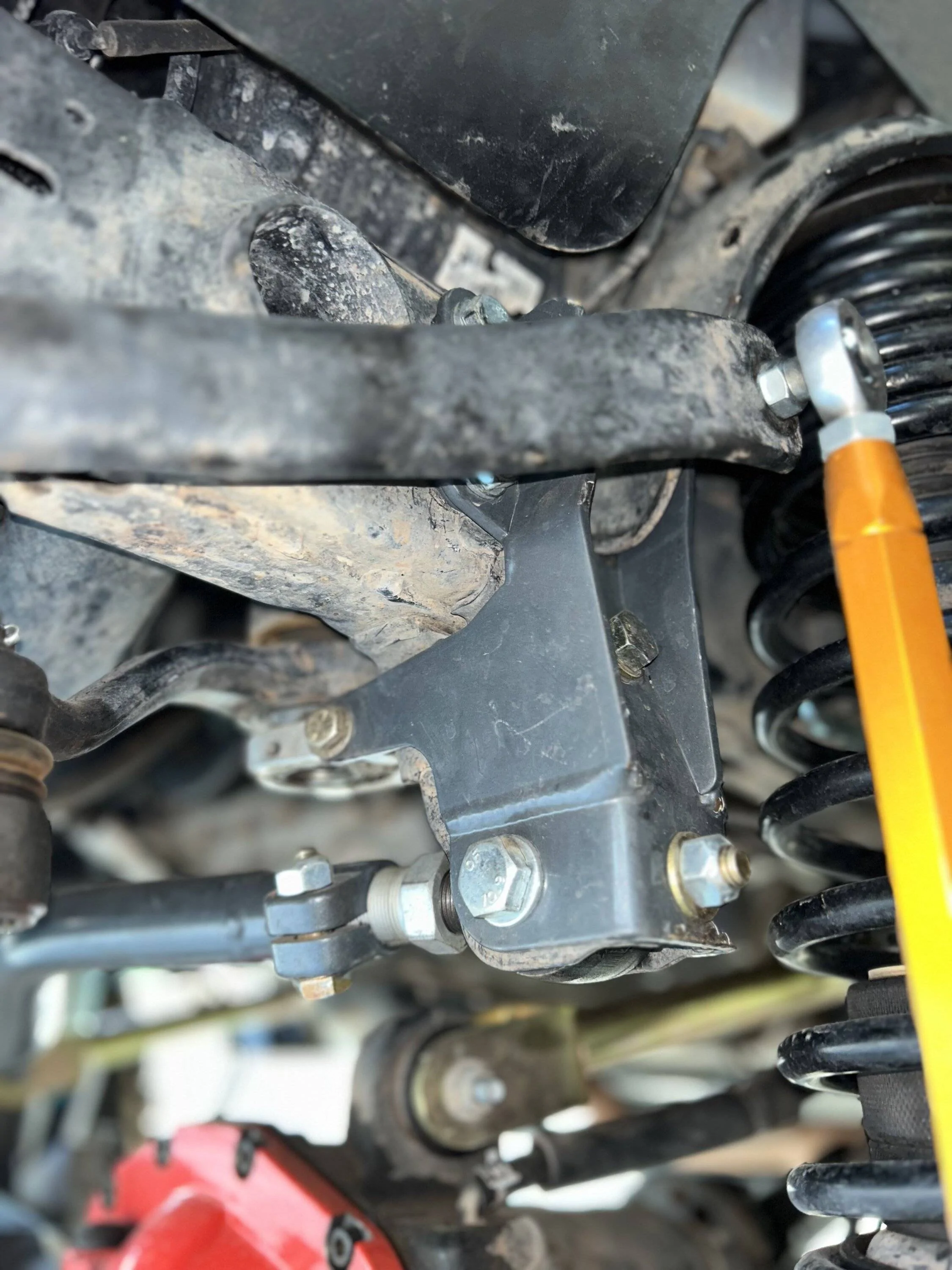

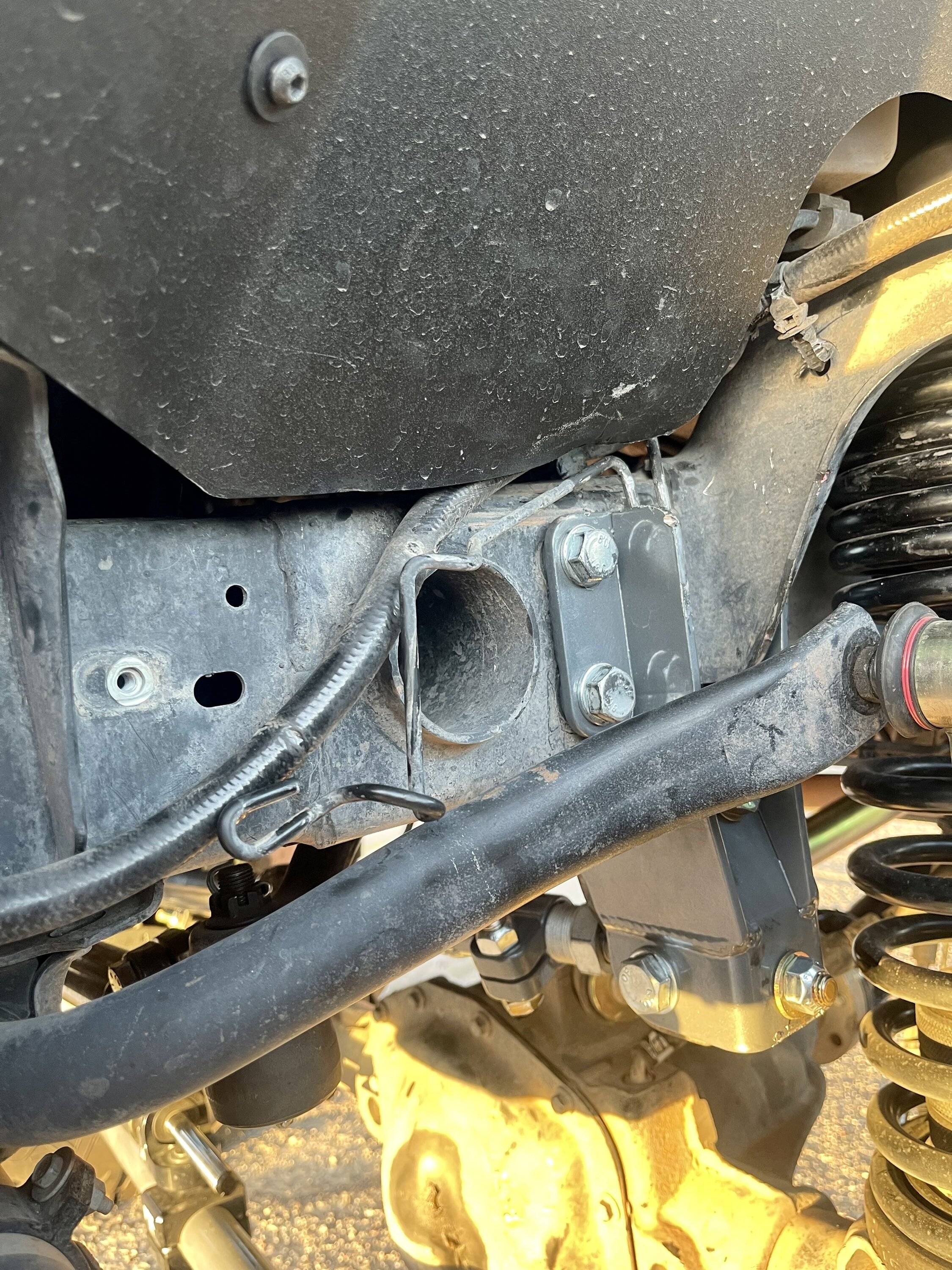

I think you're on the right track all around though if changing your tire pressure puts the ride quality where you like it I'd leave it at that.
I just bought a set of the same control arms to use in combination with 4.5" drop brackets for a 6" lift. Fixed LCAs have their benefits and drawbacks. So far I've had a good experience.
The steer smarts sector shaft bracket is a little more robust than the synergy one though who knows if that difference matters.
