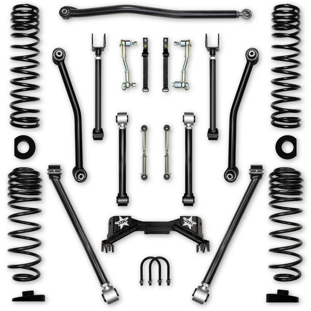

I am adding the RK 3" lift setup with Iron Rock Offroad 2" shock spacers after speaking with Jeremy at RK at length about my setup.
It's all being powdercoated right now and will be installed next week. It will clear 40s with my fenders.
https://rockkrawler.com/jt-3-0-inch-adventure-pro-system/

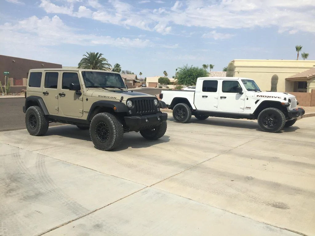

I had an AEV 2.5-inch lift (and their geo correction brackets) with Method Wheels/35 KO2s on my '17 Rubi that I traded in to buy my Mojave last week...
While I'm typically NOT a fan of spacer kits, in the case of the Mojave it's exactly what I'm looking for. The Mojave's suspension was the main reason why I bought it, as the Gladiator wasn't even on my radar until it came out. I live desert-front in SW AZ and while my Rubi got me around just fine, with the the type of terrain and driving I was doing it did it so REALLY slowly...the wash road that's less than 50m from my back yard has whoops that are a foot-plus and anything faster than 20 MPH and the Rubi would be pogo-sticking and bucking like nobody's business, which, is completely what I would suspect to begin with; that's not what it was built for.
The trails I ride are NOT conducive to owning a Raptor/TRX either as their typically Jeep sized and while some of the riding I do is wide open it wasn't worth the trade off for me to not being able to ride on the tighter/narrow trails anymore.
With just a few days of ownership and nearly 300 miles of high speed desert riding under my belt, the Mojave absolutely lives up to my expectations and exceeds some of them. Where my Rubi had previously motored through at 20-25 MPH the Mojave does so at 35-40, sometimes 45 MPH. It's not just the speed either; the dampening is SO much better and dare I say, "plush", a word I LOATHE to use to begin with, never mind to describe the suspension of any off-road vehicle.
I can't imagine wanting to change the shocks/springs which are giving me the ride I'm thoroughly enjoying which is why the AEV spacer kit with their geo brackets suit me perfectly. If I need an adjustable track bar and/or lower control arms to keep the alignment where it needs to be to ride as it does now, that's fine with me. Add Apex sway-bar links I'll and a set of wheels/35 KO2s and that'll do it for me, YMMV...

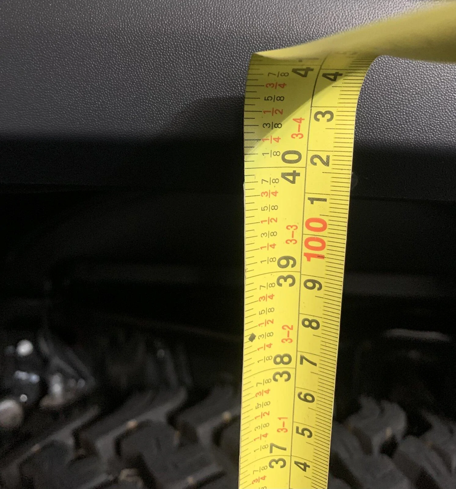

The front on a stock Mojave sits at 39”and 3/4 from the ground to the front fender crease on the black plastic texture part of the fender

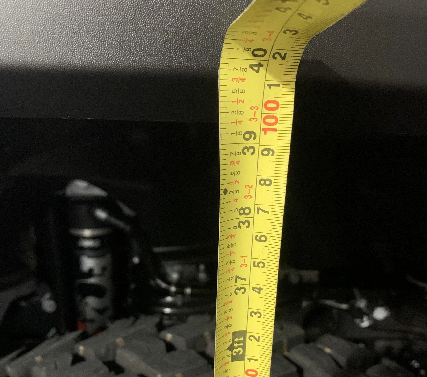

The rear sits at 40” and 1/4 at the crease from the ground.
If you need any more measurements let me know.
Can you measure from the upper and lower point where the shock mounts to the shock extensions in the front?
I’m curious once lifted how much it moved from the original ride zone position if at all.
