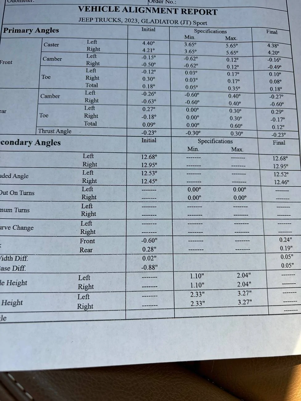

I got the 2.5 Ride Right and added the Fox shocks and Fox steering stabilizer.
it just wanders on the road and feels sketchy on highway

Did you get an alignment done?

Yes alignment was done and drives straight think I just need to get used to a lifted Jeep again. It drove so perfectly stock

Do I need geometry brackets if I got the adjustable lower control arms?

I don’t have the brackets but a lot of people swear by them. Are your control arms basically level? Can’t see in your picture but it looks like they are angled down. More level they are better ride. There are a whole lot of opinions out there ,do some searches. Biggest downside of brackets is they hang low, but for your use you should be good…..Jack

I love the Jeep and it rode better today getting used to it. Just need to remember how much differently lifted jeeps handle
40,493
54,056
Caster is good for stock, but a little low for bigger tires.
Around 6 degrees is what you want.
Yeah, I'd consider that low even with my own overland.
iMO, it's just barely in the "Ok" range for stock. I put the MOPAR LCAs on mine as one of the first changes.
If i recall the specs correctly, he's just inside the range.
But with a lift, like he's got, I'd put on the geometry correcting brackets and aim for 5.5-6 on caster.
He's got taller tires and different wheels (did he mention wheel specs??) so toe may need to be set outside of specs to compensate for the added tendency of the tires to want to 'drag backwards' - or scrub.
It's a system, and changing xx parts often means you must also change some settings, and change other parts to get things back to "right".
