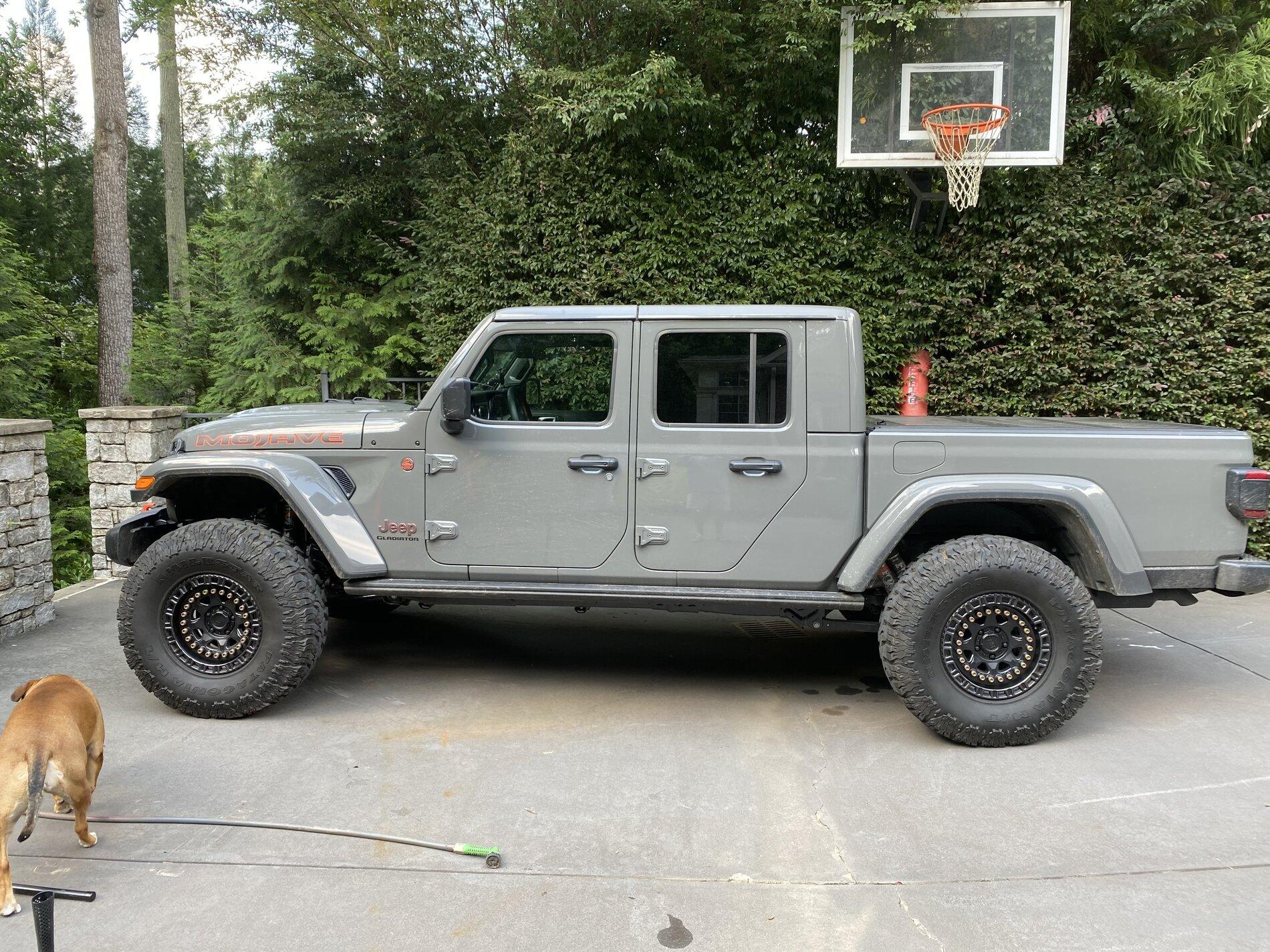

Any update on your lift? Pics?
Yes! Sorry been busy lately and forgot to follow up on here. We installed the rusty’s 2” lift with their shock extensions and their springs that they partnered with Eibach on. I have about 1k miles on this setup so far and have already hit some trails with it. It has performed great so far. The springs are a little stiffer than the stock but seem to work well with the fox shocks. Still rides great off of the pavement and have not really noticed any negative effects from the new springs. It gained just under 2” of lift. The lift kits parts appear to be good quality, time will tell. Personally i am very happy with this setup. I will update with any issues I run across but everything is working well.

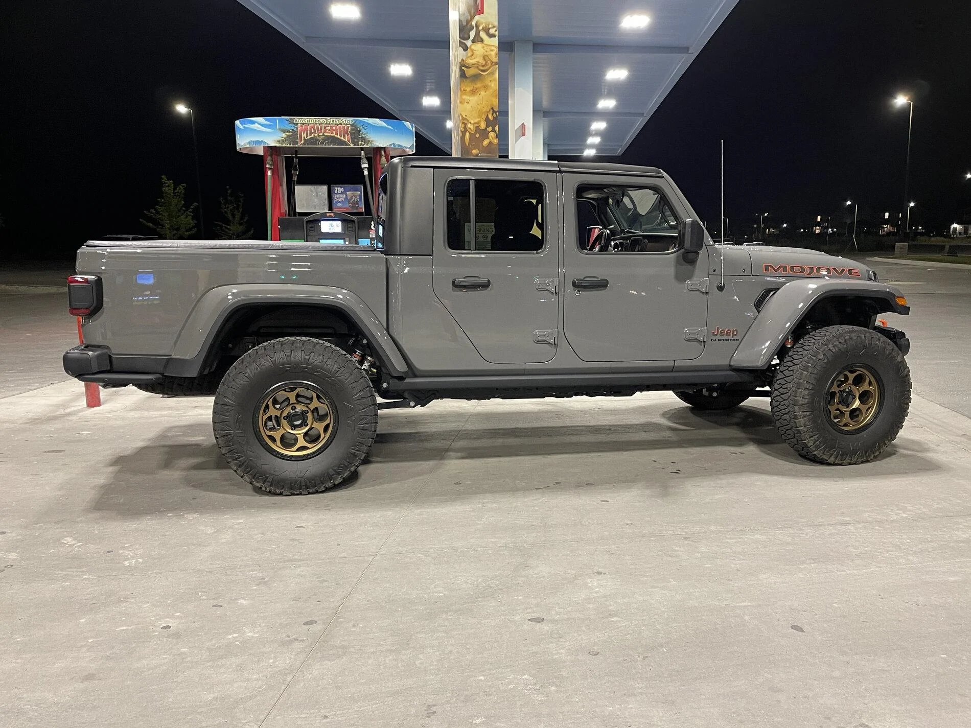

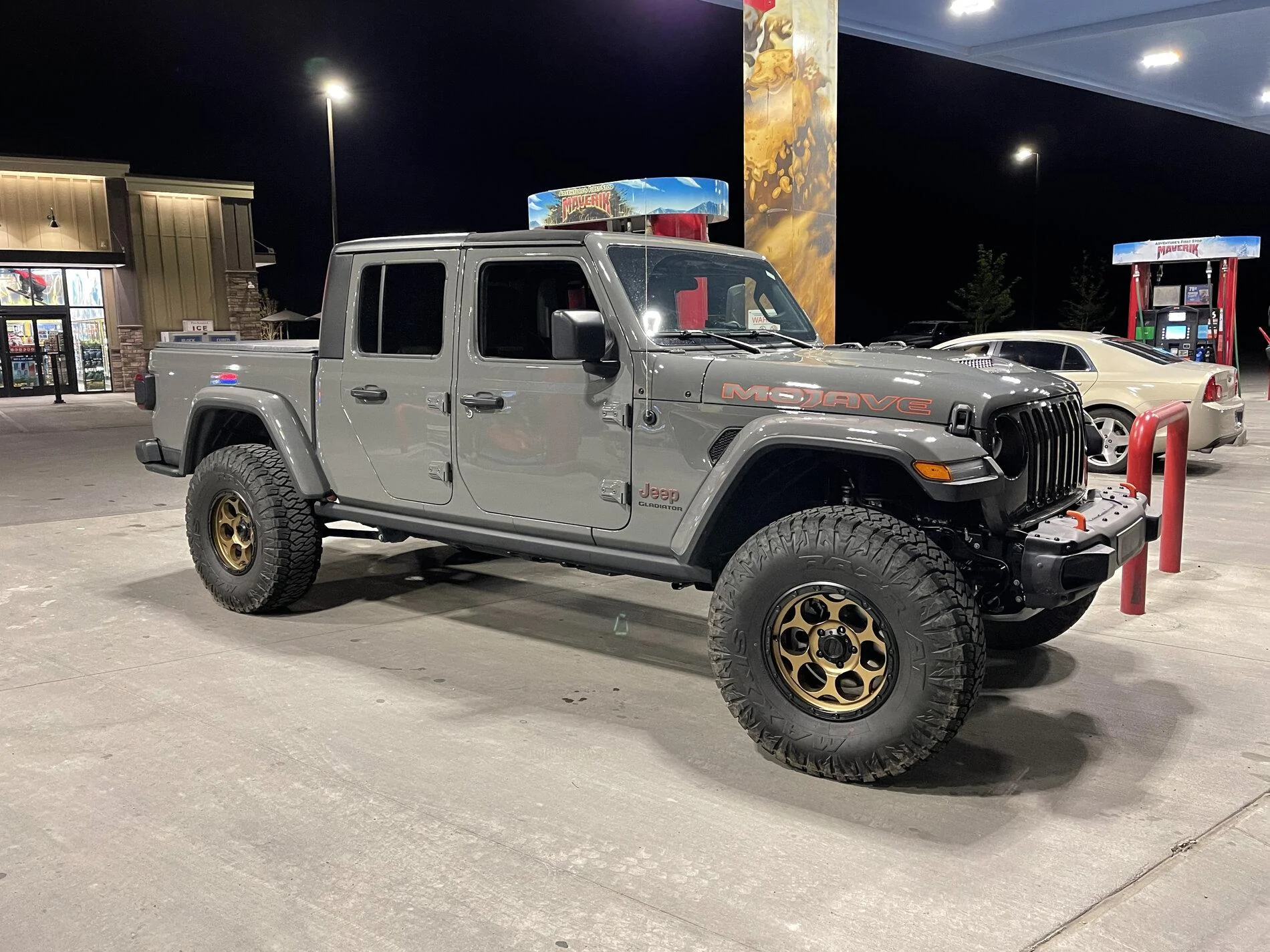

Finally got the AEV lift installed. Also did their geometry brackets and Teraflex track bars.
Tires are Maxxis Razr AT, 37x12.50r17 on KMC Dirty Harry wheels 17x8.5.
With the stiffer springs, do you find that you bottom out on the front bump stops less?
Yes, didnt bottom out once this past weekend, I also don’t feel like I lost anything in the ride quality, it was still extremely smooth off road. I need to get a better picture, it sits higher than what it appears in the one I posted.
