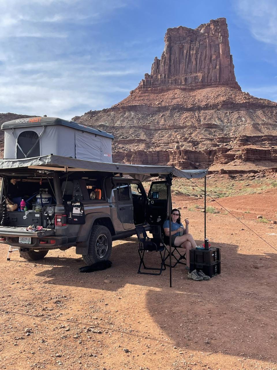

I just installed the AEV dualsport lift on my GTR and could not be happier. Even with the full overlanding set up I felt the regular springs they offer is better suited to my rig. I will be upgrading to 35ā€ E rated tires shortly.
How much weight are you carrying? Fully loaded. Got any pics of fully loaded with AEV suspension?

I just installed the suspension about 2 weeks ago and haven’t had a chance to load up everything but here is a picture of us fully loaded on our trip to Colorado and Utah last year. This is on the WRT.
Jeep Gladiator Analysis Paralysis - Lift Options IMG_4546

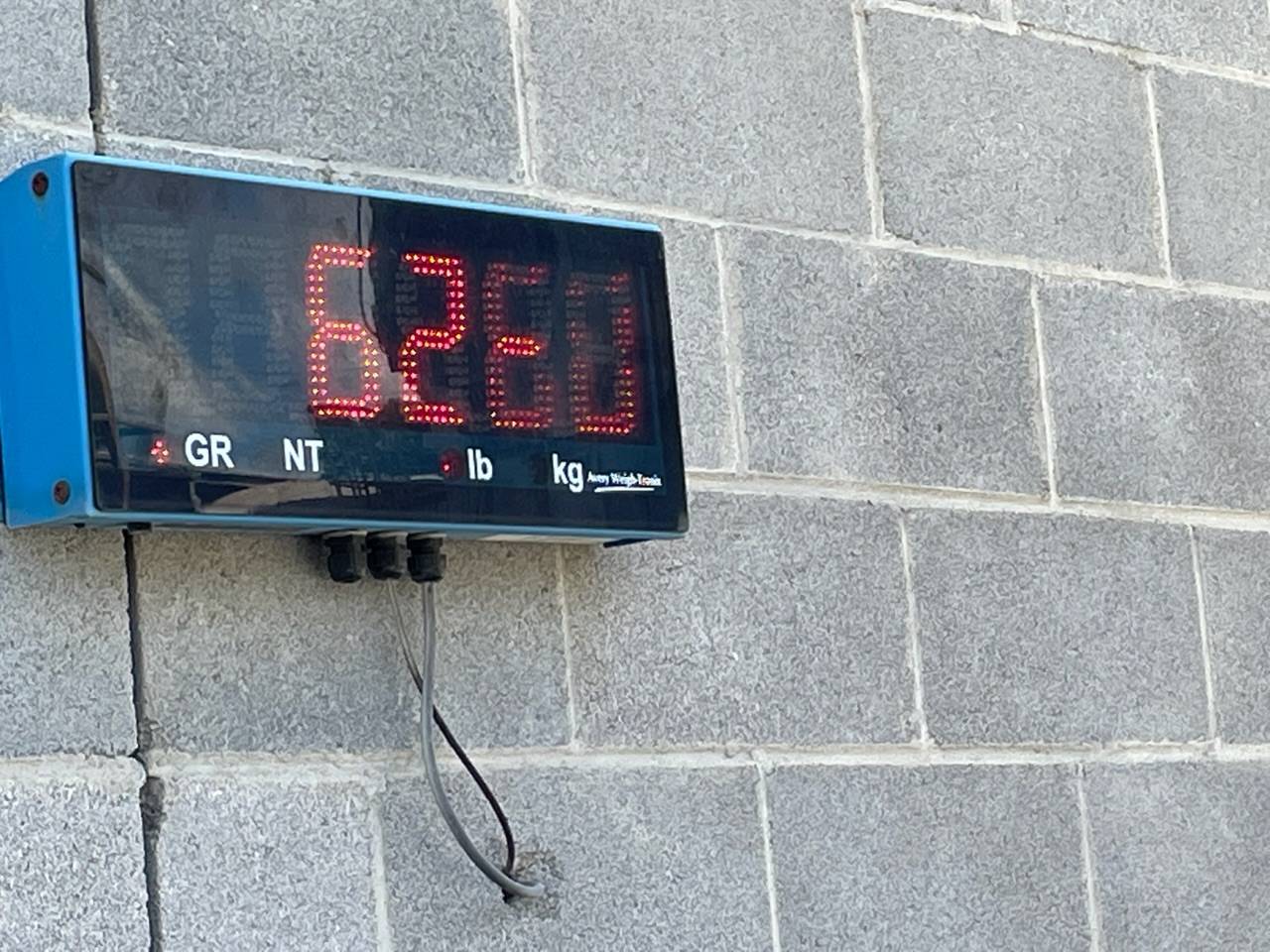

What's your guestimate on weight?

I came in at 6280#ā€˜s with a full tank of gas and no extra fuel in my LRA gas tank and no water.
Jeep Gladiator Analysis Paralysis - Lift Options IMG_4502
