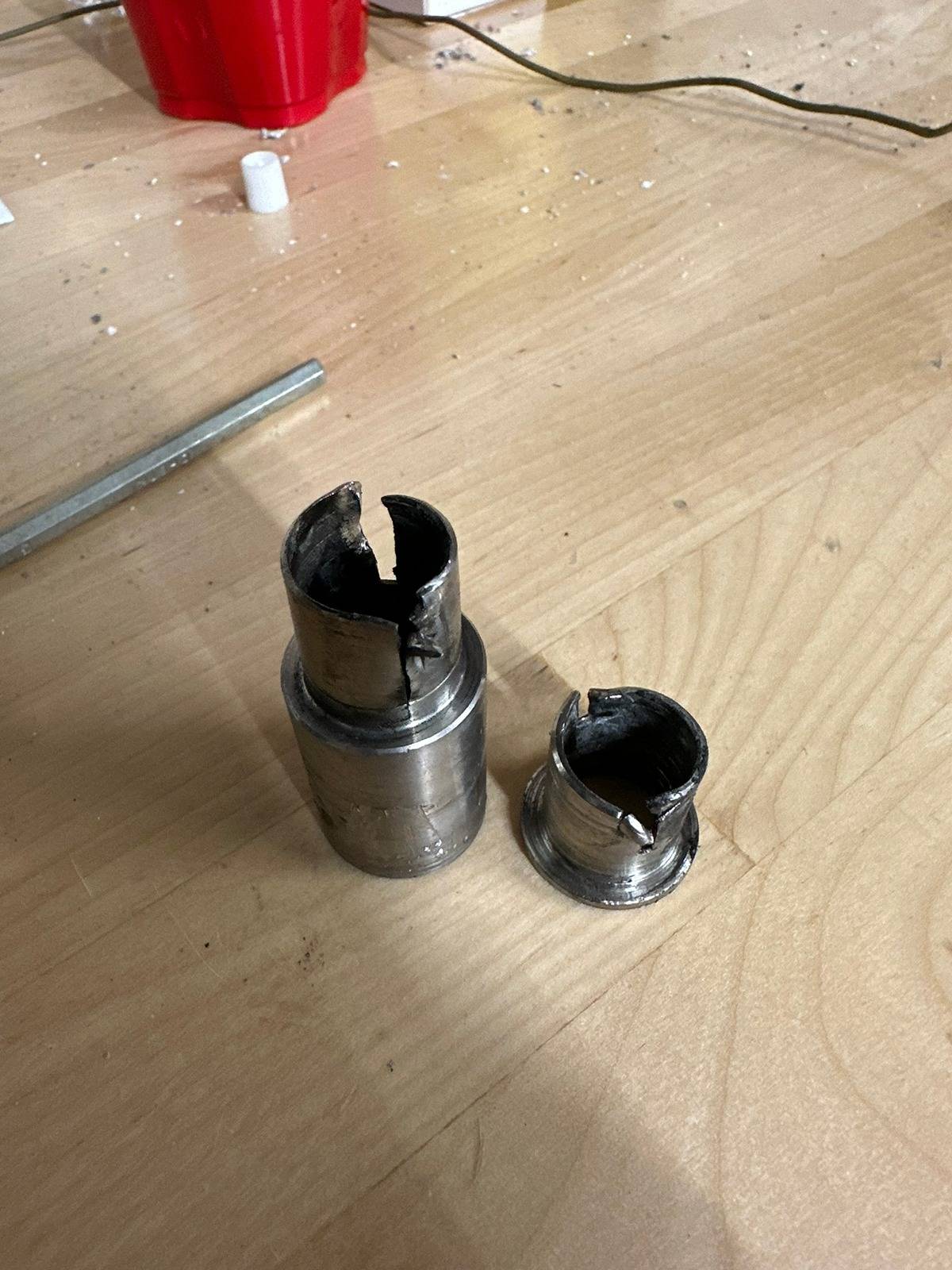

Just wanted to say thank you again to @dayusmc I finished the above mod today and it definitely is the way to go. I had originally drilled out my Fox 2.5 elites to fit my Mojave and when I took my shocks off to do this mod, I couldn't believe what I found. The metal sleeves were destroyed. You can see from the attached pic that the sleeves were so thin that they just collapsed into each other. So glad I did this mod.
I probably should do a thread dedicated to this mod.
Did you have any issues getting the teraflex bushings apart?
A bit of a PITA. I first used a fresh blade in a utility knife to whittle the nylon bushing off, then a wire wheel to remove the remaining bits. Then I used a dremel cutting wheel, and carefully cut the metal sleeve. I did put a very minor "groove" in the metal bushing underneath, but couldn't find a way to avoid it completely. I'm not concerned about it, barely feel it with my fingernail. Thrilled with the end results!
Did your shock towers get smaller cause the bushings spilt and when you torque down shocks the tower got smaller and couldnt fit original sleeve between the tower.
Yes they did. Had to get in there with a crow bar and a block of wood to widen them back up.
