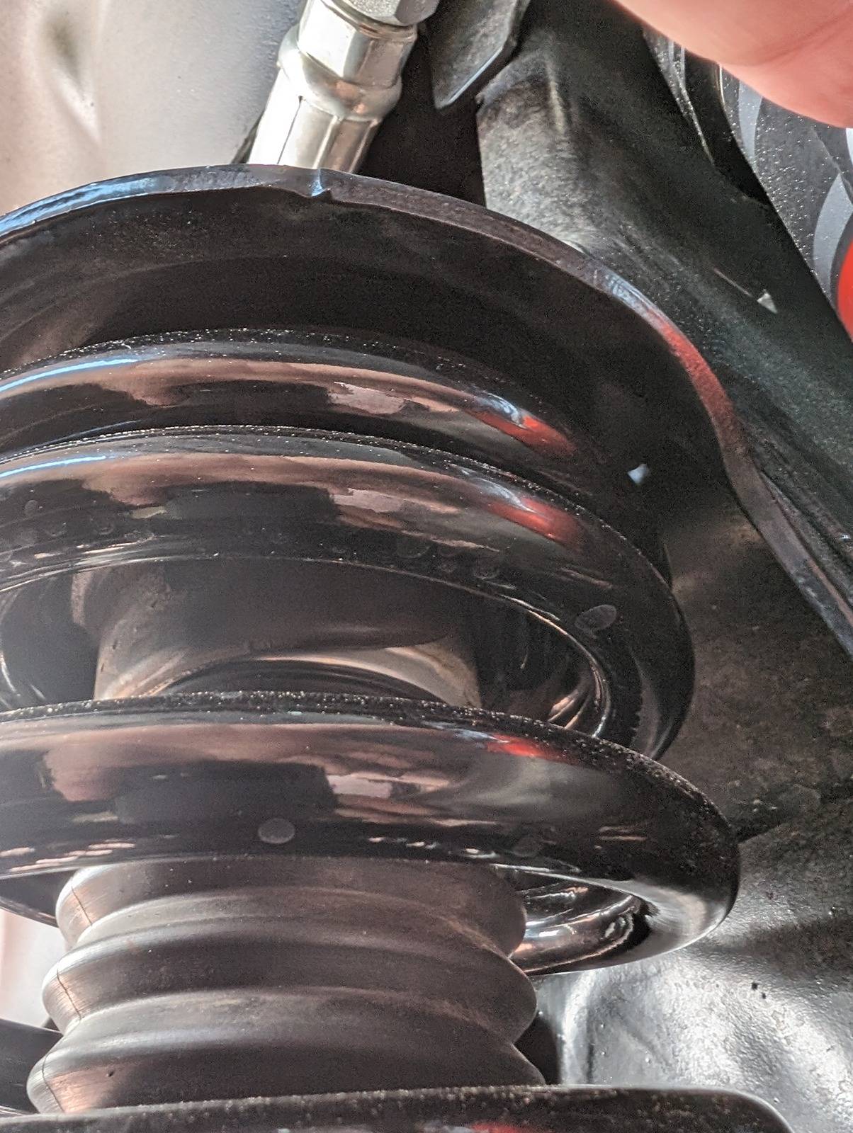

I think the reason the Mojave sits higher in the front than the Rubicon is because the top spring isolator sits on the base of the Hydro bump stop.

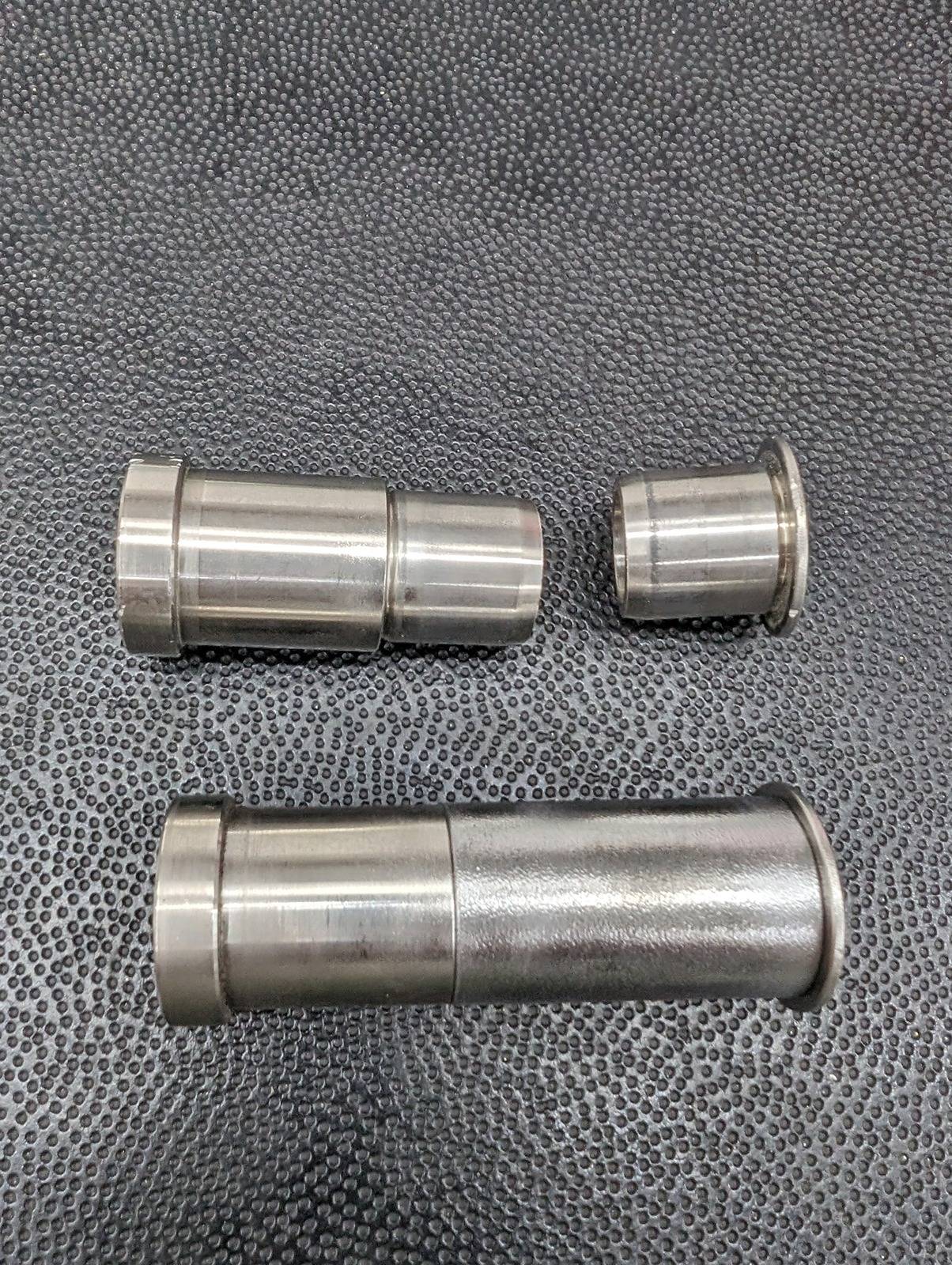

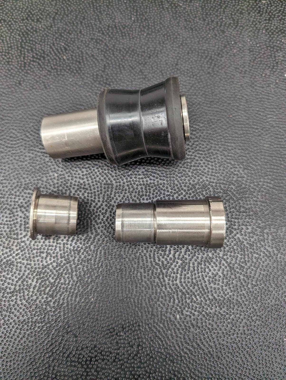

The Poly bushing part number is 014-11-025 (You need 4), you will put them in the front top and bottom of the Fox Elite Shocks to fit the 14mm sleeves.
The bottom 14mm sleeve part number is 213-28-000-B (you need 2).
Then you need the Falcon Mojave bushings. They are pressed into the rubber part. When you cut them apart, you will you the metal sleeves, they fit into the poly bushing 014-11-025... They are a PIA to take apart. The above picture is the Falcon sleeves I took apart next to the stock 12mm sleeves that came in the Fox 2.5" Elite front shocks.

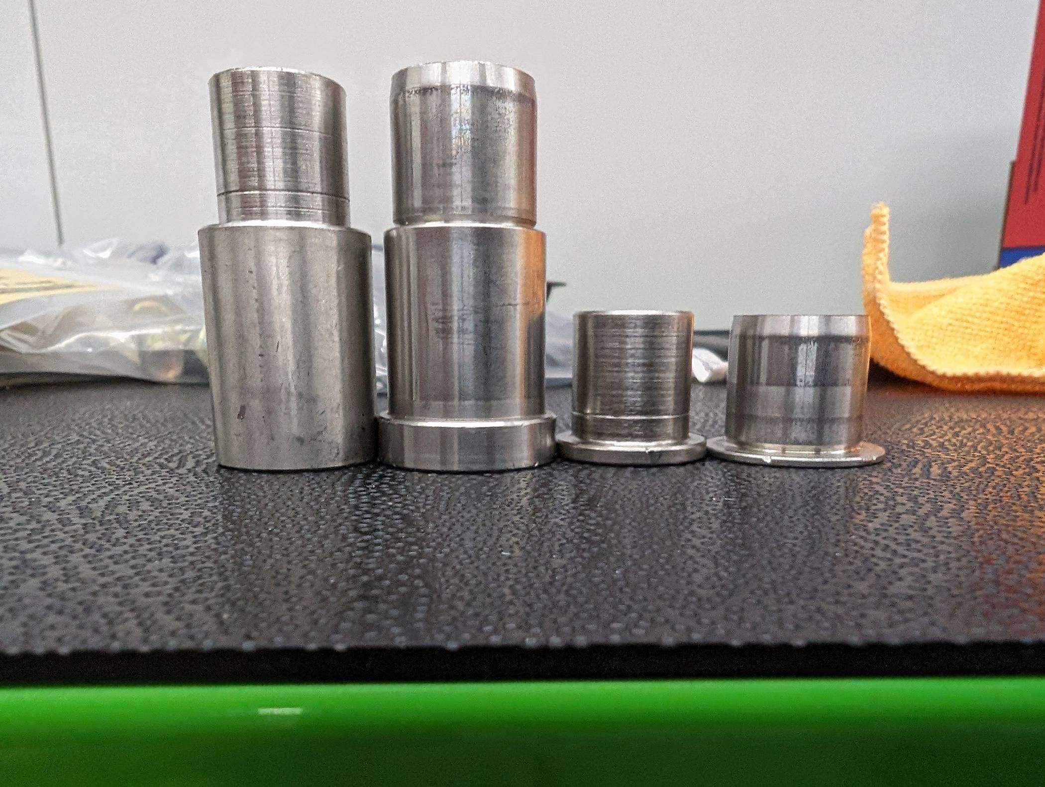

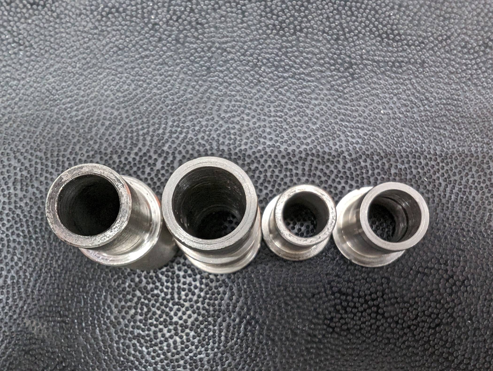

I am definitely happy with it this way. I did not want paper thin bushings. I literally bought $350 worth of Teraflex and Fox bushings to figure this out...

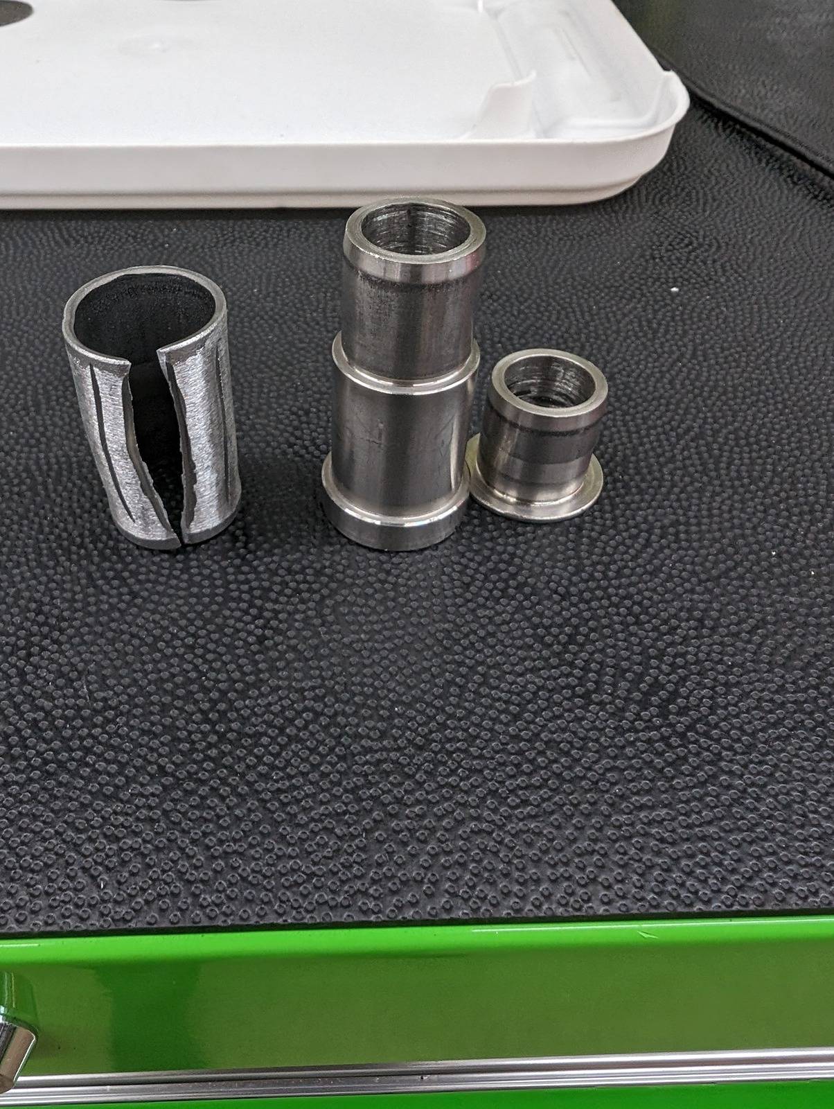

Cut away as much of the rubber as you can. Than use a wire wheel to take the rest off. Once it is all off, cut some little lines in the sleeve holding the two ends together, don't go to deep. Then heat the sleeve and work them apart ..
