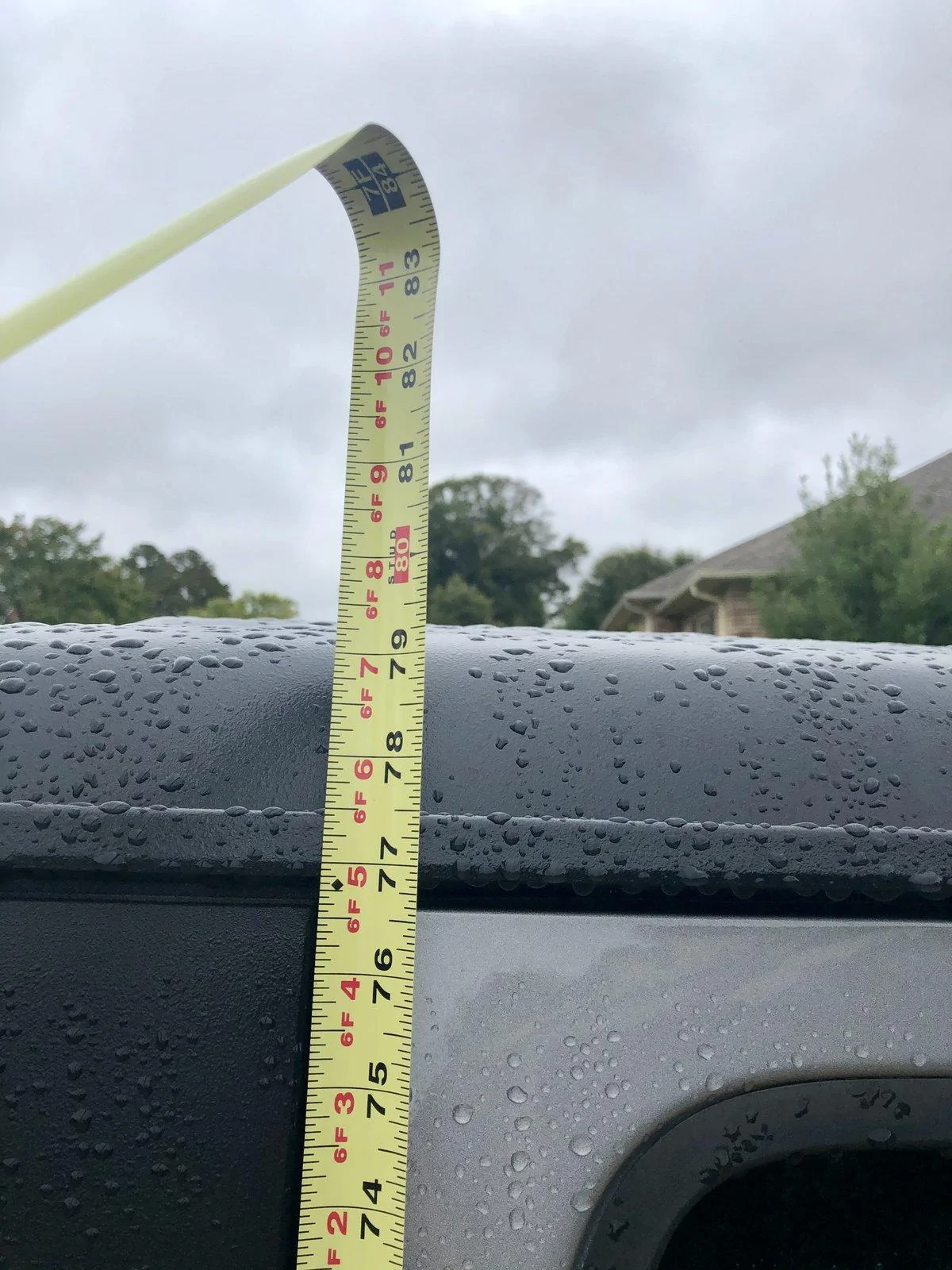

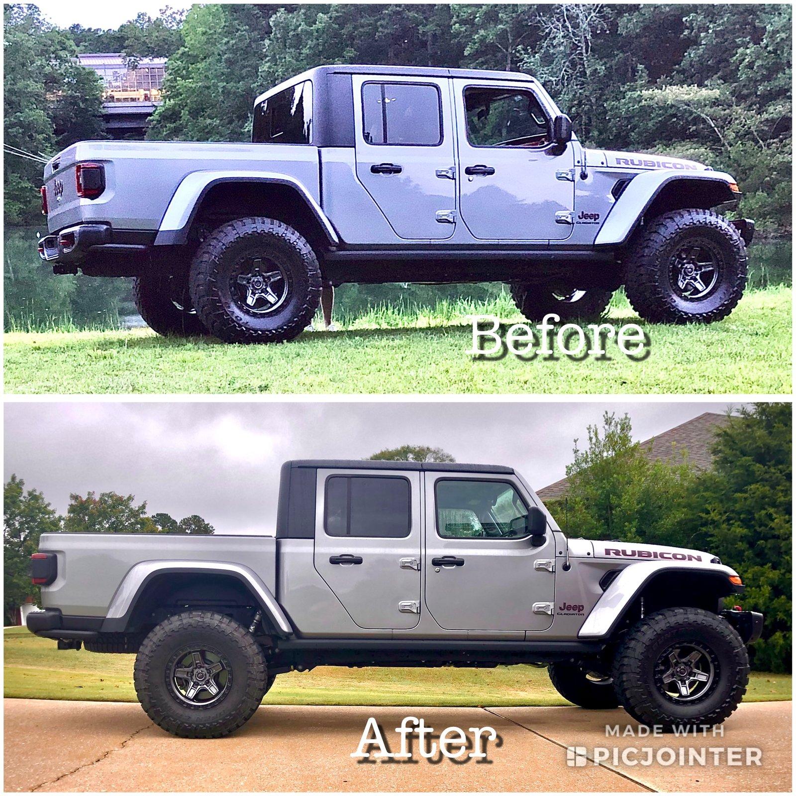

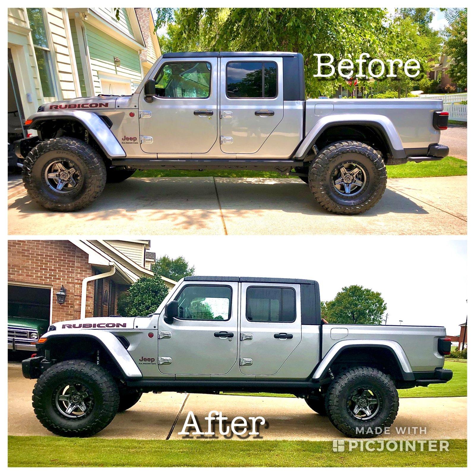

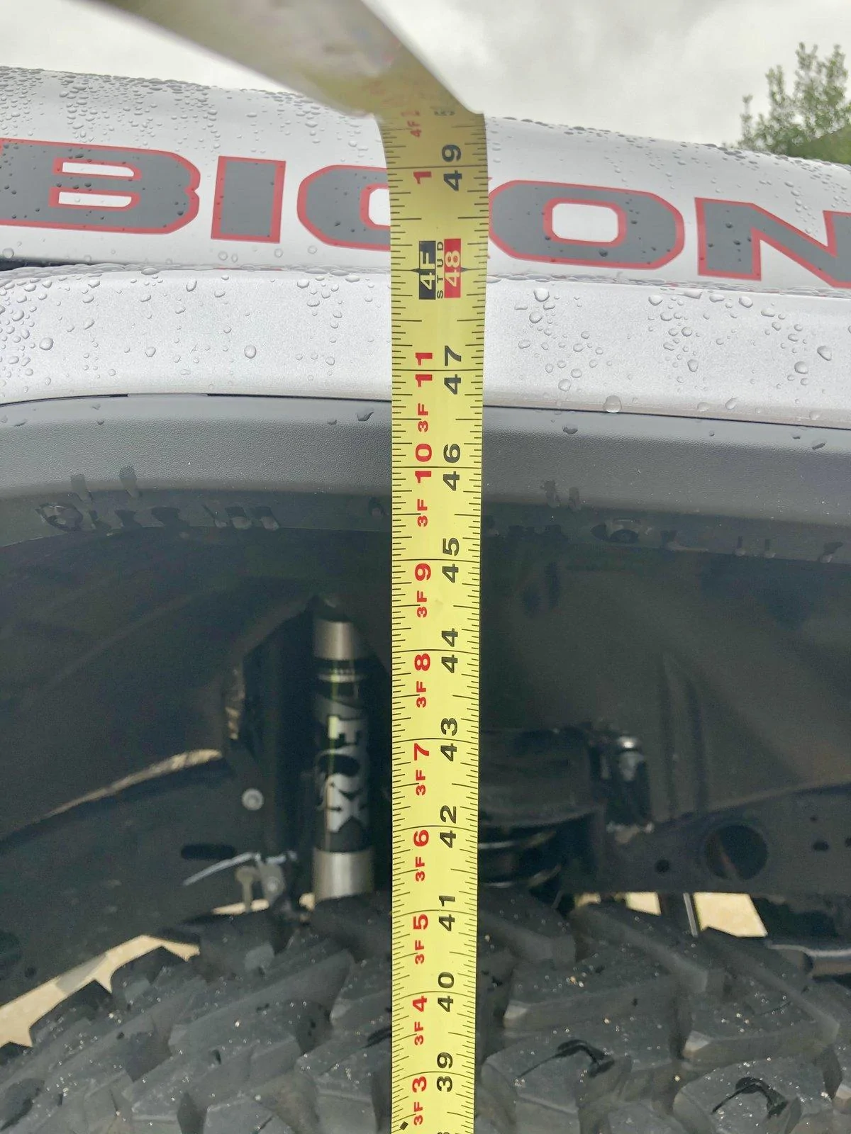

I will try to post off road pics on this thread once my driveshaft is in and I can get out there. For now, I wanted to offer these comments above and also provide before and after shots below for anyone considering this mod or what a JT on 37’s looks like with the mopar vs the clayton kit. See my build thread above for more pics and full specs.
“Before” means with Mopar kit. “After” means with Clayton 3.5 inch Overland Plus.
