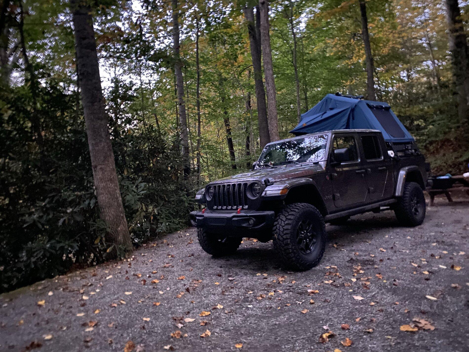

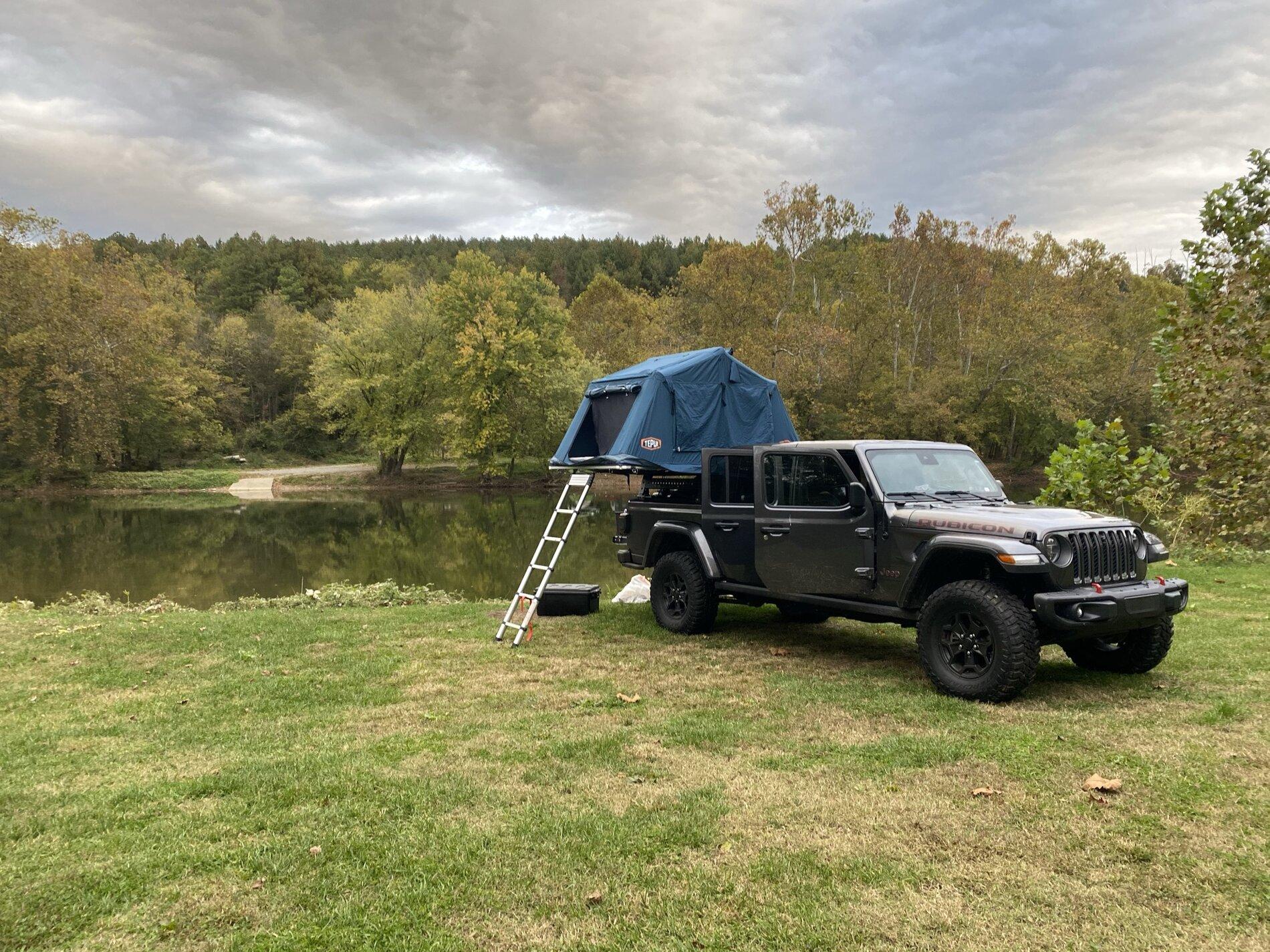

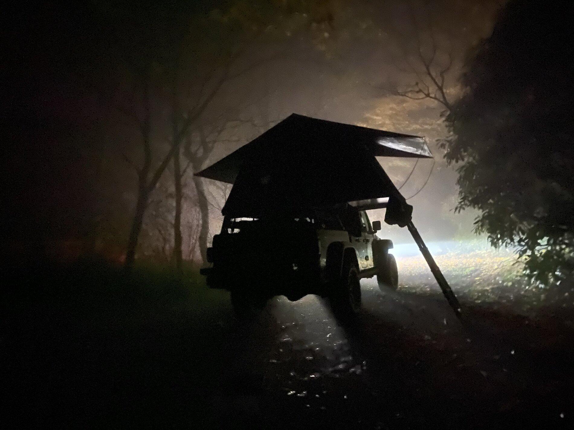

For your viewing pleasure most recent trip to Great Smoky Mountains.
