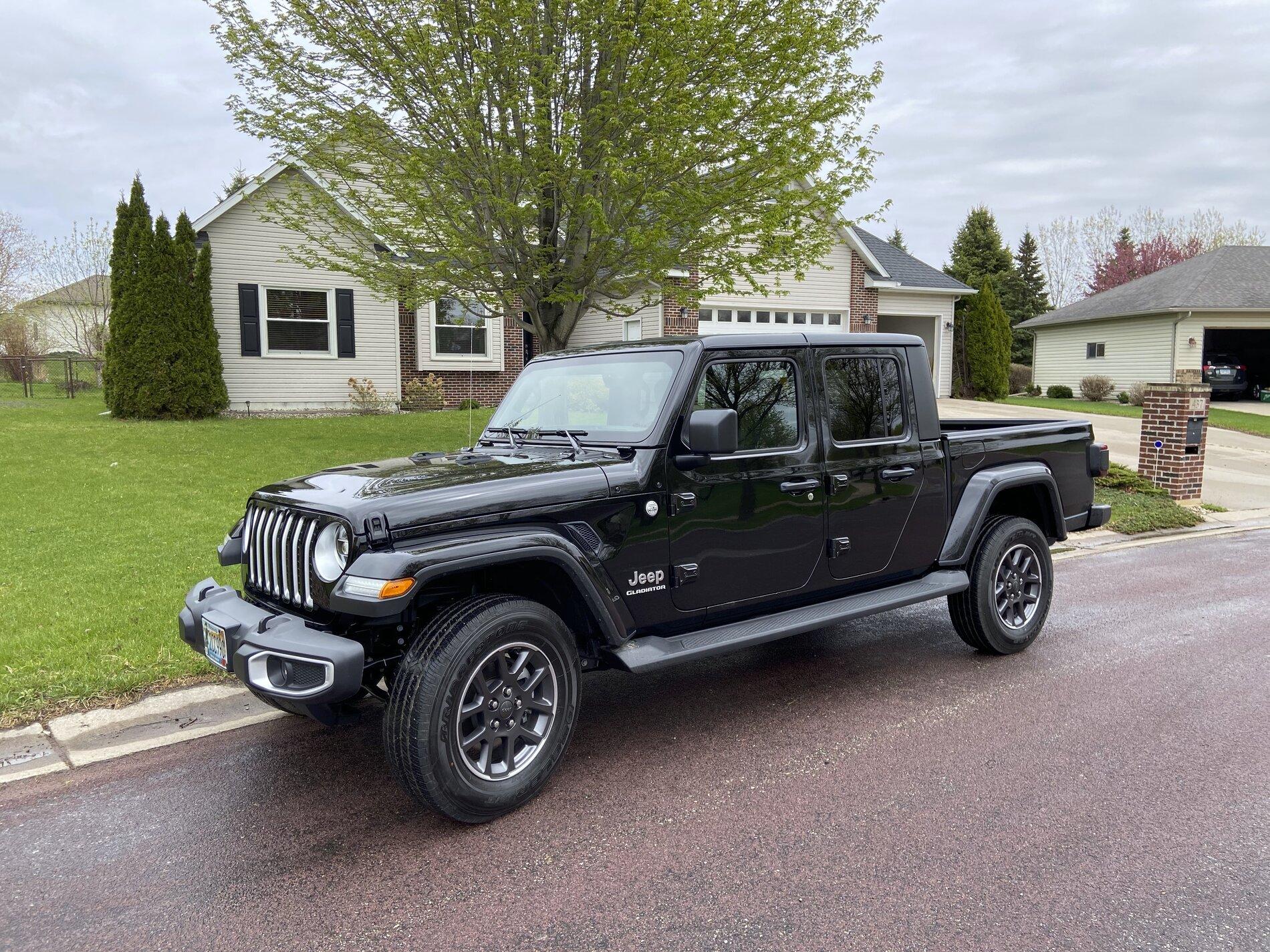

How is the front rake on the 2” Mopar lift? Does it still sit lower than the back?
There is still a little of bit of rake, but not nearly as much as stock. My Overland with the 2" lift shown below before and after. Same tires and wheels.
Before:
Jeep Gladiator Mopar 2" lift kit IMG_3093
With 2" Mopar Lift:
Jeep Gladiator Mopar 2" lift kit IMG_0195
