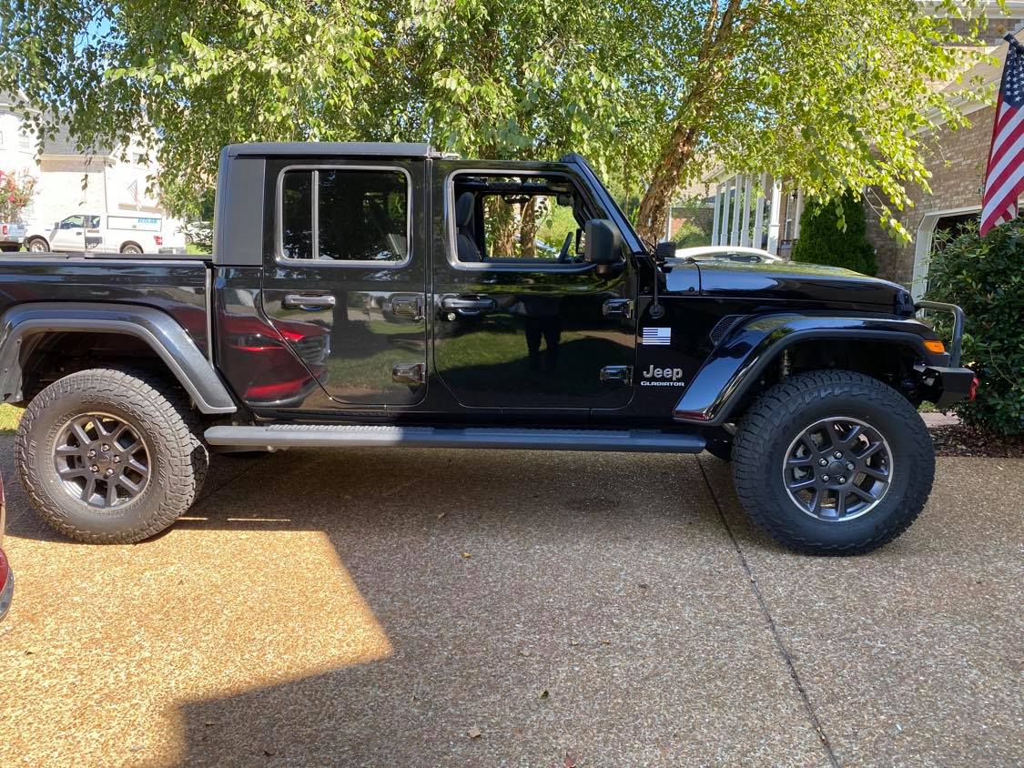

I just finished installing the mopar 2" lift and 2 0.75" daystar spacers. I indexed everything appropriately and followed all of the mopar installation instructions to the T. The only thing I didn't have instructions for were the daystar spacers, which I placed at the top of the springs under the upper isolator (so spring, spacer and then indexed isolator). It's drooping like and inch on the passenger side. Any general ideas on what the culprit could be?
I reused the stock lower isolators because I bought the mopar kit and the daystar spacers used from another JT owner who had it for about a year.
Thanks for the help!

Not sure how helpful this is but there was a left and right spring when I installed the mopar lift on my wives JLU. I think 1 was slightly longer due to the gas tank weight.

Yup, that looks like it's the culprit based on some research. The springs don't have the p/n on them and I just assumed they were the same.

My question, does the .750 spacer make it level? no more rake?? thanks

Yup, a winch and a steel bumper
