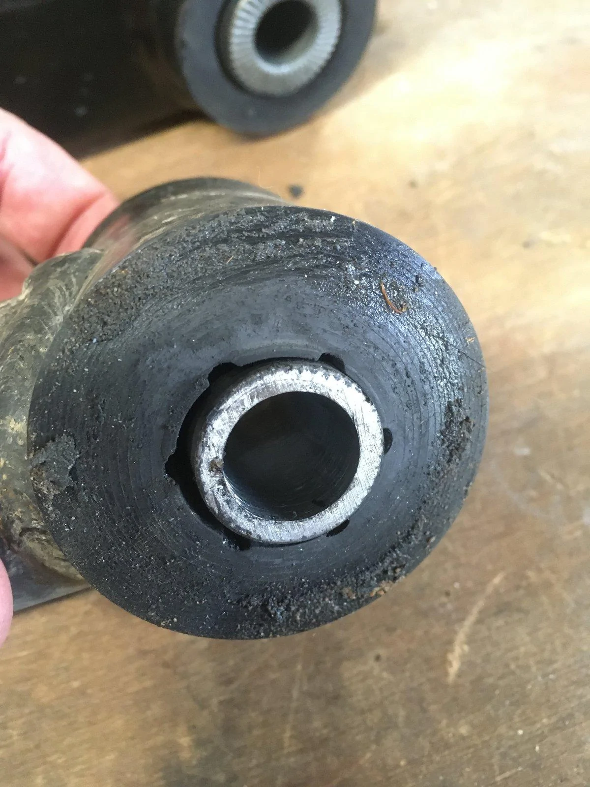

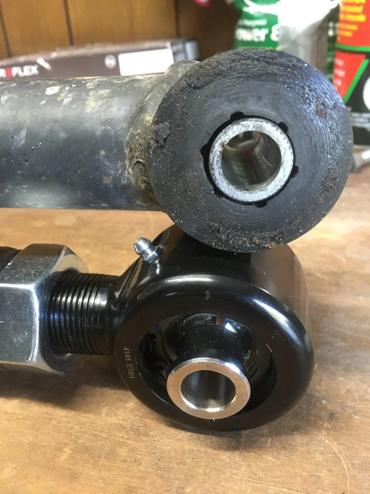

Anyone who has installed this lift, or is planning to, needs to be aware that polyurethane bushings don’t last a long time. I am not upset with what this kit is for the money, as I planned to replace everything over time. Here are my control arm bushings with only 5,000 miles on them. I had not experienced any handling issues (yet). Fortunately a friend hooked me up with an upgrade at a great price!

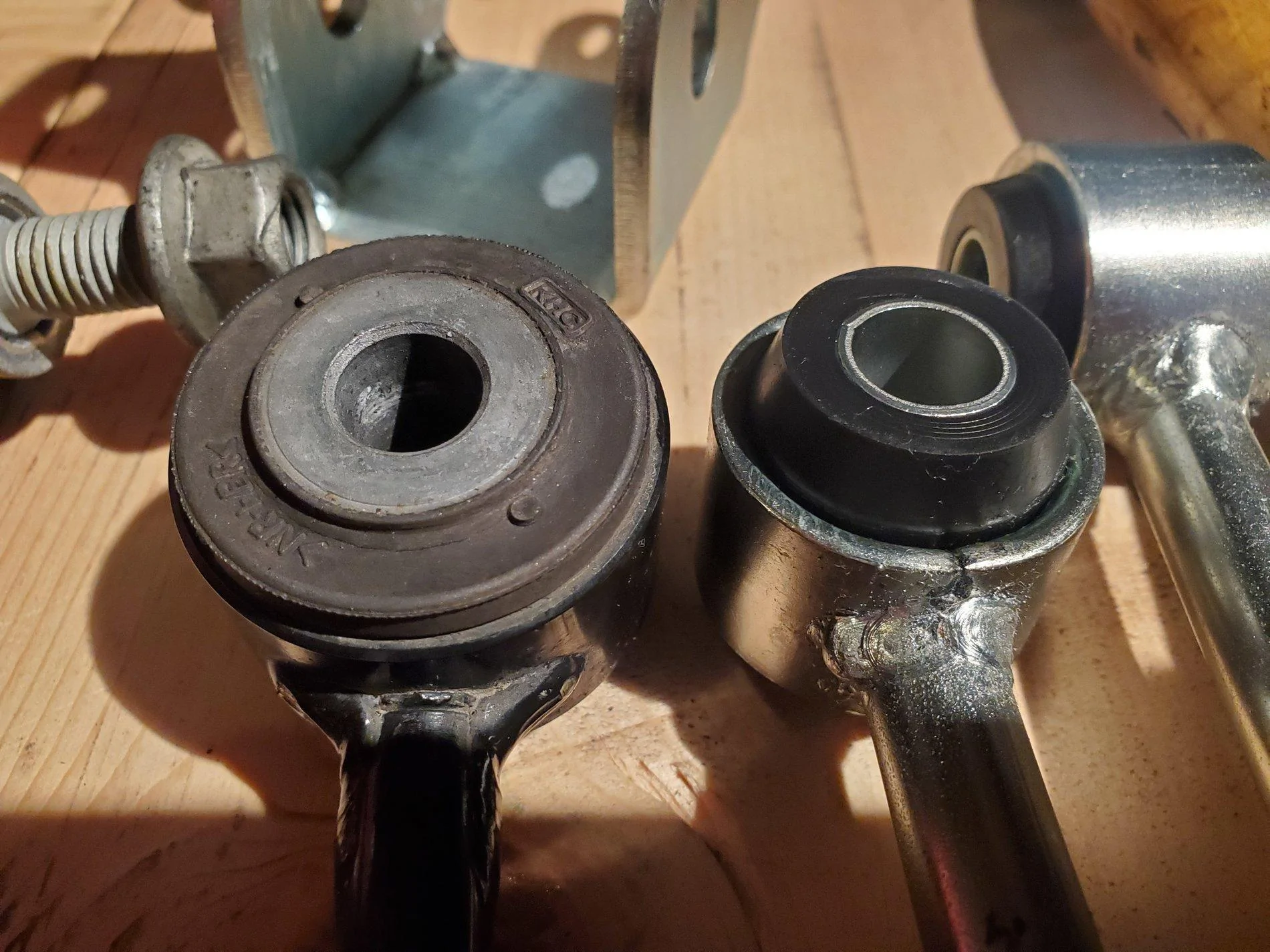

Just installed the Daystar 2 inch lift in my Gladiator this weekend. I got it because I also just wanted something to tie me over until more lift kit options become available, to clear 37s (especially with my heavy warn winch upfront) and get some life out of the factory Rubicon Fox shocks.
Really unimpressed with the quality of the product though. Attached is a picture of the factory swaybar end link on the left, which looks beefy compared to the tiny weak daystar sleeves/bushings. They will definitely wear out and fail quickly. This kit screams mall krawl, I will not trust it to take me down a challenging trail. The instructions said to torque to factory spec, (60 ft.lbs. which they didn't provide) but at 40 ft. lbs. they squished and deformed... anything more than 35 lb.ft and they will blow. Pathetic. Now my suspension is weaker than stock, neat.
Also the instructions clearly state that all you need is a jack, stands, and a metric socket set. Yet the first step is to press the shitty plastic bushings into the components... so you need a press too, and it's a messy pain in the ass to do. They also didn't provide even close to enough grease. Kind of a joke.
I also experienced the control arm bushings were too tight for the factory bolts to go through. Luckily I had a really big drill bit and reamed them out a bit, which helped... but I still had to hammer the control arm bolts through with enough force that I doubt I'll be able to use them again. Threads will be all dull for sure.
I disliked the kit enough that I am not installing the rear. It's 3/4 inch higher in the front end for my truck. I am now on the hunt for 7.25" swaybar end links to replace the garbage Daystar ones. But I may just save up for a real lift kit. I would be shocked if these end links survive a year on my truck. Don't waste your money folks!

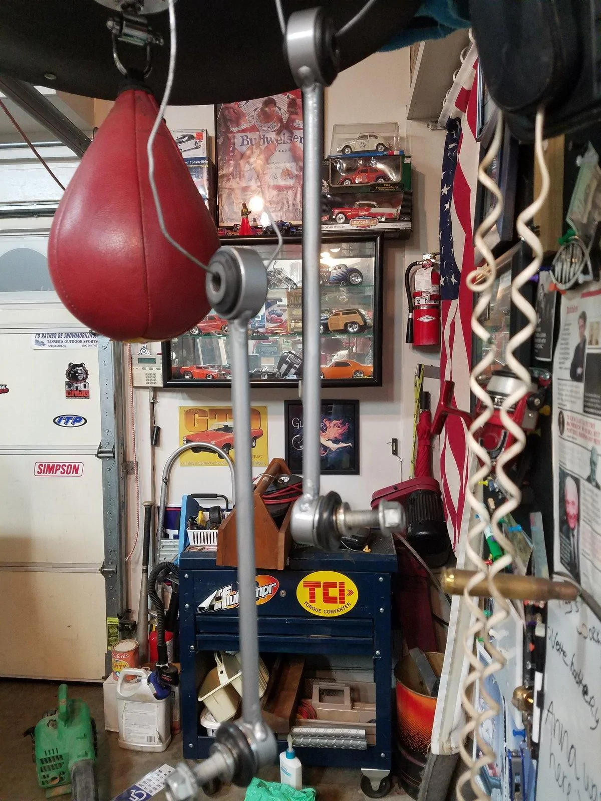

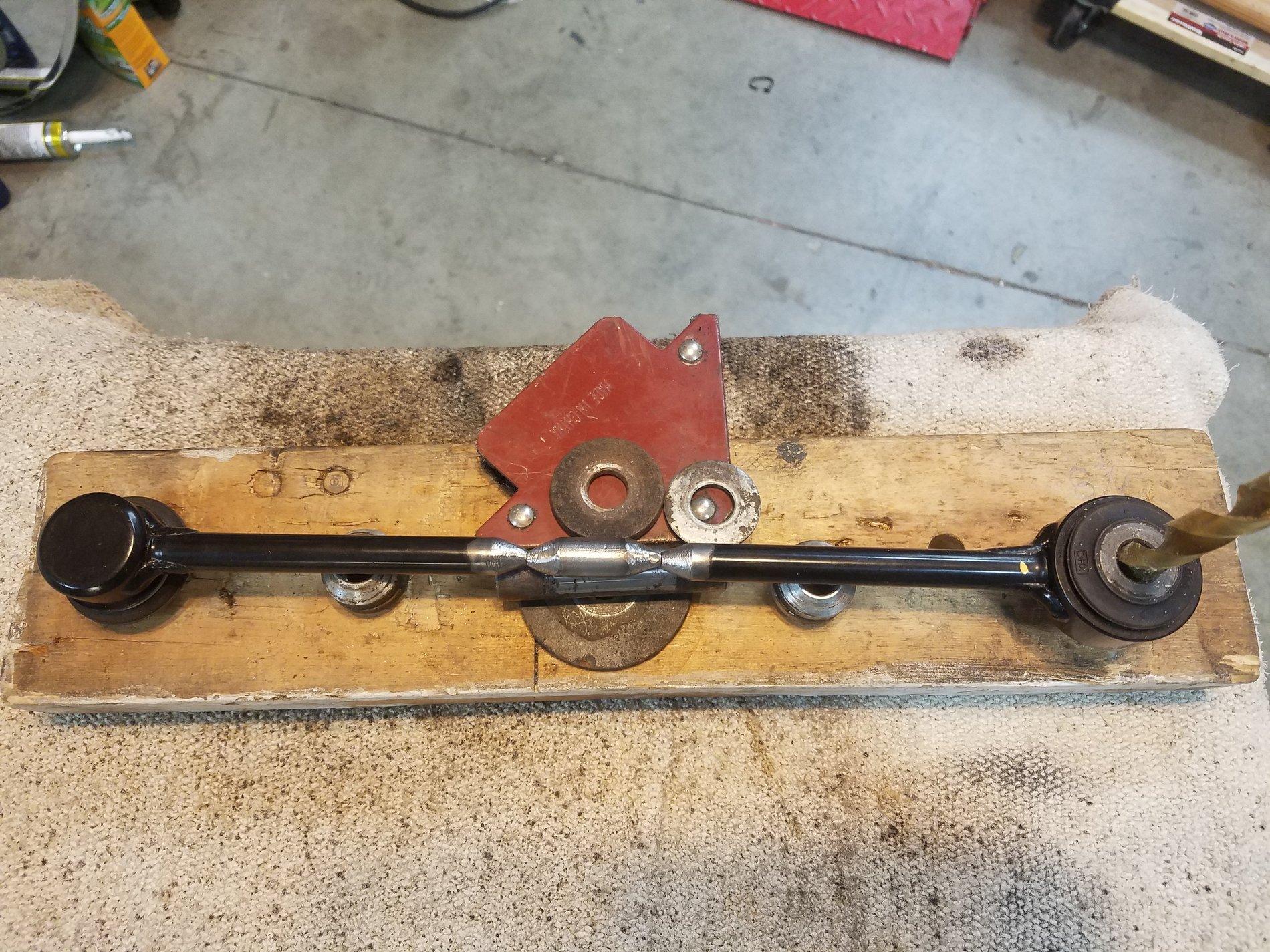

Rayzzz
Ray
Sep 8, 2019
162
149
Bethlehem NC
2020 Jeep Gladiator
I decided to throw out the Datstar rear sway bar links an weld in 1-5/8 extensions in the stock sway bar links. I'm working on welding up some disconnects out of the stock front now.
