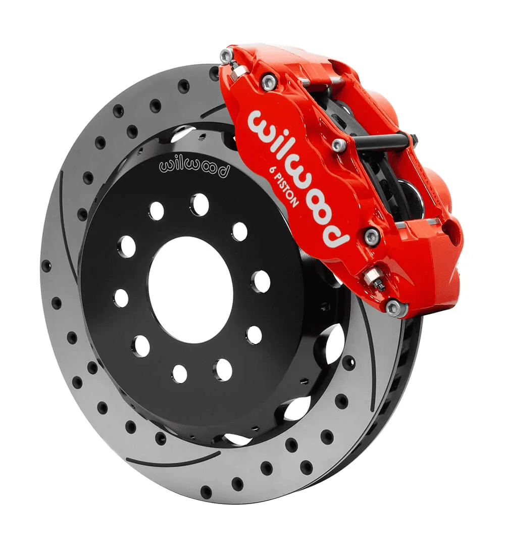

One last thing. If you put a Rubicon on mudders with $3000 of Wilwood brakes up against a stock High Altitude, the High Altitude would smoke the Rubicon in any braking test because of the superior traction its low profile tires provided, right up until the stock brakes started to fade. By the way. There's nothing dumber than a rock crawler with upgraded brakes.
They are sexy as hell though. Aren't they.
