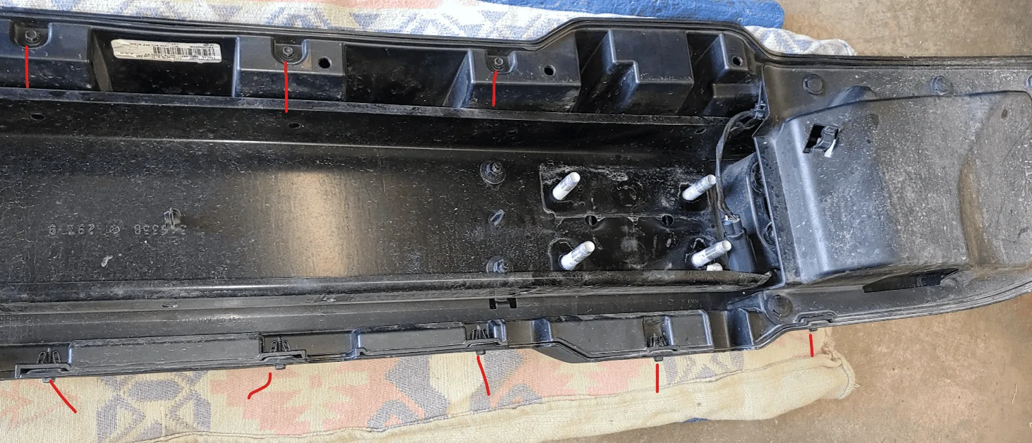

You will either need to buy a new fog light harness for the new bumper, or take your original bumper apart (about 349 screws or so LOL) and harvest the wiring harness from the INSIDE of your plastic bumper. It come apart easily enough - just takes all morning.
Next time, I'm buying the harness instead of taking it out of the plastic bumper.
Here's just a sampling of a few of the screws that have to come out to get that harness out.......
Like an easter egg hunt, there's a lot more than shown here, some not easy to see.

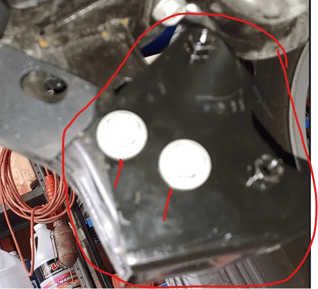

yeah I saw that after I replied. I must’ve glazed over the link the first time reading through. Those look like jk brackets through. The bumper looks like it’s got everything. He gave me a bag of bolts and clips that came out of one of the end caps. I went and found an old thread about the lights and it had some guys saying they were able to just swap things over and others couldn’t and it seems like there are a couple different lights out there. I’ll have to go check to see how mine mounts if it’s the two or three or four bolt option.

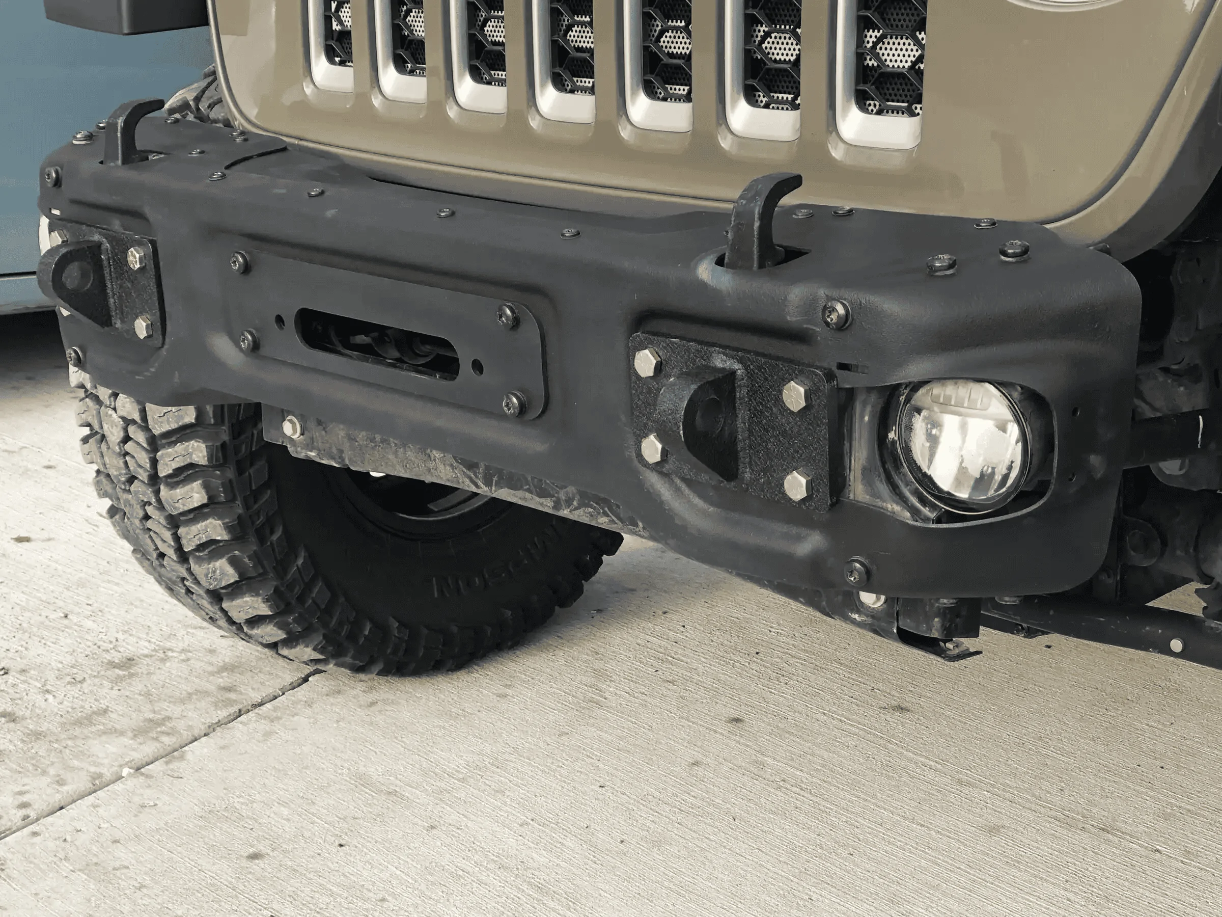

Stock O'Land bumper should be the 4 bolt option.
You can make the steel bumper custom to a point as well... Just a little paint, removal of some pressed in bolts, and adding shackle plates in place of crush cans made it different.

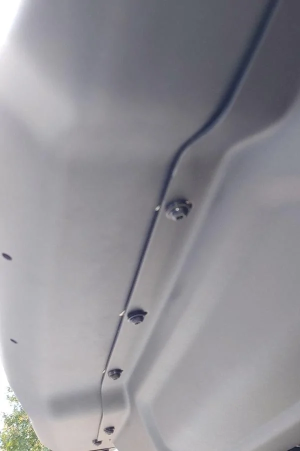

Did you get the brackets /bolts to mount the skid plate?
Good point - there's bolts and the special nuts to hold those lower/rear skid plate brackets. The proper skid plate then bolts to the bottom of the steel bumper so the front brackets aren't needed for the skid plate.
