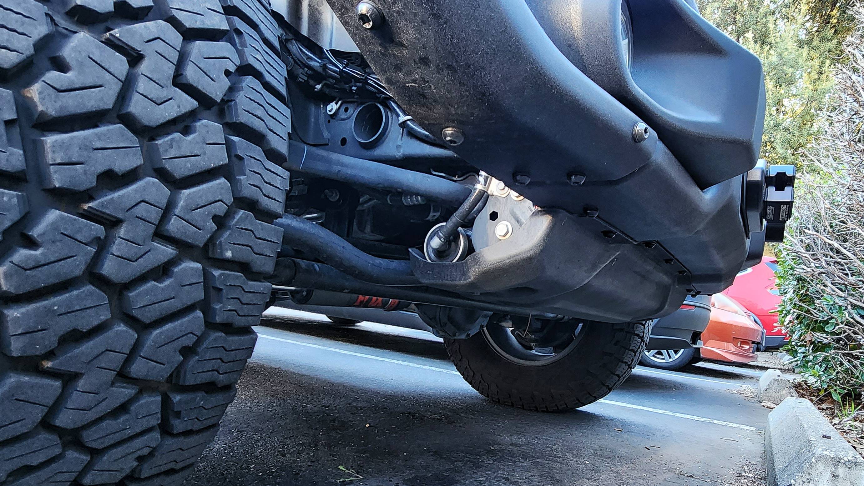

Ahhh... that looks like the black Rubi skid plate! That explains why it bolts up with no issues and no cutting.
Some of us want to keep the distinctive Mojave skid plate which is actually silver. In which case, we either have to trim the skidplate or the bumper.
I'm actually having my Chinese knock-off Line-X'ed to preempt any of the rusting issues. I'm now thinking I'll just get the Rubicon skid plat and have that Line-X'ed in Silver pigment. Hmmmm...

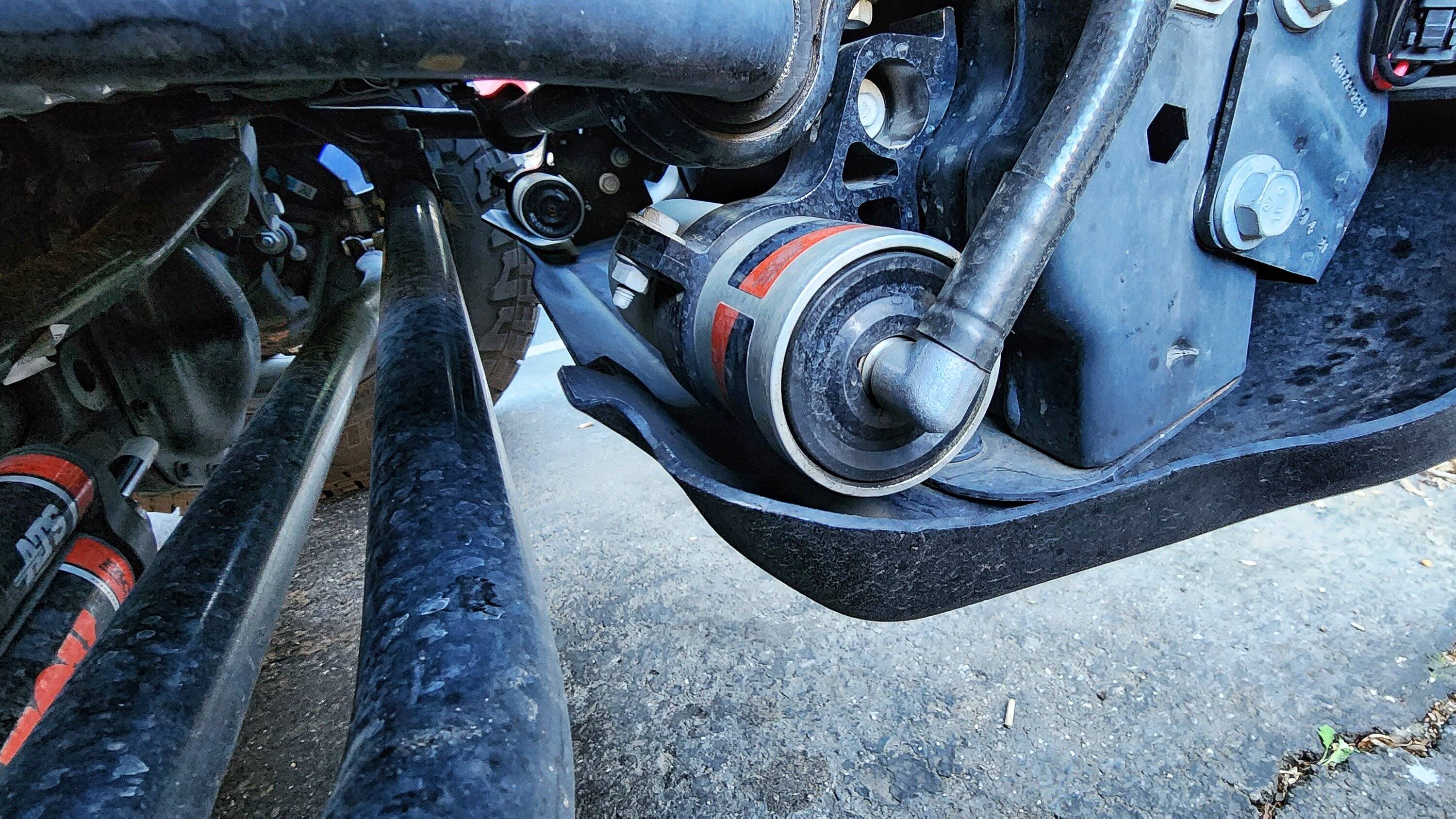

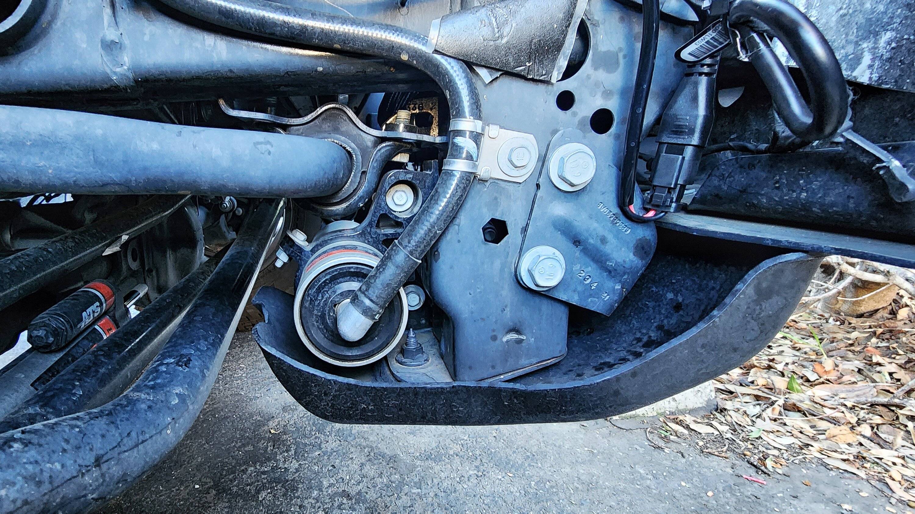

You are correct, I mentioned it was the Rubicon skidplate and someone asked for a photo of it clearing the reservoirs.
Different flavors for different folks! I actually didn't like the look of the silver for the Mojave skidplate, if I had bolted that up I would have painted it black anyways so win/win for my particular tastes.

I think hacking up the Mojave skip plate is pointless if you want the silver get the correct Rubicon skid plate and have it painted silver
Yeah, that's what I'm leaning towards now... esp, since my Line-X place they'd do it in silver for free when they do the bumper.

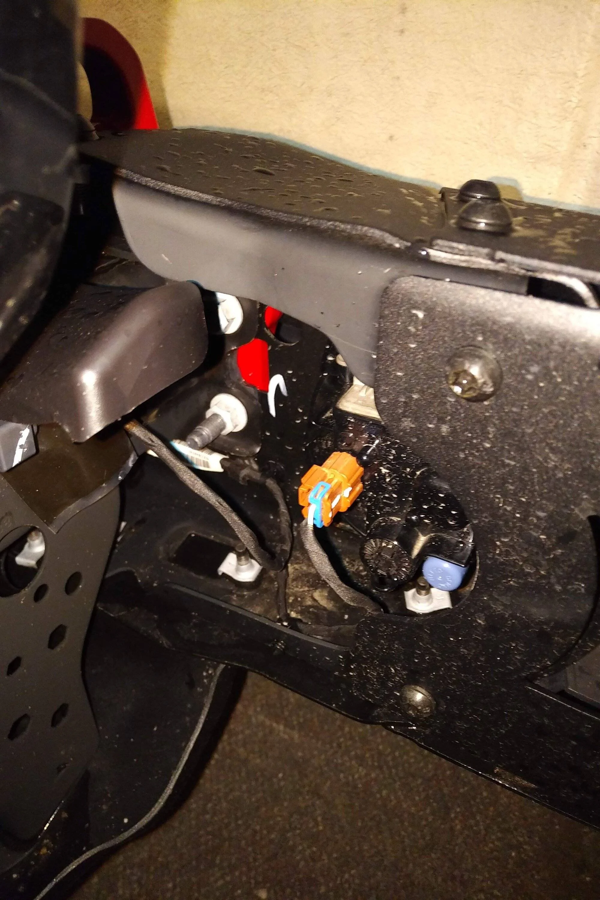

Great thread, thanks for all that have shared info. My Rubicon came with the Mopar steel bumper but I noticed the wiring and back of the led fogs seem really exposed to debris spun off by the tires. Other threads have suggested getting back plates off a plastic bumper. Anyone on this wonderful thread have other good options ?
p.s. thanks to those who referenced the maximus hoops, on the shopping list now.
Somebody on the forum makes those closeout plates and sells them on this thread in member's marketplace: Steel Bumper Close Out Panels
Thanks, I saw on another tread these may only work if you go stubby on the front bumper. I'm keeping my ends on but maybe they will still work, will look closer at the plate bolt pattern.

honestly for something like that isn't very visible, you could probably make a cardboard template and grab something like acrylic or rubber sheet and a cheap hand coping saw from homedepot of lowes and make whatever you need ... not saying it wouldn't take some time, but we are all about spending time on Jeep projects right?
