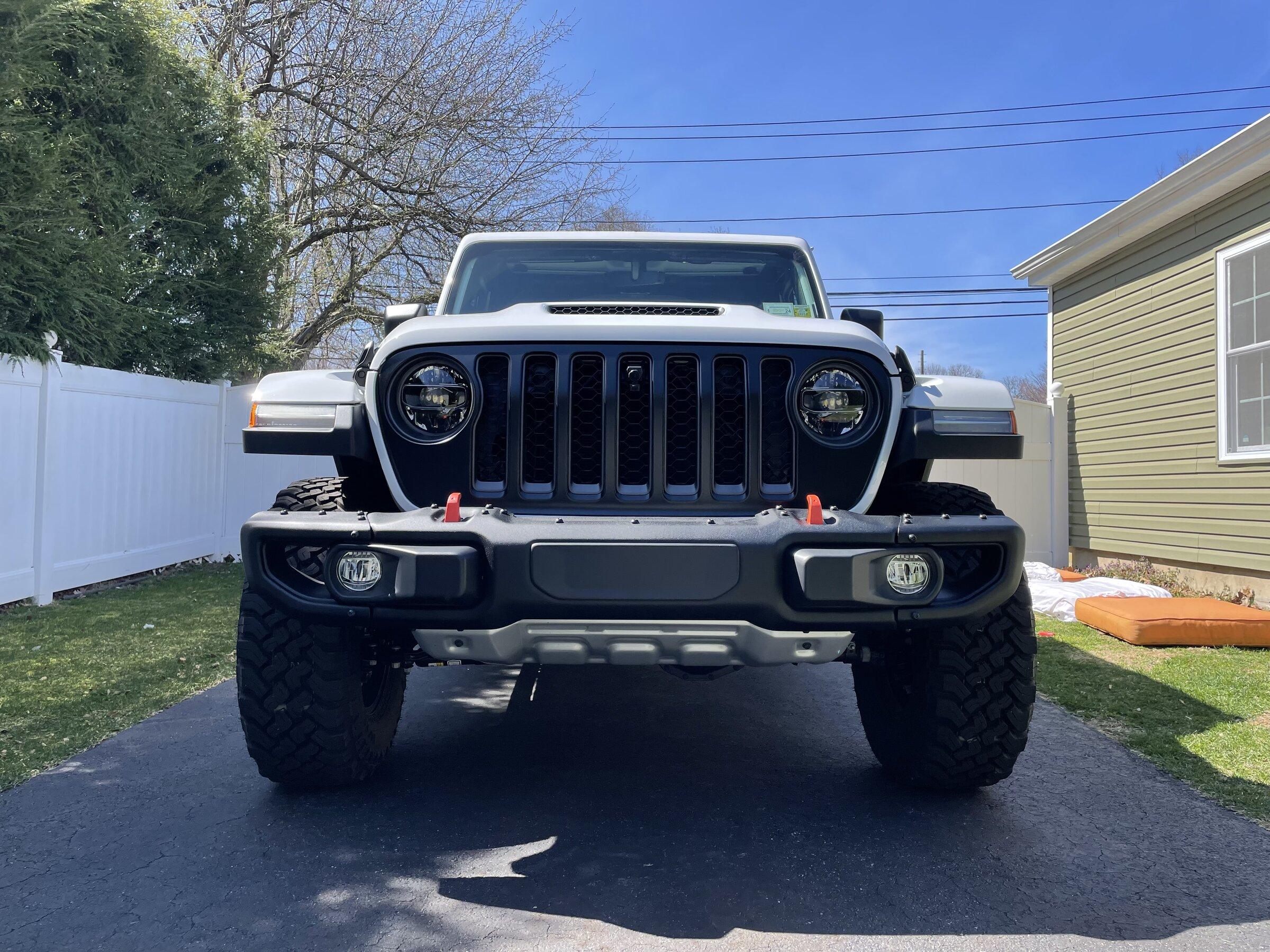

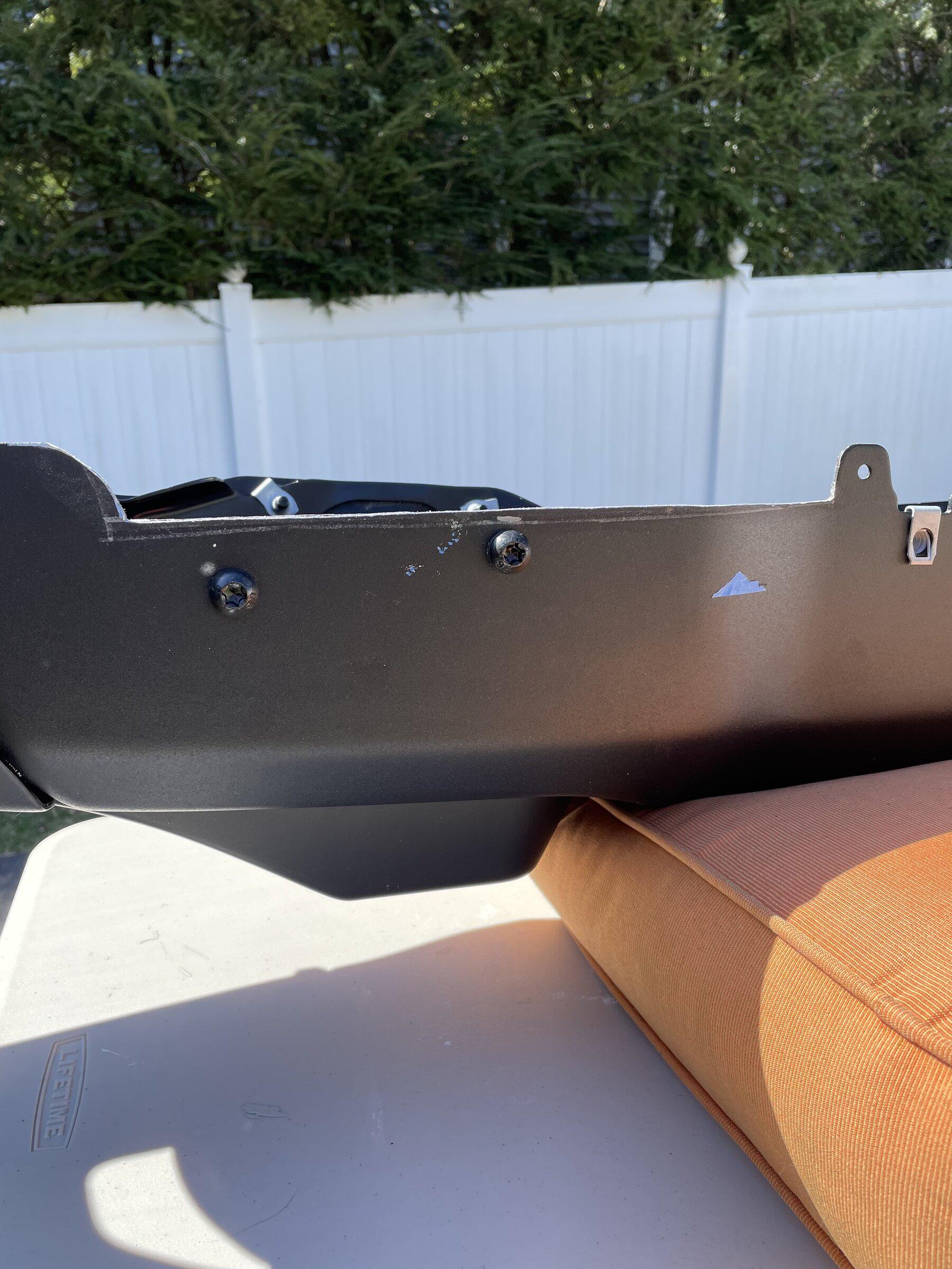

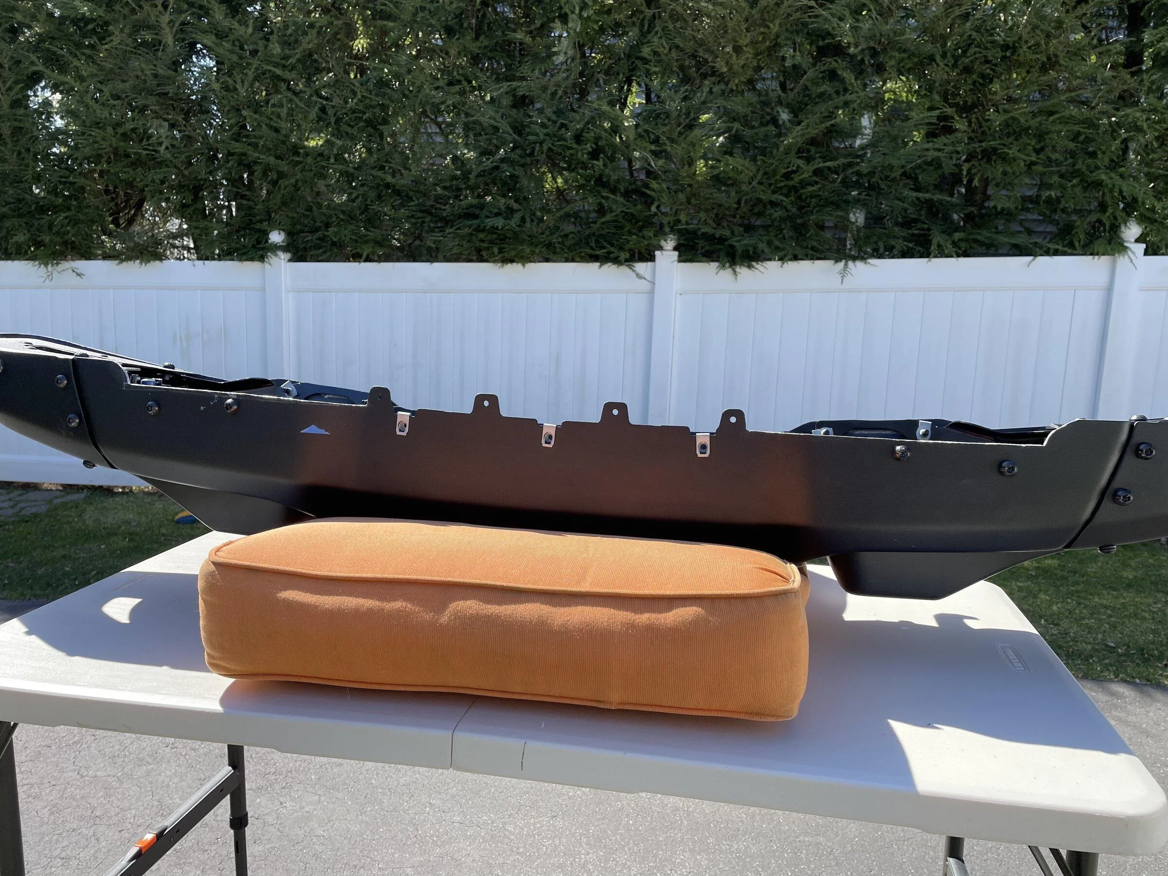

I did the bumper trim method, with plenty of help by @Killroy Was Here
Turned out fantastic. The only way to do it imo. Here are some pics:
Any sag?

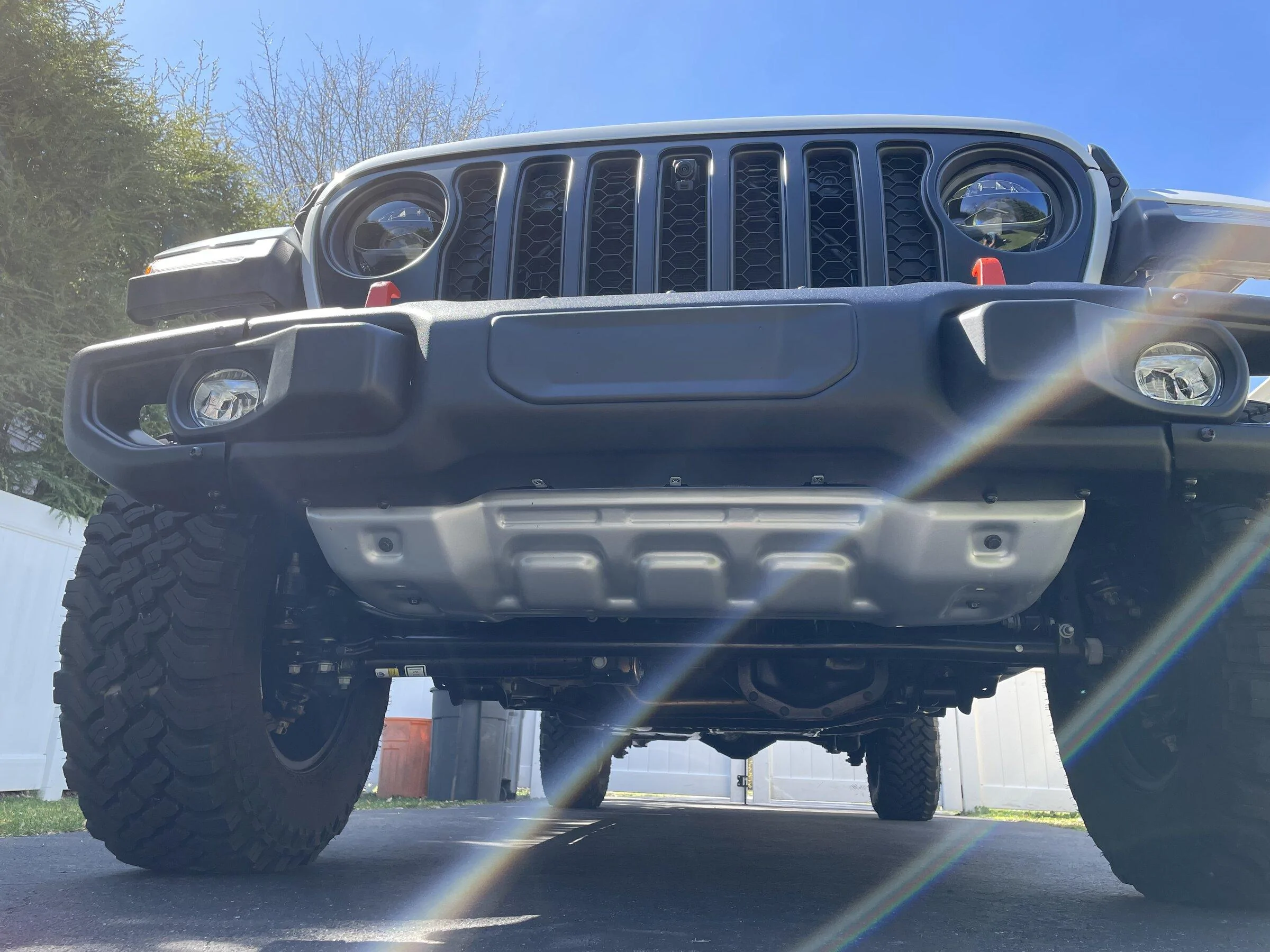

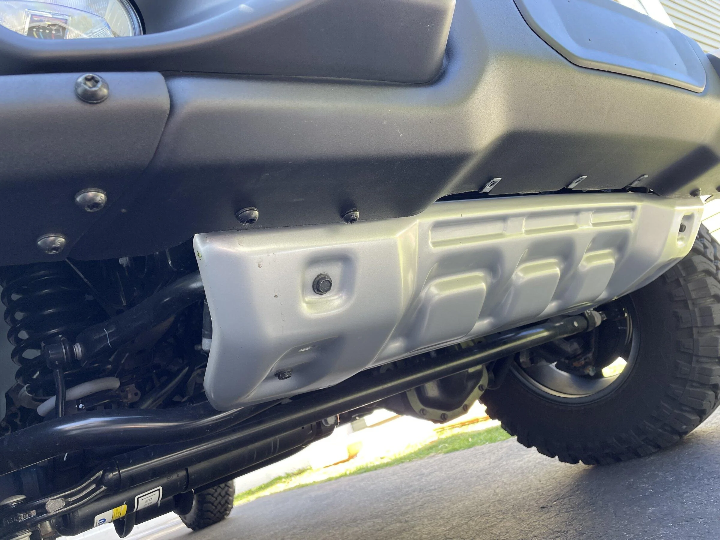

I just bought rubicon skid plate and fit right in, no bracket needed, also just use them bolt from bumper if you dont have an extra one
Did you have to move the Shock reservoir? I thought on the Mojave's the reservoir was mounted on the skidplate?
