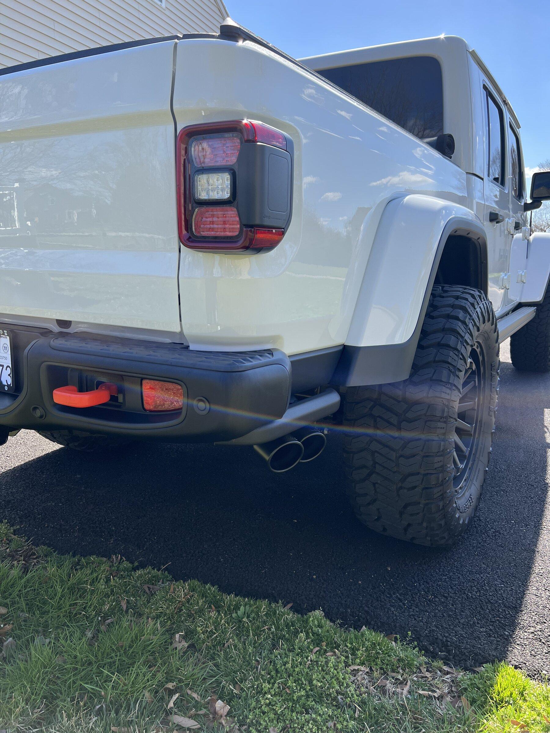

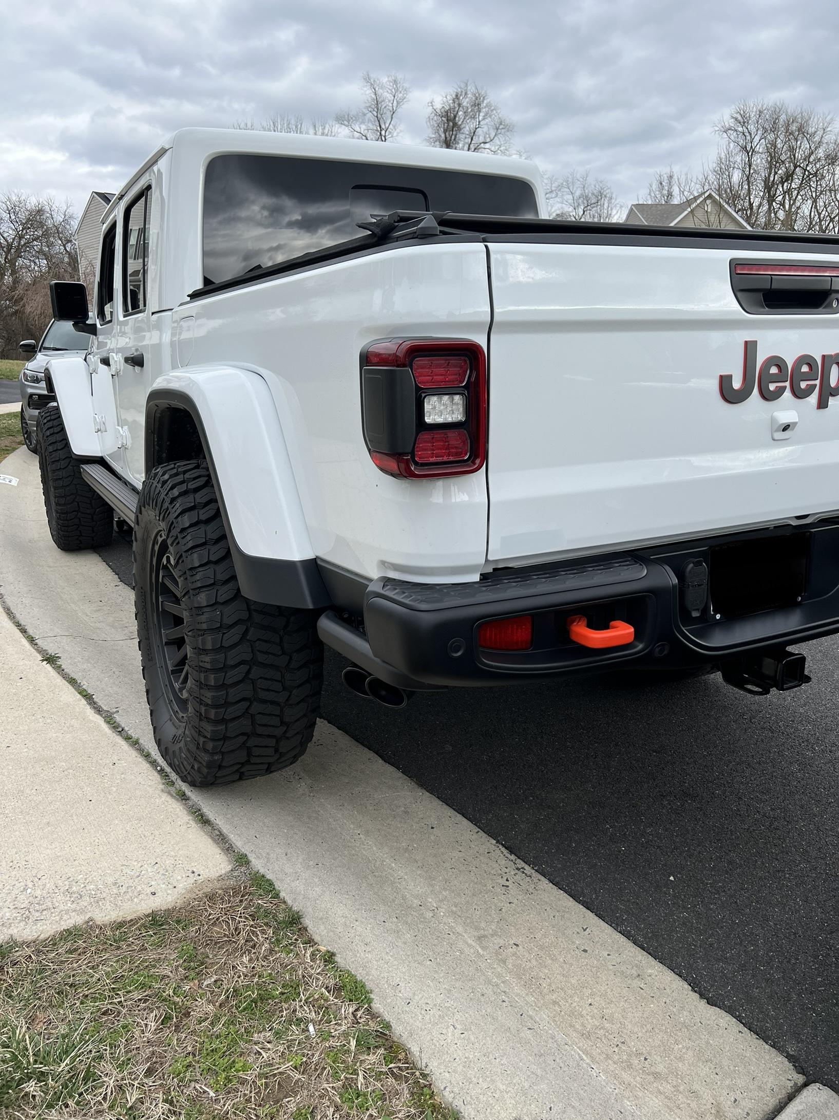

I added the rubi steel rear bumper as well with sliders. I bought them from a guy who took it off his rubi all for $400. Well worth the look on the Mojave! I also added the steel bumper a few months back. Bought the eBay version and so far the quality and color match was just as good as factory.
Jeep Gladiator Rubicon steel rear bumper swap 78CAD1D1-66AB-4E91-8D9A-372931DA8EBA
Jeep Gladiator Rubicon steel rear bumper swap BF1341B1-6874-4A2D-BF0B-B36D46D9CD6B
Jeep Gladiator Rubicon steel rear bumper swap C8DA50E5-B366-41F4-B425-BDEA7EE0194B
