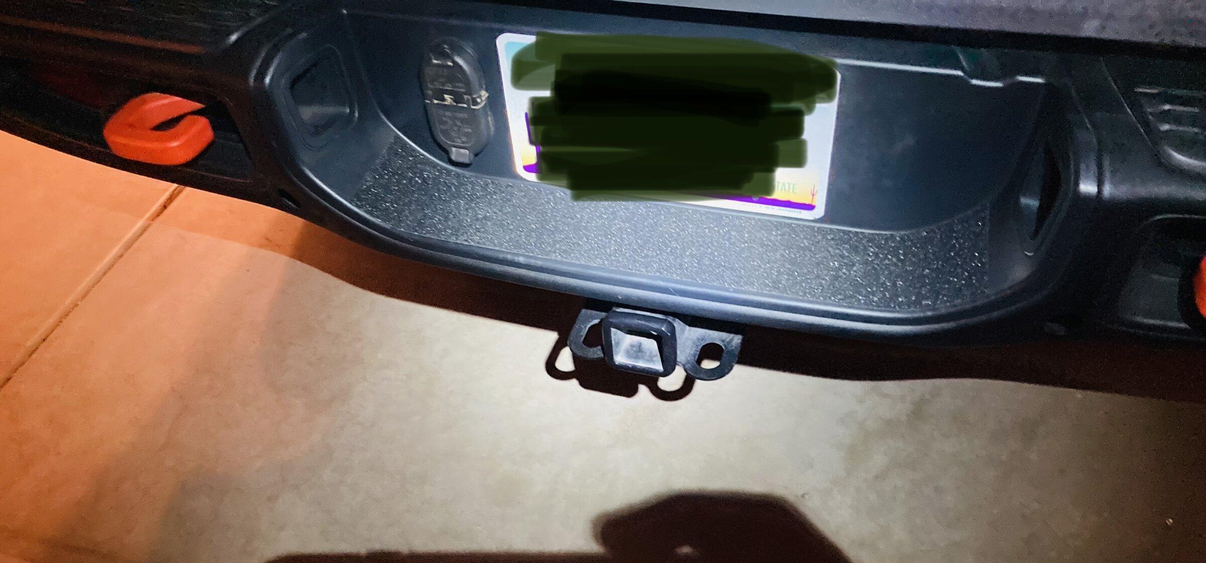

I finally got mine all finished today. I basically had to do it twice because I didn’t realize all the extra parts I needed to swap the sensors. It’s not difficult, but definitely takes some time and patience. Love having the bed sliders!
