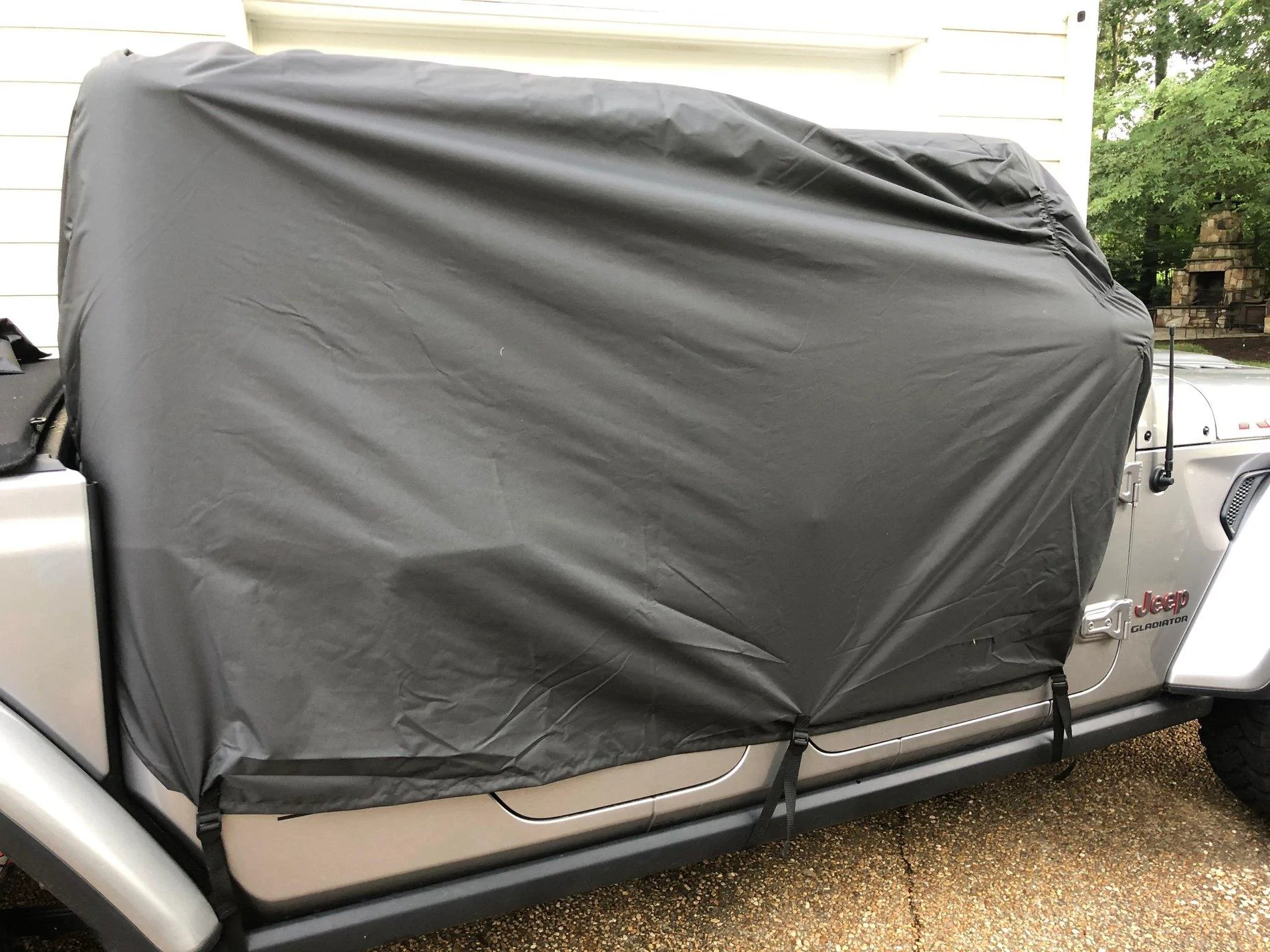

Ok - I just went out and put it on and I can clarify some misconceptions.
1. Just freedom panels removed - no issue fits fine
2. Just freedom panels and the doors removed - this would be issue as the cover will not extend all the way to the bottom of the doors (therefore the bottom 4-5" of the door area are exposed so not full coverage - probably enough in a jam).
3. With back roof and freedom panels removed - then it will extend down completely and cover the areas of doors.
So it will cover your car with freedom panels off - it will not give you full door jam coverage in that situation with doors off.

Here you go - coverage as far as fit and covering freedom panels being off fine (in situation get caught in rain this way). But you can see with the rear roof on you don't have full coverage of the doors.

and if you can't tell from my timestamps - it took a good 60 seconds to put on and 60 seconds to take off

It won't fit with just the freedom tops off?
from what I’ve heard a few times on here, that’s correct. It’ll leave an opening near the front of where the doors would be.

Its fine for me - allows me to leave freedom tops at home and not worry. I wouldnt' have the doors off without the rear roof off - so I'm fine. Even if for some random reason I did take the doors off and not the rear roof - its protected enough for a quick summer shower (won't hurt anything a little water getting in around the floorboard).
At home I garage store so no issues as far as a parking cover at home.

Great info, I assume it would be even worse over a soft top?
About the same honestly. Similar gap left at the bottom of the doors. Minor rain and you are fine. Heavy rainstorm and you are ripping out your front carpet like I did. Back was fine though. In a pintch it does give almost full coverage.
Great info! So it does cover just fine with doors on and whole roof off? How tight is the fit? Enough to keep bugs out? Fingers crossed
yep fits good then and tight. Do need to walk around the car two or three times. make sure you put a board or somethng across in the front as well. It will pull up a lot of water.
Also in case you were curious it does not really work with the windshield down. most water stay out, but not enough.
