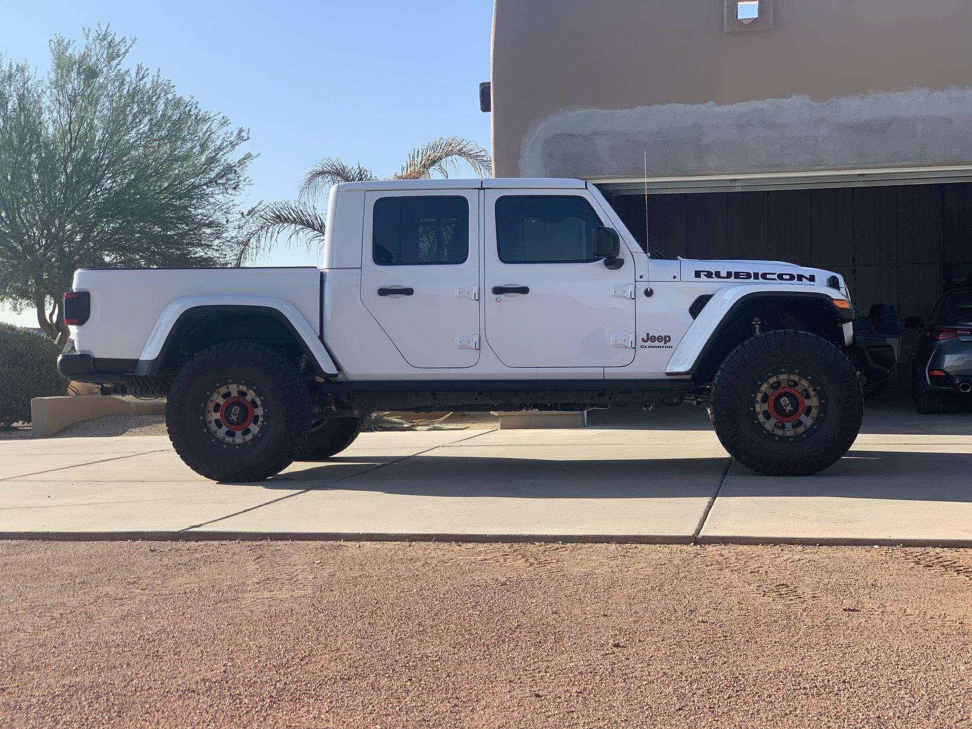

Jeep Gladiator Mopar Lift with Level Kit AF953B22-7525-4C0C-AA79-FC97608588F5
I just added the fabtech 3” dual rate springs with a 3/4” spacer. My bumper with the winch is 150 lbs

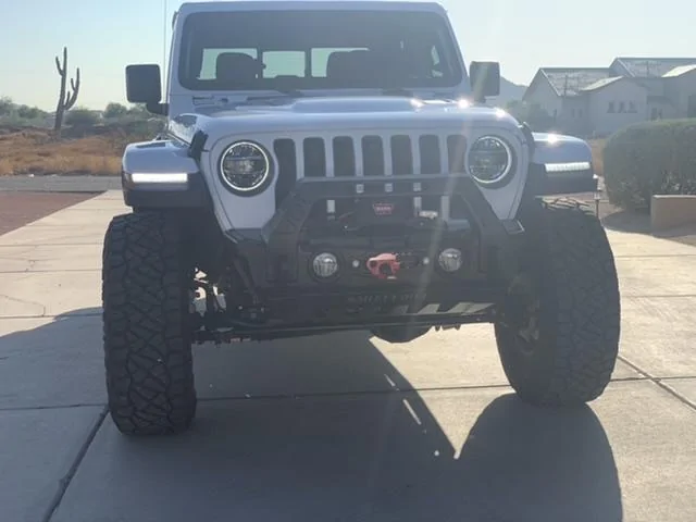

Jeep Gladiator Mopar Lift with Level Kit 577E437B-3B43-421D-BEE6-356F23AD018B
