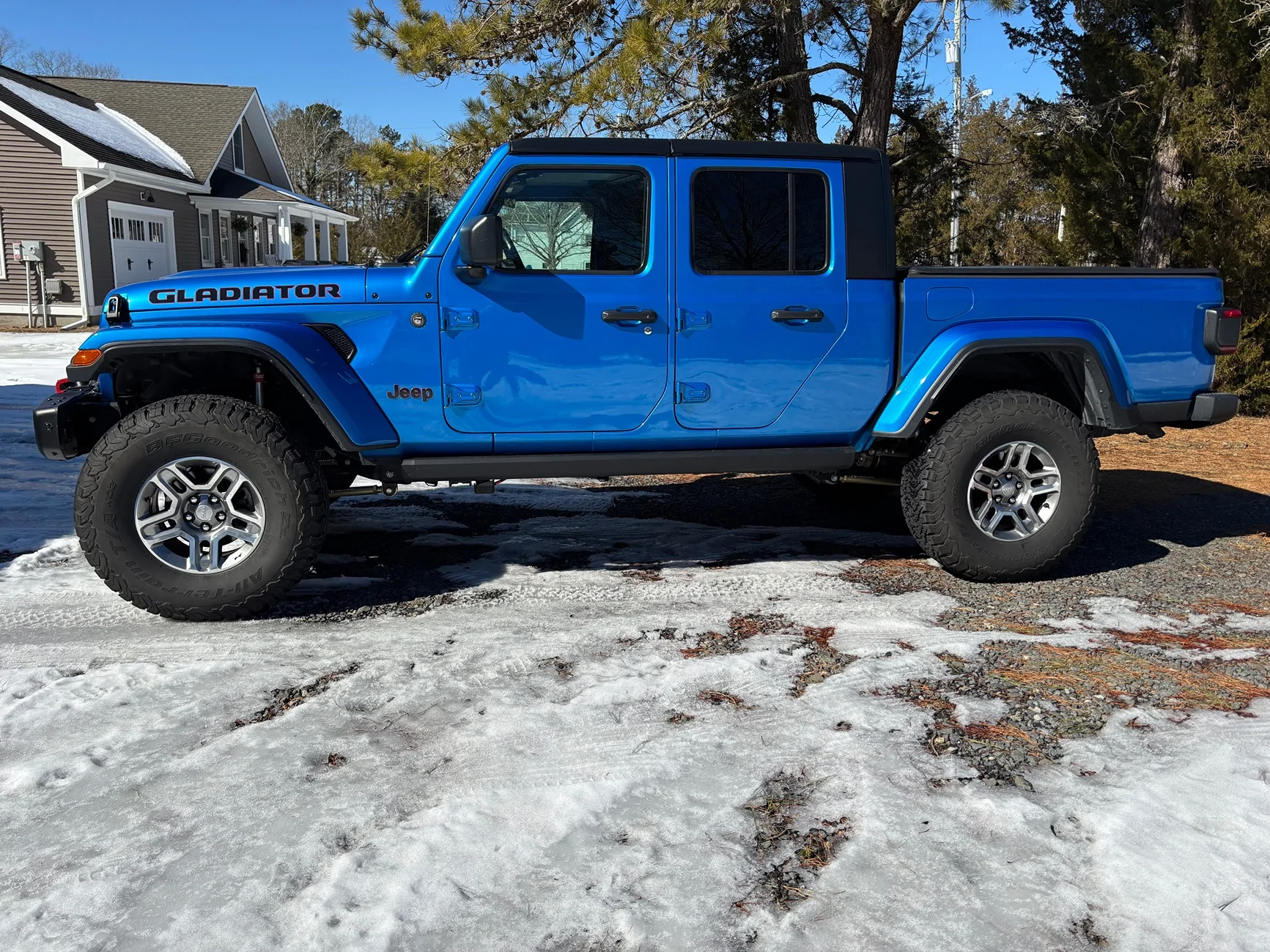

I have no rub any place but I also have the wide axles with the same tires
Jeep Gladiator Mopar Performance Wheels 77072494AB IMG_1801
They look great. Are those 35” or 37” tires? When you are at full turn how close are they to rubbing the control arms? Thanks

Looks like they have gone up here in the states also. The tires are 37” KO2’s. I will check during the day. I have Metalcloak arms but they didnt rub when I had MOPAR arms either. I also have Currie high steer which also gives me new knuckles with adjustable stops in both directions. That said my measurements may not tell ya anything. I did not rub with the OE knuckles either
I measured today while installing new shocks. About 3 “ away from MC arms
