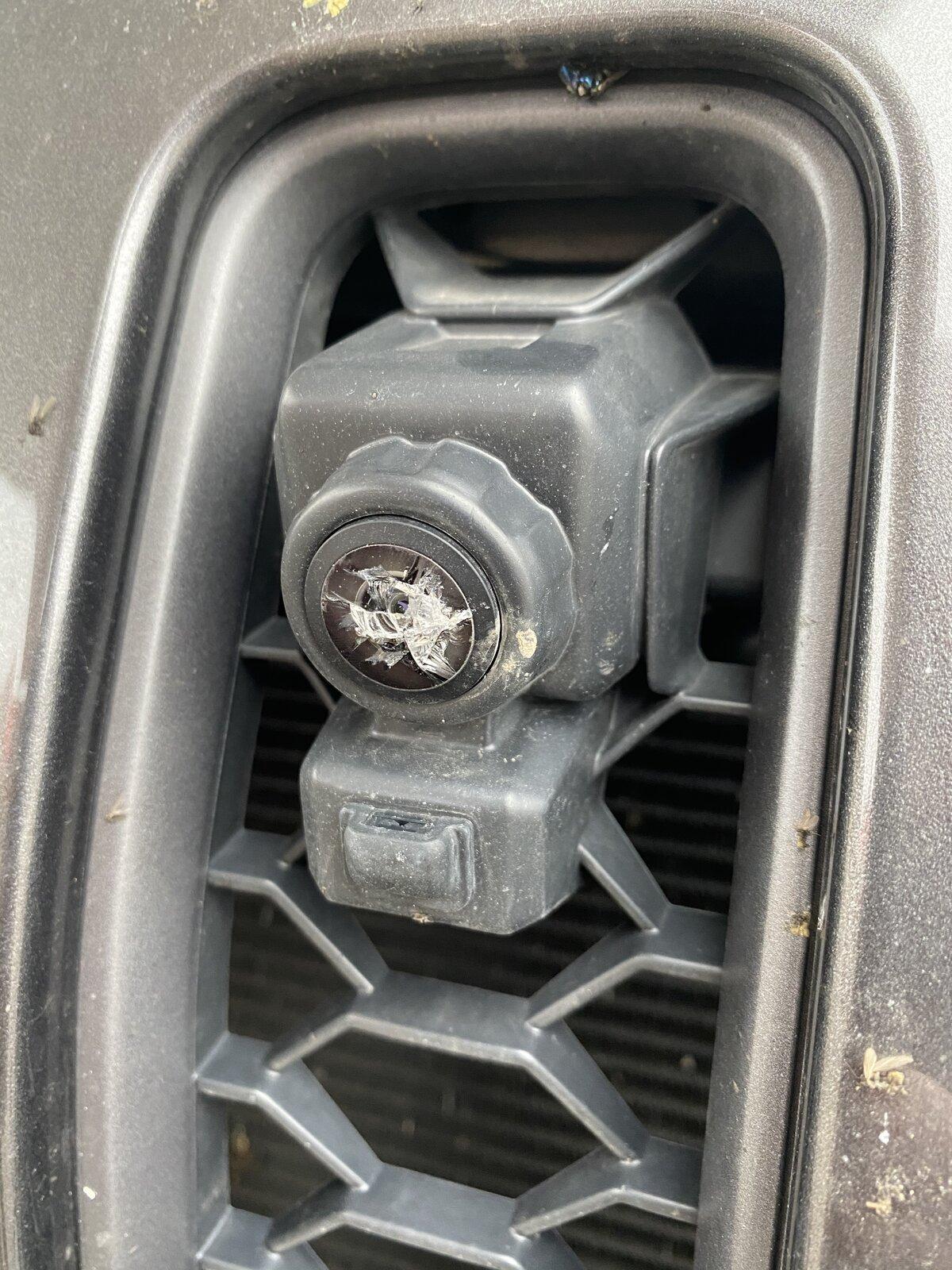

So either I caught a perfect rock or someone wanted to cause me a headache, but either way my MOPAR trail camera lens is shattered (has been for a few months actually and just now getting to deal with it). The camera still “operates” and turns on, but you can’t actually see anything - it’s all just a blurry mess. Anyone know what it’d cost to buy a replacement lens or what it might cost to buy the lens? I know the whole unit is around $1500, but I won’t be paying that. I’d rather go without the damn thing than pay $1500 again for the camera.

so you think the camera part I’m needing is going to be over $1000? Here’s what mine looks like, since I forgot to upload a photo before.

No, that part number was provided in another post and should be about $150. The $1k+ camera is for the ACC/FCW system.

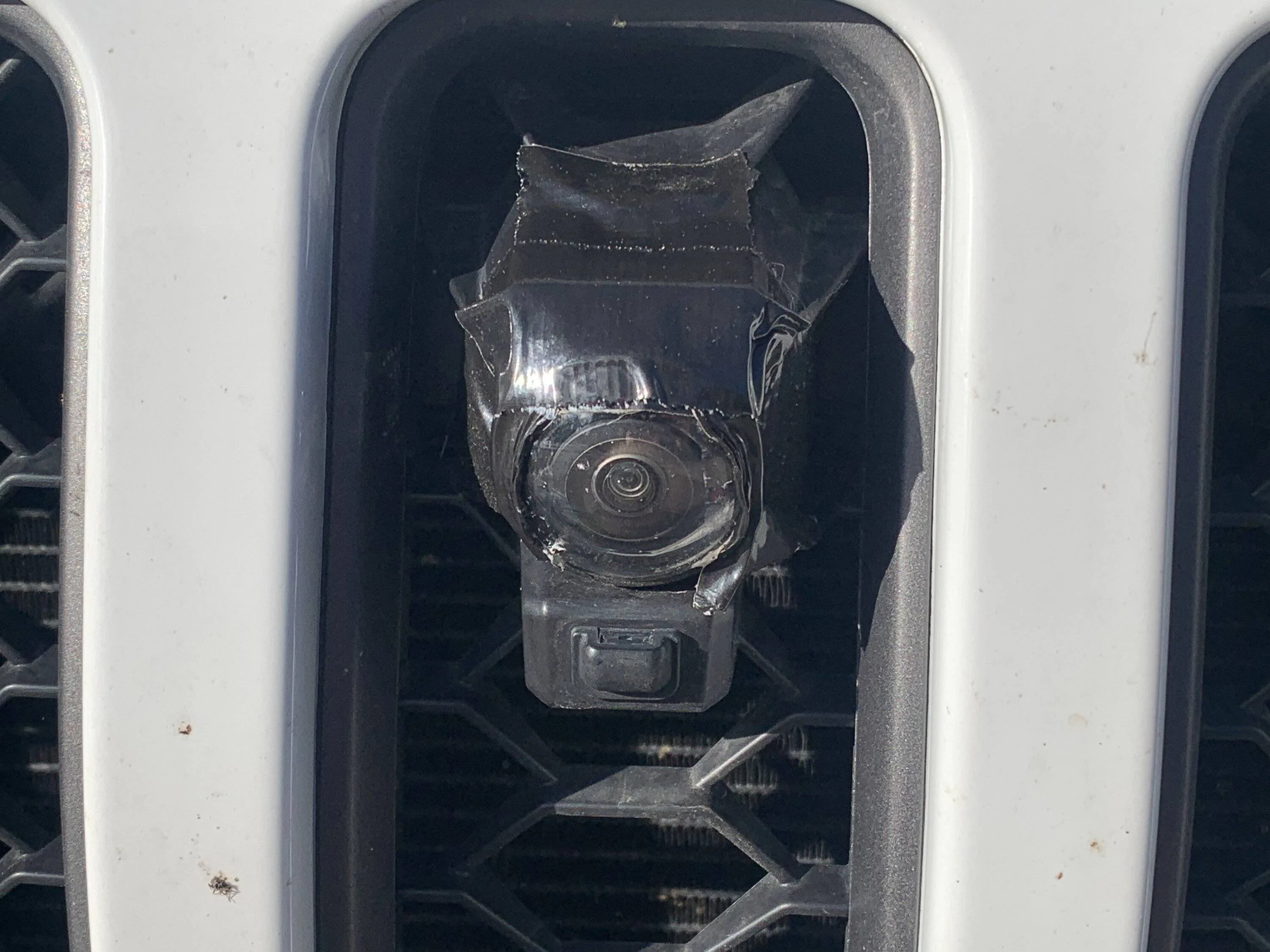

I noticed a small chip in my camera, so I decided to put a lens protector on it. The closest match I could find was a lens protector for a GoPro Max.
