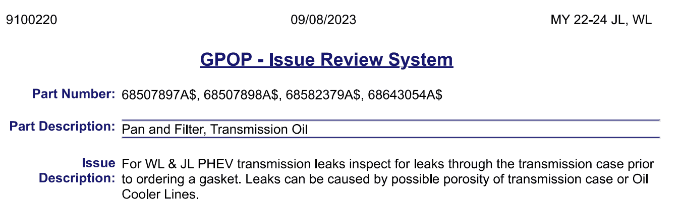

I have one major question, though:
The transmission leak on the 4xe WL and JL is a well-known problem. It appears as a pan gasket leak and makes itself known on the rear edge of the pan, pan bolts, and so on.
Most dealers try the pan gasket, and when that fails (it will) they change the pan and gasket, and what that fails (it almost always does) then you have to argue with them to get a STAR case going, etc.
some dealers go right to that, my dealer hesitated and it was only when I went to the sales guy we worked with and said "Scott, we need to talk" and showed him the wet cardboard that had been under the Jeep - and reminded him we've bought 4 Jeeps through him since 2018, it was then that things started to move along and I got to talk to the service manager.
Anyway, sorry, I digress again, damn that ADHD - my question - when we get a reman transmission isn't there a good chance it's at least partially one taken from another that leaked?
And since the leak is a suspected case issue, and they use the cases again on reman transmissions, how the heck can you take in 100 transmissions from JL and WL 4xe's that have the weird unresolved leak and rebuild them, and send them out and say that aren't going to leak again since so far, Jeep has not yet figured this leak out?
If it's indeed the case, as Jeep has said, a suspected porous case issue, and these go back to be remanufactured - won't we all end up with leaking reman transmissions?
