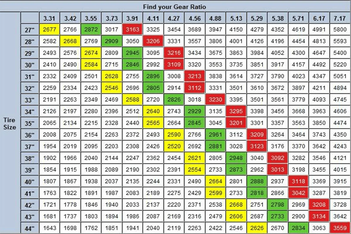

when you go to bigger tires- it is like you lowered ( higher number) gearing- going from 3.73 to 4.11 when going to 35" tires with keep you 60mph rpms the same. And keep the motor in best torque curve. chart below is 1-1 no over drive
Jeep Gladiator MPG hit with Toyo AT3s 35x11.5x17 with 3.73s?? 1636712805453
