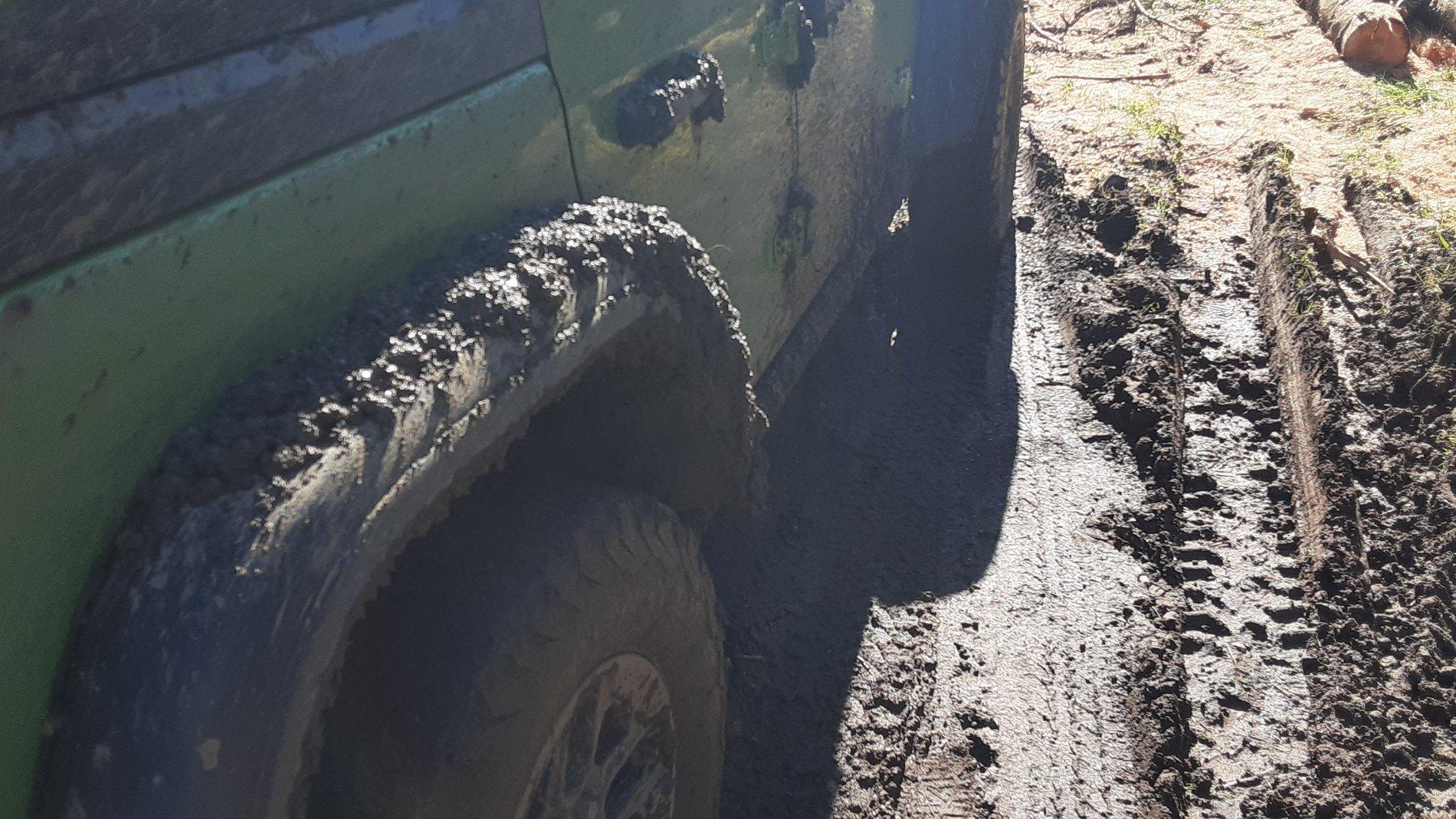

so what’s with folks saying mud’s going to get into the diff and alternator?
Different experiences. Too many variables, how much mudding? what kind of mud? how good was the cleaning after? how deep? etc etc
I know it takes an assload of time to clean up mud, so I will do it if I am ready to spend hours cleaning it. I am sure most experiences result in minimal damage though. I can argue that your Jeep is more likely to get messed up if you go mudding everyday than mine if I don't at all, and I would feel good about that argument. It's a numbers game, put yourself out there more and the chances increase.
It's a Jeep, but also a modern machine with lots of electronics that costs $50k and I figure more than feelings would be hurt if you don't at least consider the consequences. Same with going off road, they are built to but things still get broken don't they? Those broken parts still cost money too if I recall. Your life, your toy.
