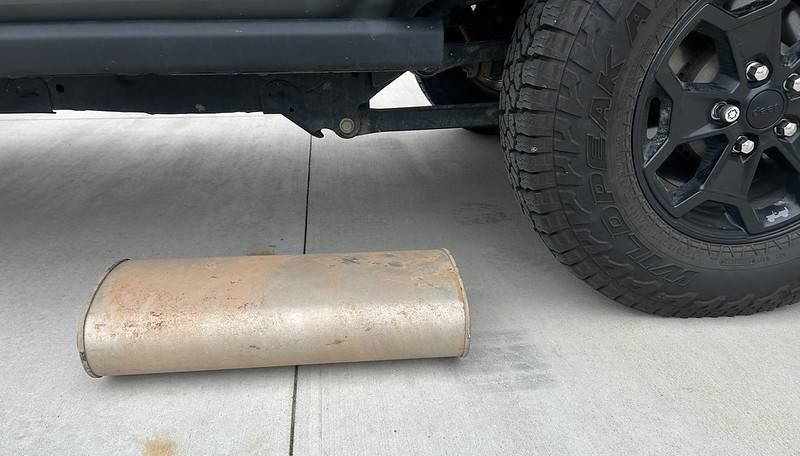

Decided to go with a muffler delete, thought I would share my opinions because my experience varies from what I read before doing this.
My truck: '21 Willys, 6 speed, soft top, 33 Falken ATs. I drive about 95 miles a day for work, with at least 85 of that at 68-73 mph. Typically I do that in 5th gear where the truck feels most comfortable, and that's usually around 2200-2400 RPM.
1) Almost everyone says there is no drone with a muffler delete if you leave the resonators... I left both resonators in place, only had the muffler removed. There is most certainly at least a little drone on the highway in that 2100-2500 RPM range. Is it bad? No, not nearly as bad as some of my previous vehicles with straight through exhausts, but you can most certainly hear it. I can play with speed/gear a bit to navigate around it, mainly by shifting into 6th gear and dropping my RPM closer to 2k. Only downside to that is now instead of going into "auto pilot" I just have to pay more attention and be ready to downshift if I need to go around anyone. Not a big deal, but when you drive about 25-30k a year it's nice to relax the brain on those long boring drives from time to time
2) I get some "pops" before the engine/exhaust gets up to temp. Haven't seen that before, I get it just slowly rolling through my neighborhood between 1-2-3 gear. Once up to temp it goes away.
3) Overall I think it sounds pretty good when cruising around the city. Its nice to actually hear something when revving up to 3k, other than the engine valvetrain coming through the dash.
In all likelihood I'll keep it, but if not I'll look for a small cheap straight through muffler just to take a couple more dBs out.
** That's mud on the exhaust from my trip to The Badlands off road park, not rust **
Jeep Gladiator Muffler Delete videos - crackle/pop + drone 53235180488_c304ce7346_c
Cold start, rev'd to about 2500 RPM

I'm not familiar with the claim that if you remove the muffler there is no drone... what I have done on two different JTs now is taken off the back resonator and just slash cut the pipe after the axle. That is almost indiscernible.

I run a turndown pipe right beneath the drivers seat (where the rear exhaust section connects to the downpipes) so no resonators and no muffler. Dumping it there wasn't my first choice, but the cheapest and easiest. I get drone at 65-70 but that's about it. It was worse before i was able to get the turndown pipe installed.
Slam it from 2 to 3 at about 5,000+ rpm and you'll even get what the VAG crowd calls "exhaust farts"

Seems to be the common theme on the FB pages, maybe they're running mud tires and just don't hear it over the tire hum lol
I run a turndown pipe right beneath the drivers seat (where the rear exhaust section connects to the downpipes) dumping it there wasn't my first choice, but the cheapest and easiest. I get drone at 65-70 but that's about it.
I think mine has seen 5k maybe once, trying to make it up the last 25 ft of a particularly steep incline at The Badlands park.

I cut mine off right after the resonator under the driver's seat. At first there was a noticable drone at highway speeds(just a straight cut 2 in off the resonator)
After a week I added on a 12in long turn down and pretty much eliminated the drone. On 37's and 5th gear (4.56 rears) doing 73-75 I'm around 2450 rpm and minimal engine load - I hear nothing. But shift into 6th and it's noticable

I swapped for a straight pipe keeping the two resonators. 8 speed auto and at 70 mph in 8th gear with 37” KO2s and 4.88 gears I barely hear the exhaust above the wind. Not sure what rpm it’s turning, haven’t paid attention. I don’t get drone at other speeds either. It’s a wife friendly exhaust. Perhaps the long exhaust with stock exit minimizes it.

i did the same: deleted the middle suitcase while leaving both resonators. I don't hear any drone and have never heard a pop. also 6spd

Interesting, guessing you don't have any extra sound deadening either. I have carpeting + Jeep rubber mats front and rear. Not sure why some seem to have drone and others have nothing.
I don't think I have sensitive ears either, I've been riding loud motorcycles for years with no ear protection, shooting guns, etc so if anything I'm leaning more towards the "going deaf" end of the spectrum

Suitcase swap with Flowmaster 40 and rear muffler delete (little resonator left on). It drones on the highway @65+, screams when I’m on it, farts here and there
Wouldn’t do it again but pretty fun around town

Ah yea... I do have sound deadening. Armorlite flooring. That would mask some drone, but wouldn't mask any pops.
