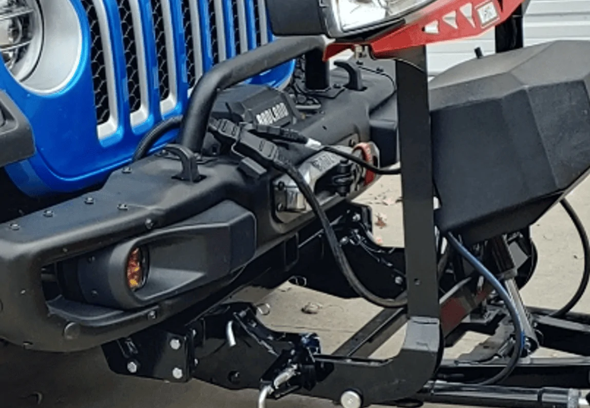

do the arms extending past the bumper remove - looks like they would be a problem in a collision. Particularly with your shins when walking around your truck!
Good question - I'm sure others have the same concern.
Yes, they remove in about 5 seconds each, and about the same time to put them back.
Two hair pins each bracket, then two pins slide out of each bracket and they drop out of the bar.
They do protrude beyond the steel bumper a bit, likely MORE beyond the plastic bumper (and trust me, this would be a piece of cake and work better with a plastic bumper and NO front receiver - my front end is crowded!) damn ADHD, where was I again? Oh, yeah, the winch hook actually sticks out as far - so walk past my truck, brush up against the front bumper and you'll hit two things and I'll mention to you that you are walking too close to my truck. If I see a white cane, I'll rush forward to help you avoid it.

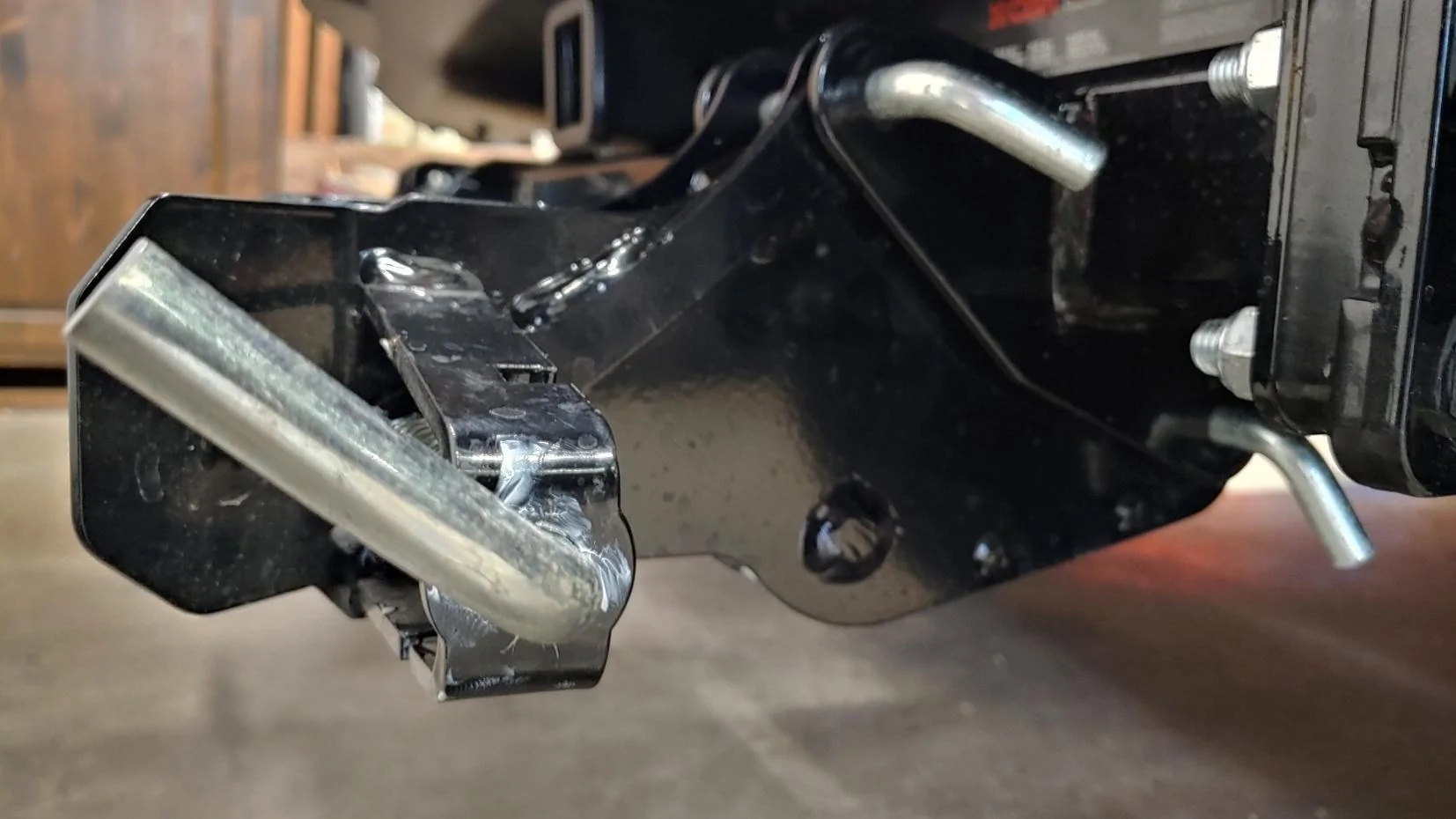

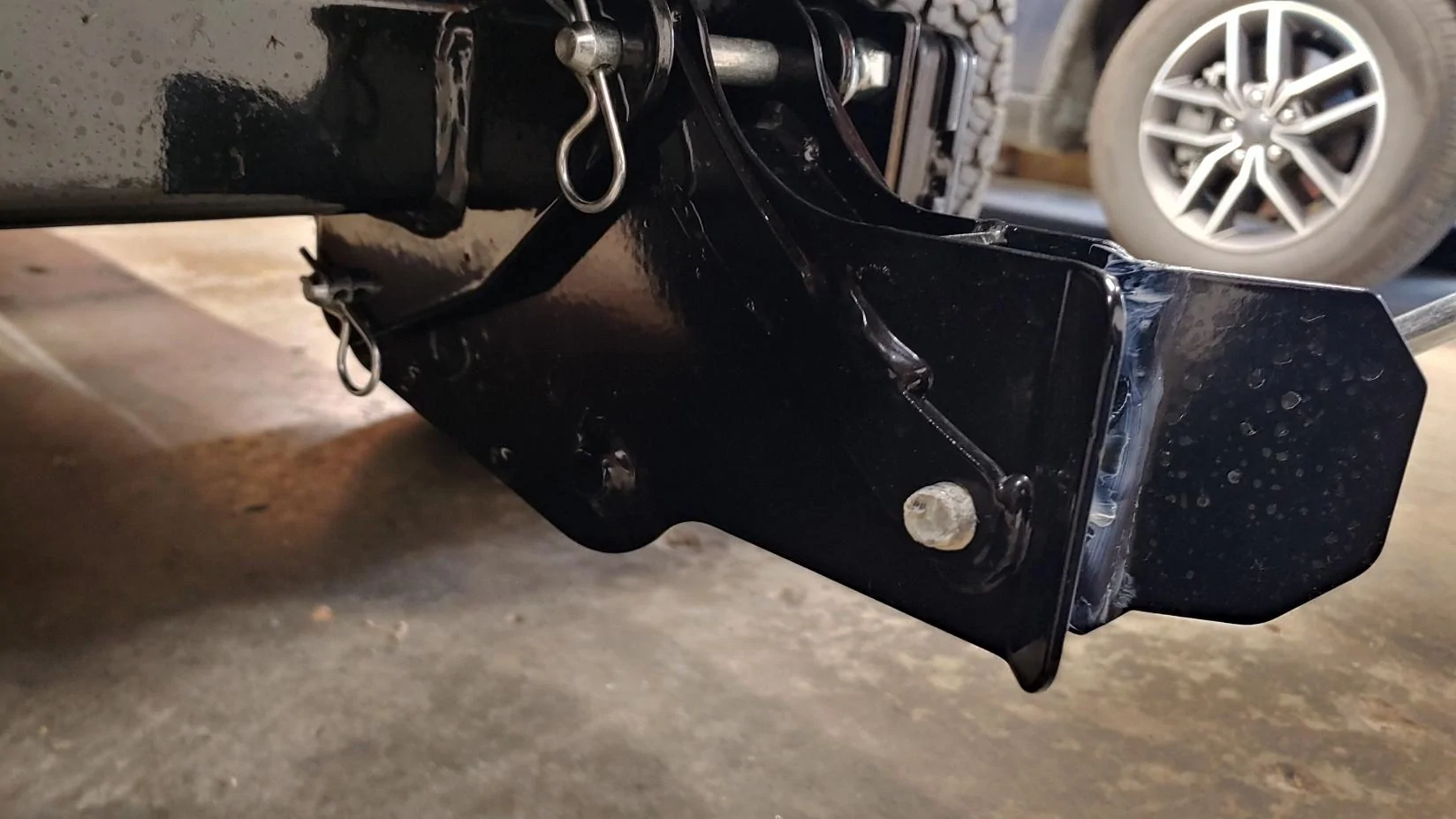

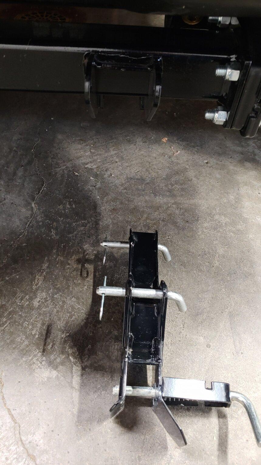

To remove -
Pull the two hair pins shown...........
Jeep Gladiator My experience mounting Western Defender snow plow 20221009_091136_HDR
Next, pull out the two pins shown toward the right in this picture. That quick-mount part drops right off the bar. (you can just see the Curt front receiver in the background)
Jeep Gladiator My experience mounting Western Defender snow plow 20221009_091154_HDR

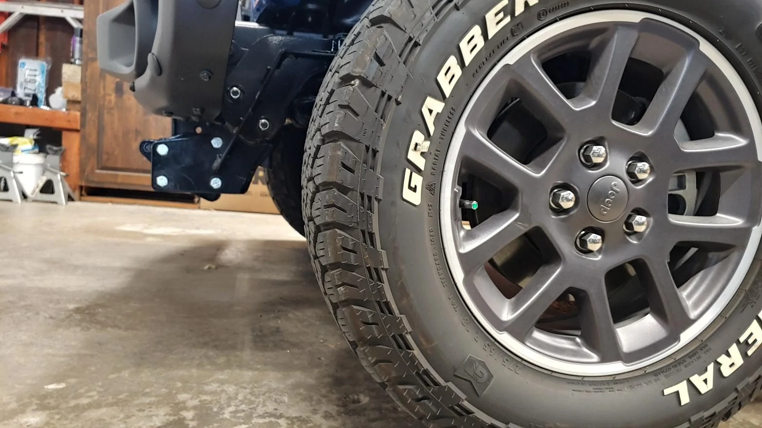

This is what you are removing - you can leave them on when you expect the plow to be needed or if you expect to use the plow very soon, or take them off when the weather clears a bit.
Jeep Gladiator My experience mounting Western Defender snow plow 20221009_091243

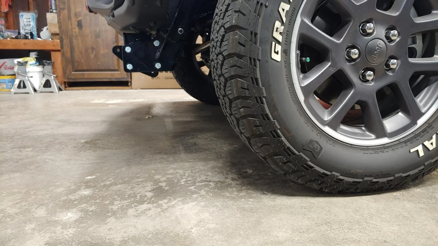

This is what stays (yes, you lose some clearance, but ......... really? more on that later).
Jeep Gladiator My experience mounting Western Defender snow plow 20221009_091423

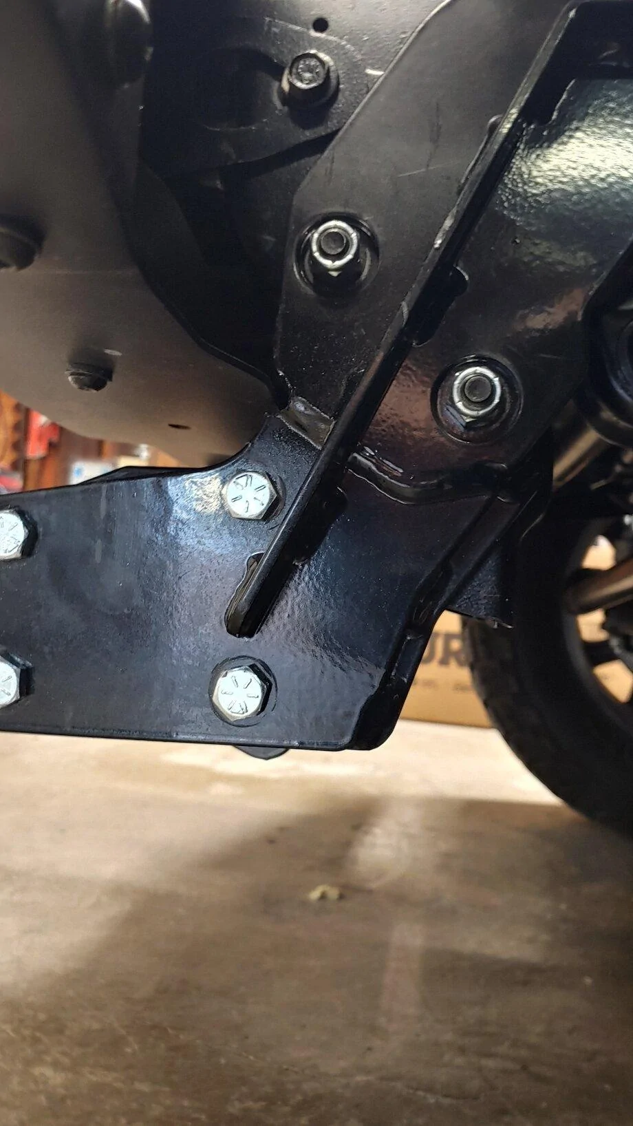

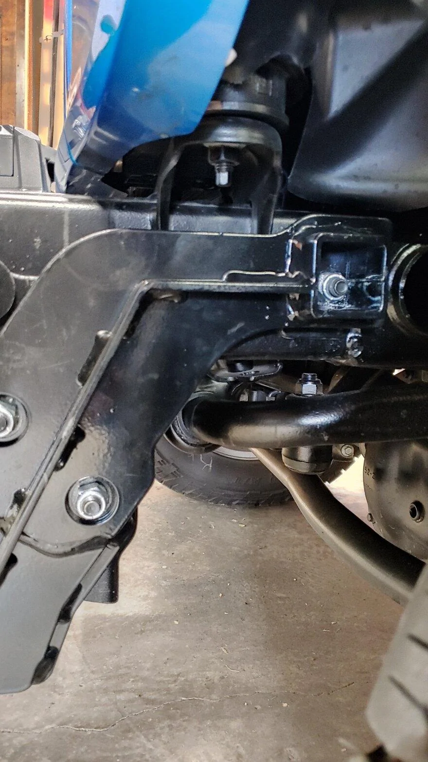

The brackets that hold the plow's mounting bar to the truck are beefy as @#$%
Jeep Gladiator My experience mounting Western Defender snow plow 20221009_091432_HDR
You can see the 3 bolts each bracket- the lock nuts that hold the bracket to the frame..
You can also see the truck's FRAME - the part that sticks down where the skid plate rear mounting bracket would bolt to. This gives an idea about how much farther down the plow mount sticks below the frame itself - not a lot unless you are hardcore boulder climber needing every 1/10" of approach angle. But yes, honestly, you do loose approach (again., more on that later)
Jeep Gladiator My experience mounting Western Defender snow plow 20221009_091452_HDR
Jeep Gladiator My experience mounting Western Defender snow plow 20221009_091506_HDR
Jeep Gladiator My experience mounting Western Defender snow plow 20221009_091517_HDR

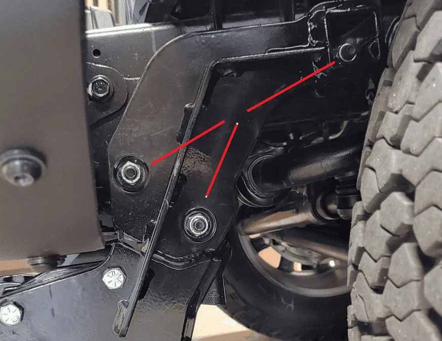

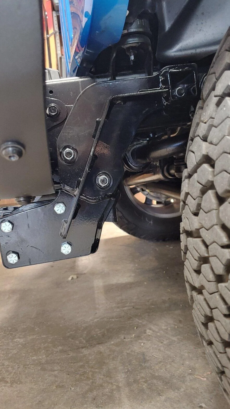

OK, it's later. Here's the "more on that later" bit -
Referencing the pic below - note the 3 bolts/nuts indicated with red lines.
These bolts have steel handles welded to them to let you guide them into the frame and through holes in the frame. The handles stay on the bolts and are stout.
You trim off the excess handle of each so they don't protrude beyond the end of the frame.
What if you used some sort of clip like used to be used to hold brake drums and rotors onto hubs to hold the bolts in place so that when you removed the lock nuts and brackets, the bolts stayed in place?
After winter was over, you could take out the 8 bolts that hold the plow's bar to these brackets, or just loosen them, and then take the 3 nuts off that hold each bracket to the frame and take the plow mount off for the summer for those of you who are extremely concerned about approach angles, clearances over 3' tall rocks and logs?
The lower two wouldn't be any problem if they dropped out because they go in from the bottom of the frame where the skid plate bracket bolts to - you simply put them back.
The rear bolt on each side goes in from the very front, BEHIND the bumper, so you don't want that one coming out or you pull the bumper to put it back in place.

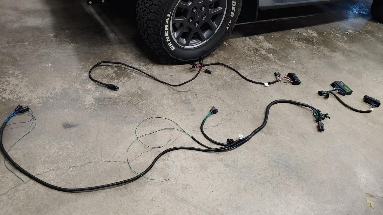

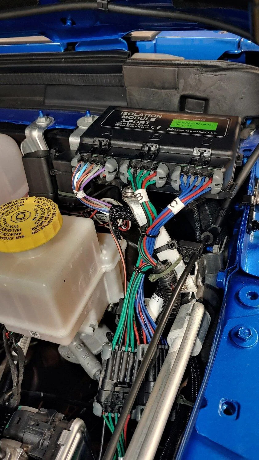

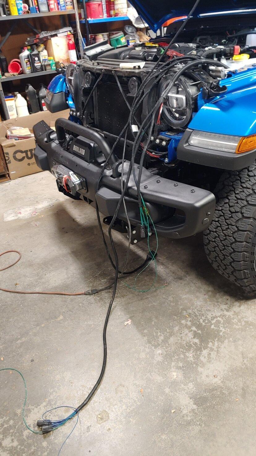

I got the headlight harnesses yesterday so today was electric work, wiring, running harnesses.
Let me tell you, this adds hundreds of feet of wiring and 3 fat harnesses, 6 relays, 3 attached to an "adapter" and 3 attached to the harness that feeds the plow's lights, and an isolation box you have to find a place to mount.

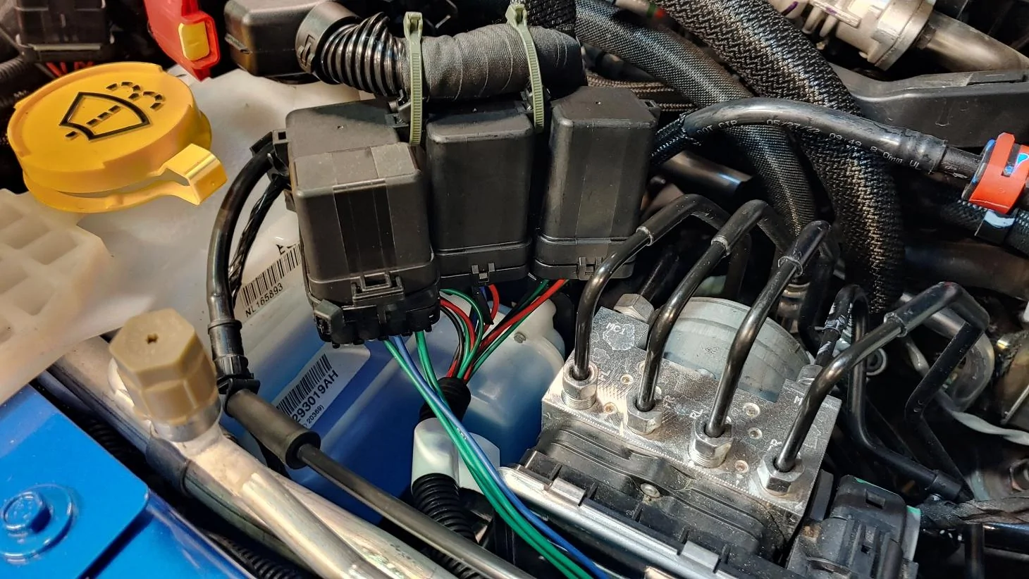

So I had to mount the isolation unit, and 2 sets of 3 relays.
The harnesses are WAAAAY long for a small Jeep. In fact, one is so bad there's something like 3 extra feet I had to literally use both hands to try to squish into a small coil and STUFF ahead of the windshield washer fluid tank. I will be shortening that harness, warranty be damned.
It's a good thing I like electric work LOL
The harness that powers the plow and the hand-held controller plugs into is the way long one. All it needed to do is run from the battery to the firewall, across the firewall to the left and into the cabin for the controller to connect to. Then there's a sub-lead from that with a 4 position connector that plugs into the headlight harnesses for power. I ran that harness from battery, back, across and into the cabin and there was so much left I doubled the remainder and hung it over the grill!
So, with the power/controller harness already in, what's on the floor here went in today. Far right is the isolation module, then a short fat harness with 3 relays plugs into that and the other harnesses plug into that short fat harness.
The one by the tire feeds the plow's lights from the isolation module, the one on the bottom in this pic runs from B and C on the module to the truck's lights to pick up signals as triggers for the plow lights.
Jeep Gladiator My experience mounting Western Defender snow plow 20221022_094122
I'm glad I already used the Oracle pigtails to tap into the park, DRL and turn signals so that part was done last week.

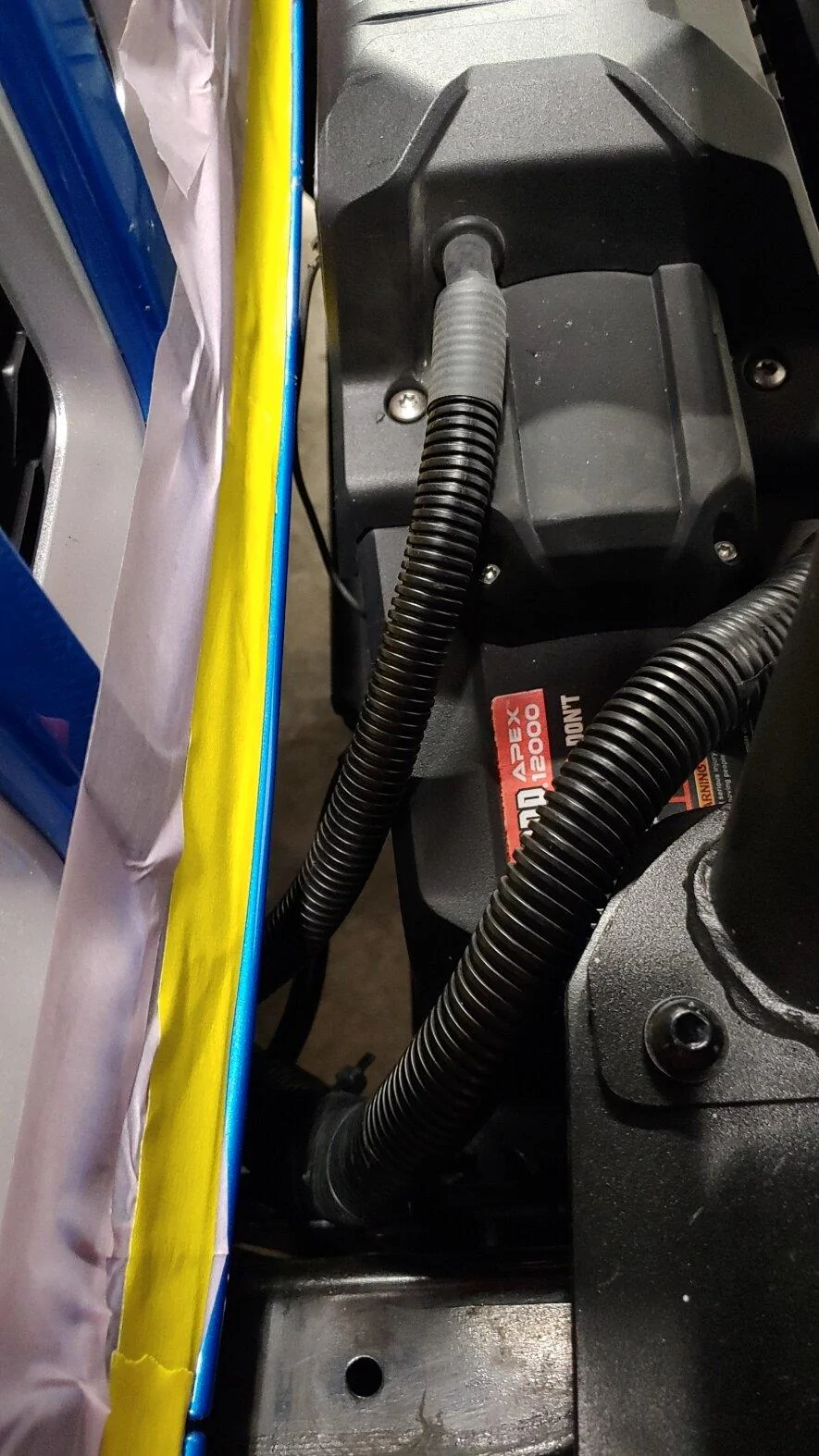

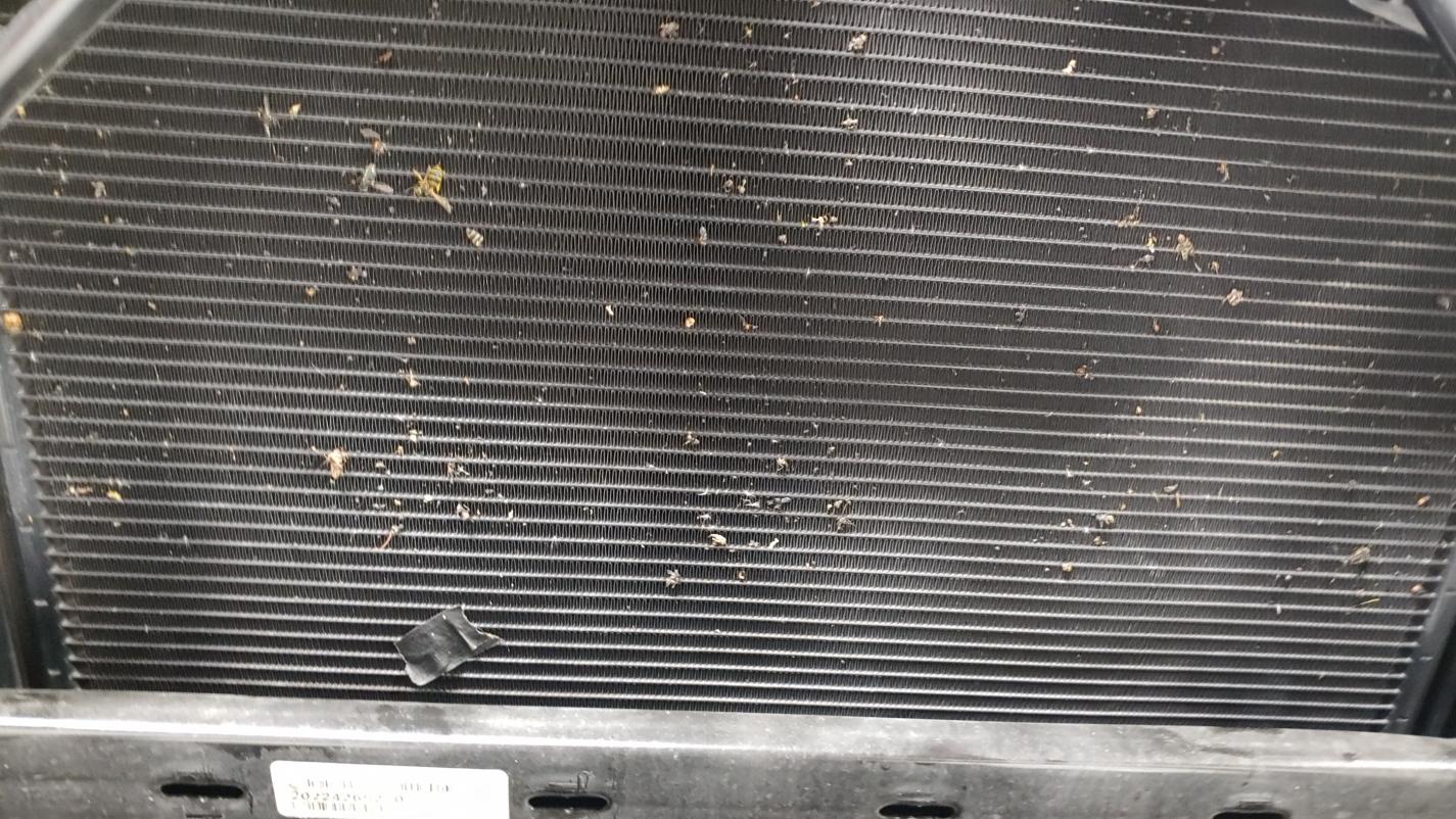

Because of the close proximity of the winch to the grill, I taped the bottom few inches of the grill to protect it when I removed the grill. I know how clips like that work, they often suddenly let loose - and the tape worked. No dings or scratches as the clips let loose.
These pics were taken before I was done taping - I ran another run of tape down lower covering all of the blue.
Jeep Gladiator My experience mounting Western Defender snow plow 20221022_082922_HDR
Jeep Gladiator My experience mounting Western Defender snow plow 20221022_082931
Darn bugs, but I see it sucked in a piece of tape, too.
Jeep Gladiator My experience mounting Western Defender snow plow 20221022_084106

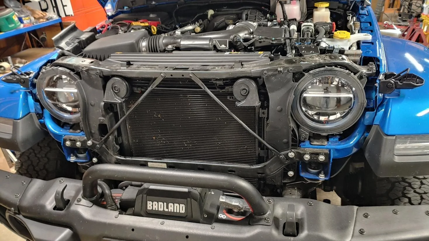

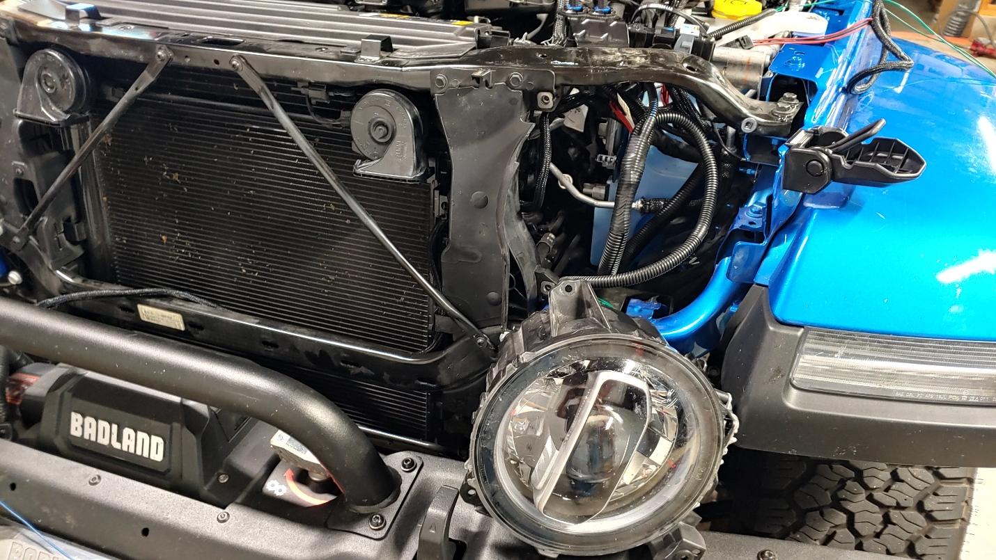

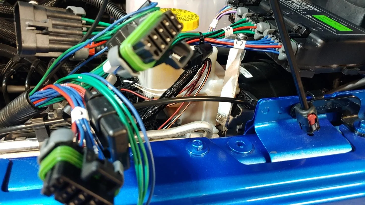

Grill off so I can remove headlights to access the plugs to insert the plow's harnesses between the truck's factory connectors and the headlamps.
Jeep Gladiator My experience mounting Western Defender snow plow 20221022_094129_HDR

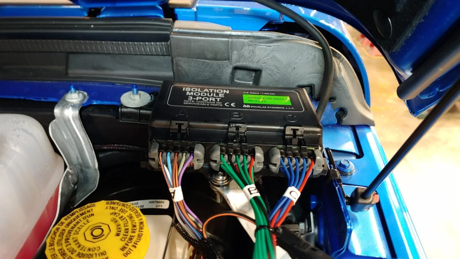

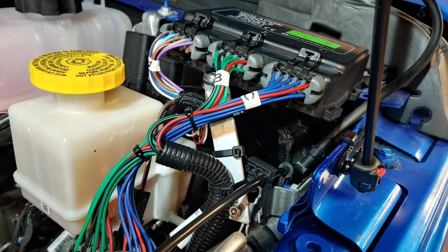

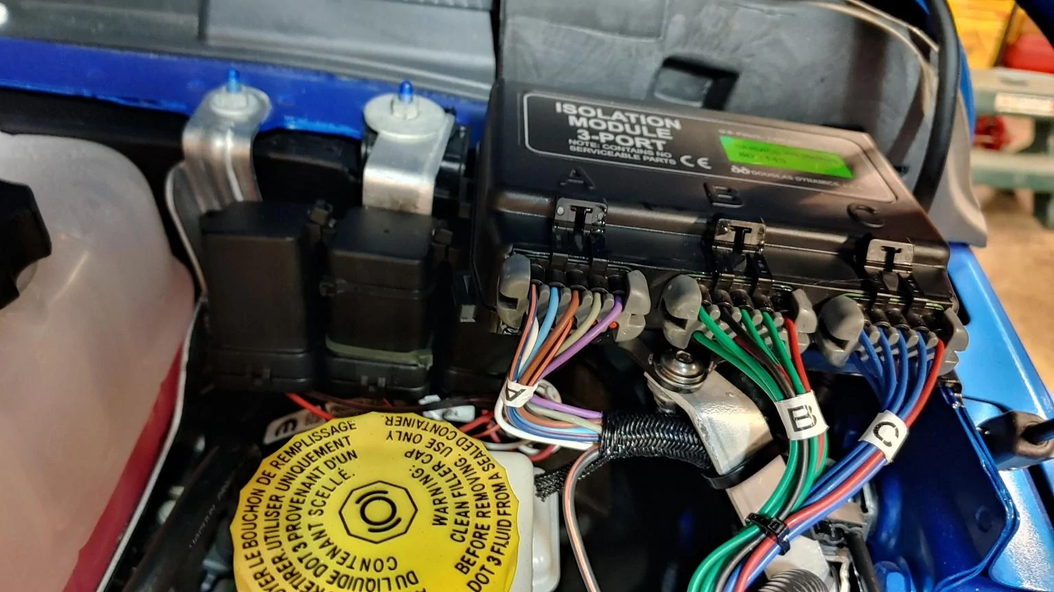

Isolation module mounted, wiring started -
Jeep Gladiator My experience mounting Western Defender snow plow 20221022_113401_HDR
The module has two screw mounting ears. I used a stud on the top of the firewall/cowl area for one and made a simple aluminum bracket to run down to an existing bracket on the truck. It's SOLID. I had a piece of aluminum angle and cut it with my band saw to make two flat strips.
One strip forms the brace shown here, the other I used to mount one set of 3 relays.
Jeep Gladiator My experience mounting Western Defender snow plow 20221022_113405
Jeep Gladiator My experience mounting Western Defender snow plow 20221022_113410

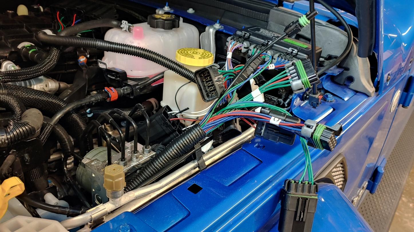

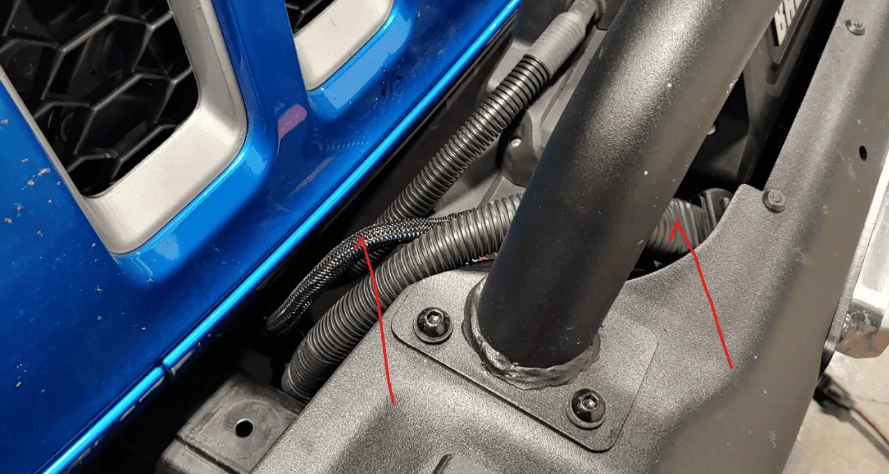

Wiring started - the long one is also way too long - goes across to the right headlight area but I ended up coiling a couple feet of it behind the headlight.
Jeep Gladiator My experience mounting Western Defender snow plow 20221022_113423
You unplug the headlight, plug the plow's harness into the headlight and then plug the factory headlight connector into another connection on the plow harness so the plow harness sits between the truck wiring and the headlight.
The plow's light harness I ran behind the cross bar that the grill's lower clips clip into.

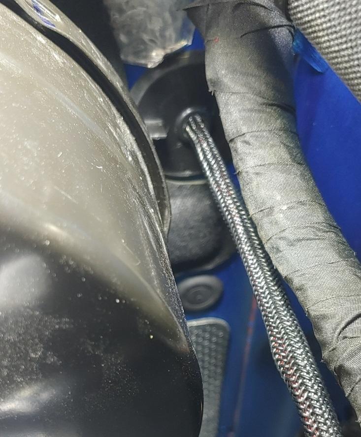

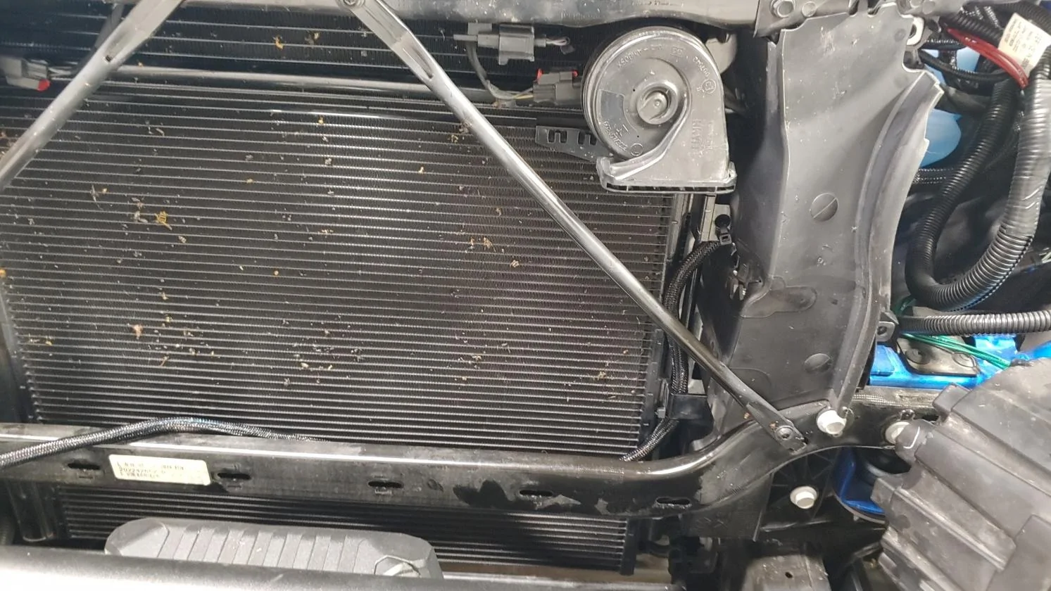

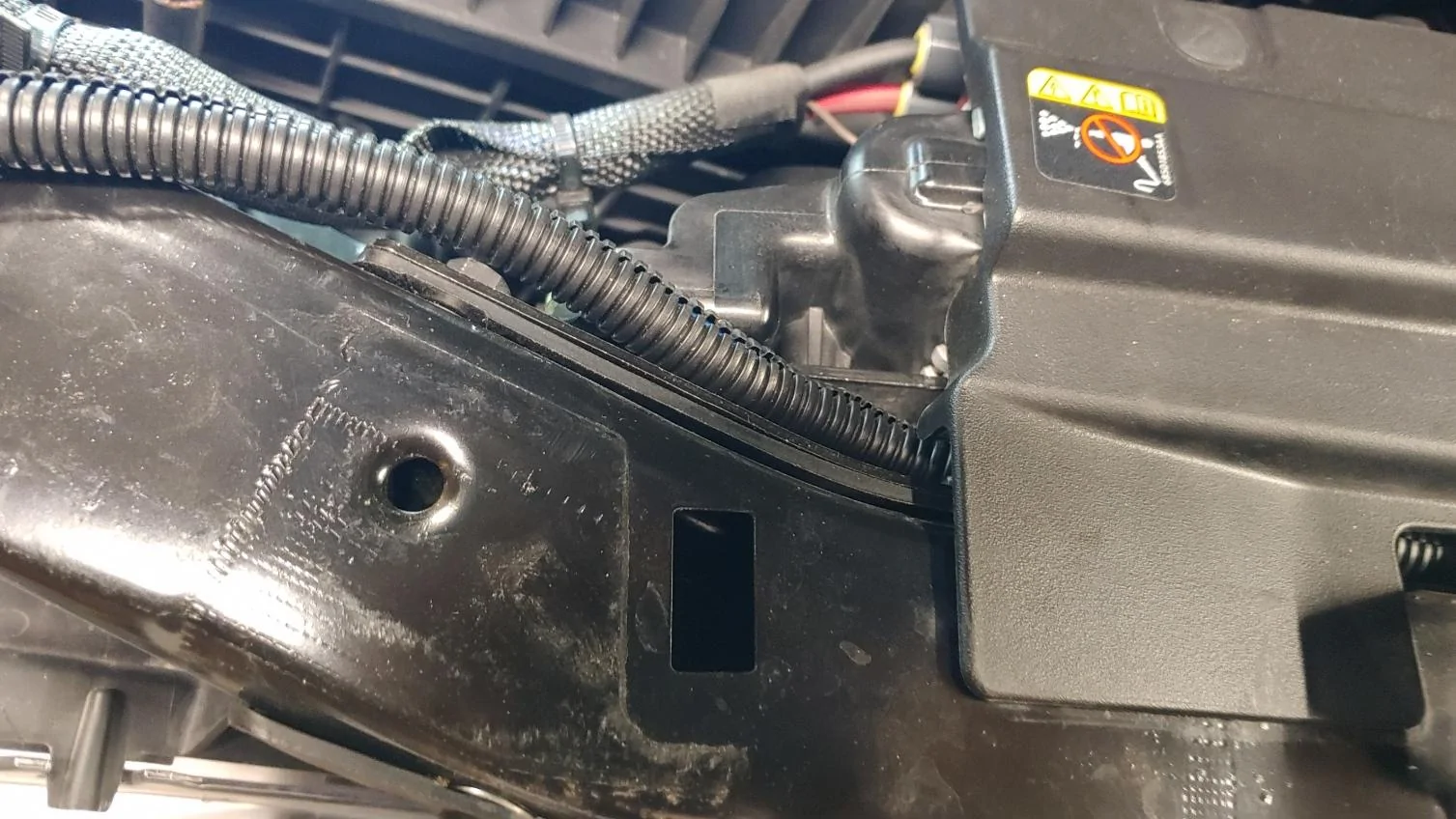

With the grill off, it was easy to lift this shield and run the part of the plow harness that goes to the right headlight under this shield -
In this end...........
Jeep Gladiator My experience mounting Western Defender snow plow 20221022_125522
And out this end.............
Jeep Gladiator My experience mounting Western Defender snow plow 20221022_125526

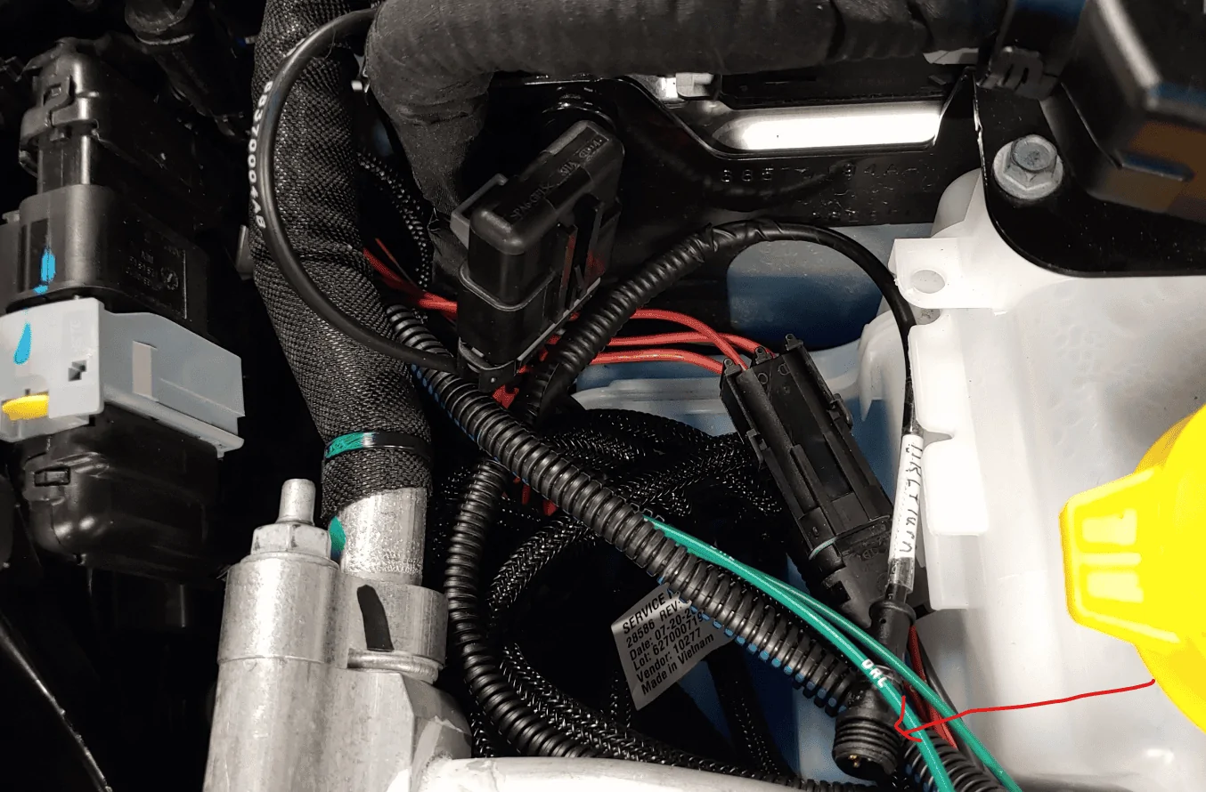

The other piece of the aluminum angle I cut I used to make a bracket to strap these three relays to -
Jeep Gladiator My experience mounting Western Defender snow plow 20221022_143913_HDR
Jeep Gladiator My experience mounting Western Defender snow plow 20221022_143926_HDR
Jeep Gladiator My experience mounting Western Defender snow plow 20221022_143931_HDR

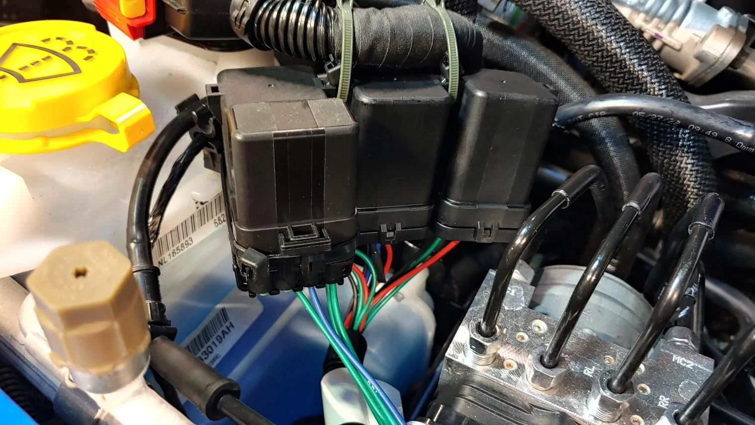

Where to mount this other trio of relays? This is all I could come up with before I had to use the truck tonight..
Jeep Gladiator My experience mounting Western Defender snow plow 20221022_145022_HDR
Jeep Gladiator My experience mounting Western Defender snow plow 20221022_143938_HDR

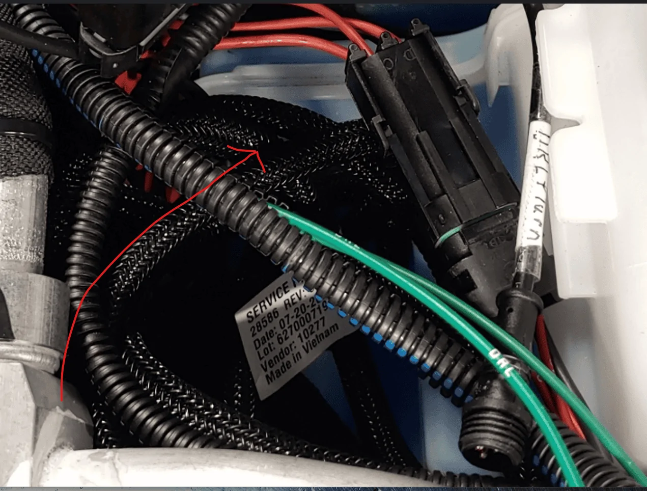

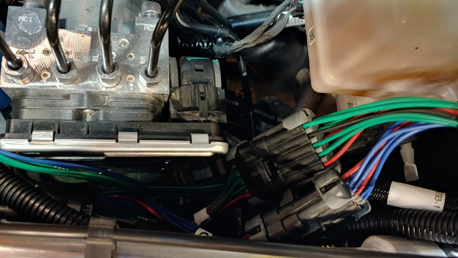

Tomorrow I need to solder the connectors onto the ends of the plow's harness - they intended you to tap them directly onto the park, DRL and turn signal wires. I used the Oracle pigtails and have screw-together connectors on those so I can make the connection.
The green wires here are marked turn and DRL and I'll solder on the mate to the connector I pointed to with the red line -when connected, everything will be connected.
Jeep Gladiator My experience mounting Western Defender snow plow 1666485689620
These are how I'm "tapping" into the DRL, park and turn signals - instead of cutting and soldering directly to the truck's factory harness as Western says to do -
Jeep Gladiator My experience mounting Western Defender snow plow 20221019_221735
Rat's nest of extra harness length - I'll likely be spending a couple of hours shortening this to clean some of this up -
Jeep Gladiator My experience mounting Western Defender snow plow 1666485922549
Tomorrow, I hope to finish those screw-together connectors and actually hook the plow up and check all the lighting, aim the plow lights and so on.

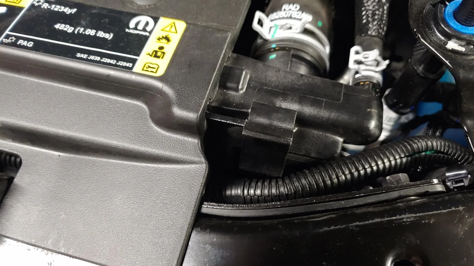

Another video of the parking/turn signal wire access.
40,483
53,972
I like those lights!
If I had some more POM rivets on hand, I would have likely removed the liner. It would have been easier. That's a good video on liner removal.
Oddly, when I removed the screws/bolts, mine only has 3 and all the same size while videos I've seen show 4 with 2 of them 8mm heads and 2 another size head. I don't know if it's a difference with Overland or what.

I used both videos to install the oracle sidetracks on my JT and the wife’s JL. Used the other video to run the wire to tap the courtesy light so it comes on when I unlock or open the doors. I did order a package of plastic rivets and a rivet tool to do this since I installed on two vehicles. These videos kept me from fishing through the firewall on either side and the diesel has way less room for that than the 3.6 does.

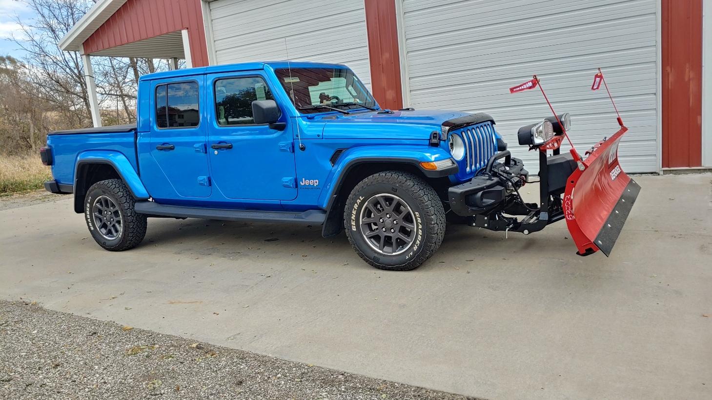

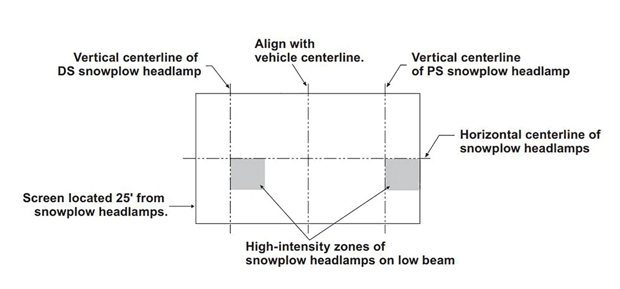

Teaser - more later.........

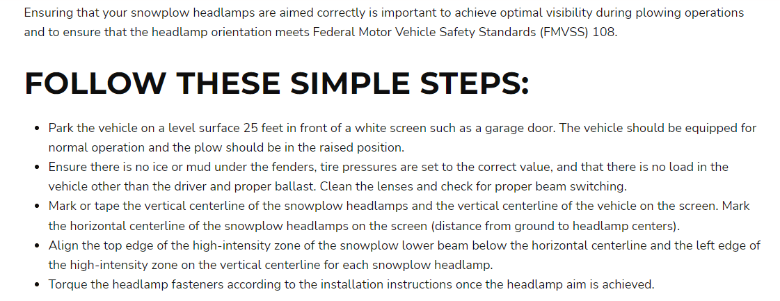

(all lights work but I have no real way to aim them as I don't have 25' of level area with anything in front to aim at)
Jeep Gladiator My experience mounting Western Defender snow plow 20221023_141021_HDR
Jeep Gladiator My experience mounting Western Defender snow plow 20221023_141044_HDR
Jeep Gladiator My experience mounting Western Defender snow plow 20221023_130650_HDR

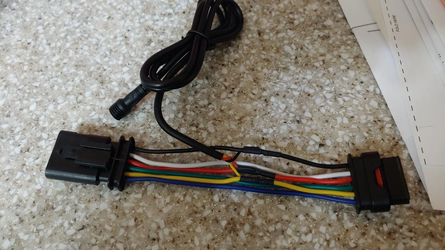

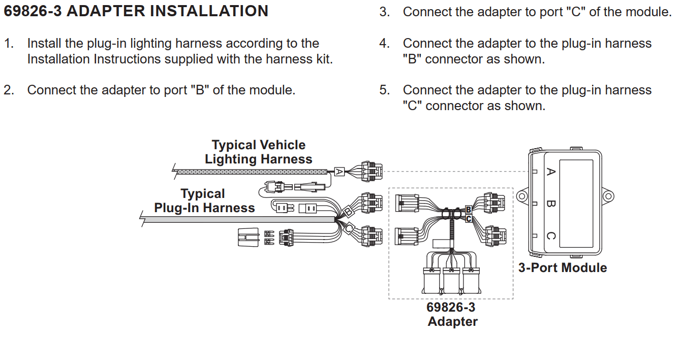

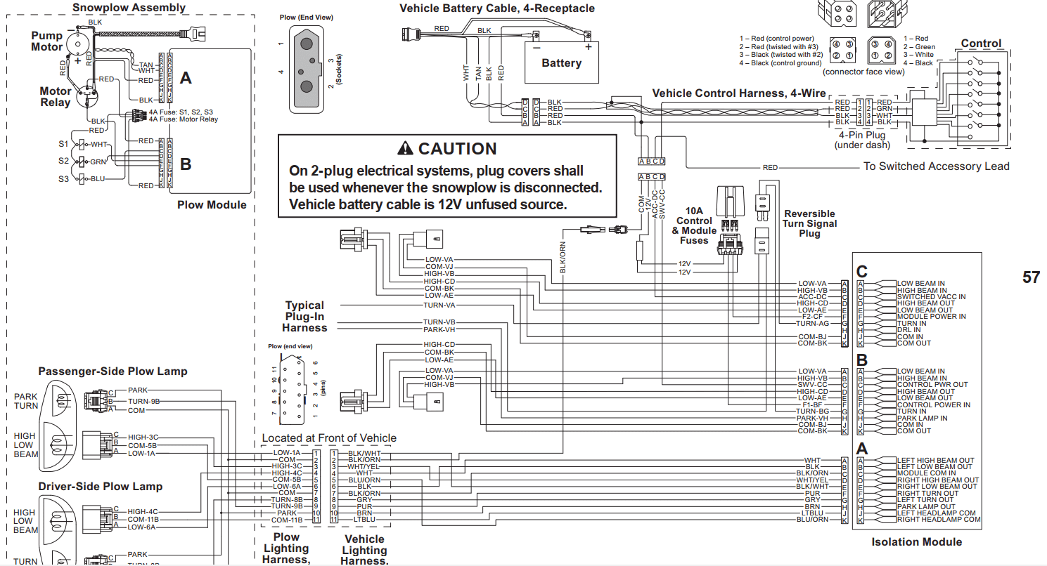

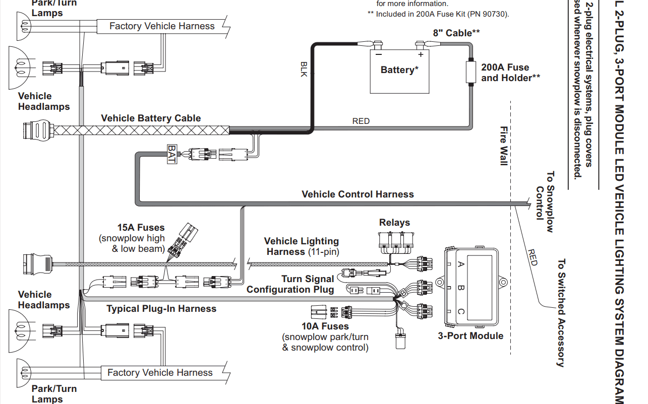

More teaser - actually, this explains why it's so not simple to find space for the wiring harnesses, and why things have to be just right to have the next harness's 4-way connector line up location-wise with the first harness's 4 way connector, and then have certain other connectors end up in the same part of the truck within a few inches of each other! Then the fact they are stiff, and there's a lot of wires, well, these will explain -
This is a generic schematic. It doesn't show the adapter between the isolation module and the lighting harnesses B and C - that adapter has 3 large relays.
This also doesn't show the 3 relays in the harness going to the plow for the plow lights.
Jeep Gladiator My experience mounting Western Defender snow plow 1666565473529
This diagram shows the 3 relays that go to the plow's lighting harness - it shows them next to the isolation module. .
Jeep Gladiator My experience mounting Western Defender snow plow Screenshot 2022-10-23 174446
But this goes in between the isolation module and the harnesses shown above - mass of wires, multiple connectors and 3 relays -
Jeep Gladiator My experience mounting Western Defender snow plow 1666565685741
So I had to find a way/place to mount 2 arrays of 3 relays and they preferred them mounted wire-side down, apparently to prevent water gathering at the connections.
I wish I had a way to mount this big fat-honkin' connectors somewhere instead of stuffing them in the bumper-
Jeep Gladiator My experience mounting Western Defender snow plow 1666565849228
Big cable is power and control to the plow's solenoids and pump.
Smaller cable is plow's lighting.
Jeep Gladiator My experience mounting Western Defender snow plow 1666565927648

To aim your headlights. Use your garage doors. Park the JT 25ft away from the door. Turn your headlights on high and use a piece of tape to mark the bright spot on each side on the door. Switch over to the plow lights on high. Move the bright spot to match the tape on the garage door. I did this every year with the power plant truck with the snow plow.
40,483
53,972
Like I said - I don't have 25' of level ground. If I am 25' away from the doors, I'm pointing up hill if I use my shop doors, and down hill if I use my garage doors.
I need to have the truck on at least "relatively flat" ground.
They actually want you do use the low beam to set things. It's all in one housing for left and another for right side.
Jeep Gladiator My experience mounting Western Defender snow plow 1666572813712
Jeep Gladiator My experience mounting Western Defender snow plow 1666572871286
11,420
30,430
You don't have to be on level ground to do it my way. Mark where your oem headlights are hitting . Then adjust the plow lights to match. Or go to town and find a store with a sidewall and parking lot. Use that for your level ground. I had friends go to the back of the local mall and use the back of the building to use for adjusting lights at night.
40,483
53,972
I had thought of that - but didn't want to drive all that distance with the plow on - and blind people on the trip into town.
I wonder how my neighbor's driveway is - that might work. He's leveled out an area by his garage.
