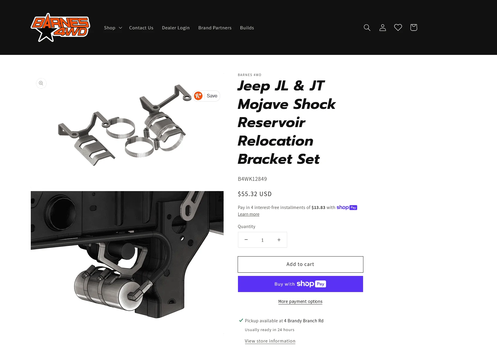

Looks like it might be a tight fit, but Barnes 4x4 has a ready to go relocation kit. Uses the factory sway bar mounting bolt, and $55 bucks is not bad at all...

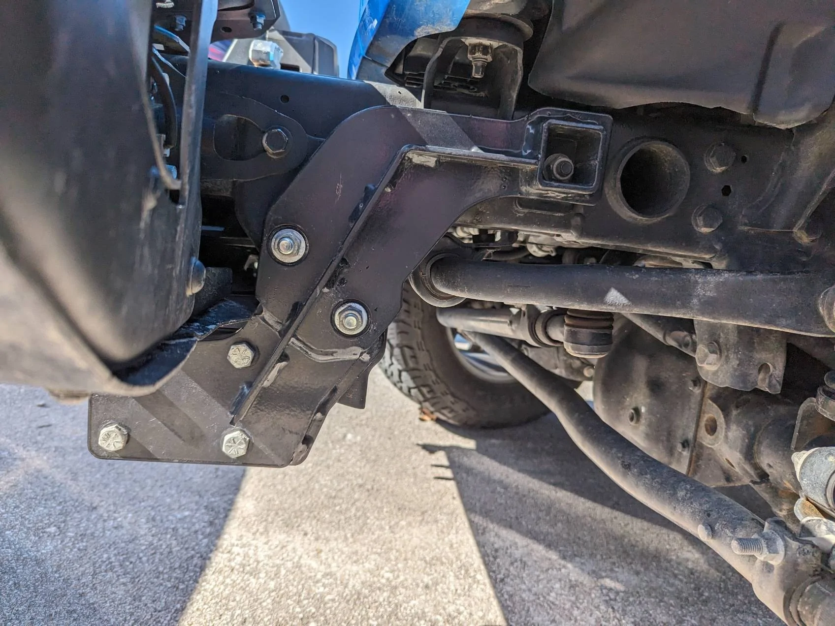

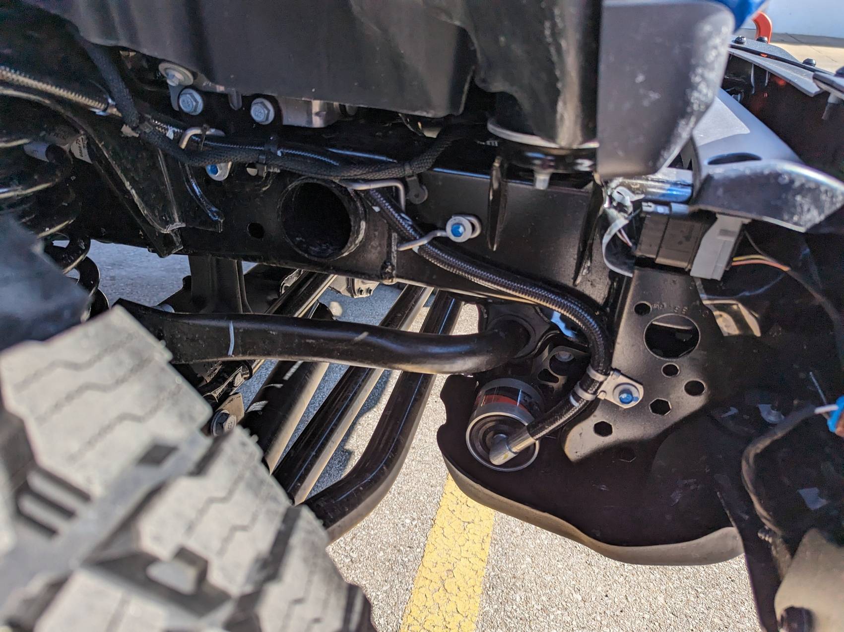

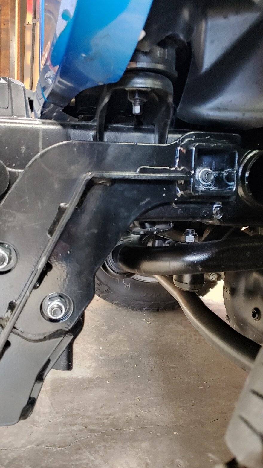

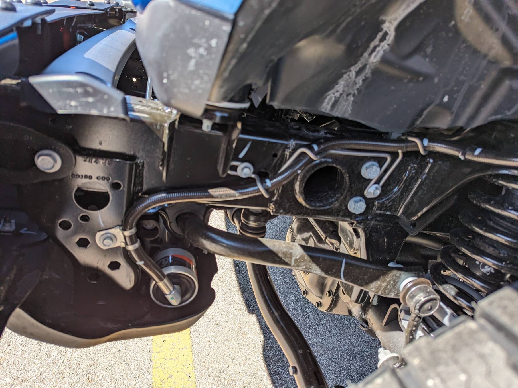

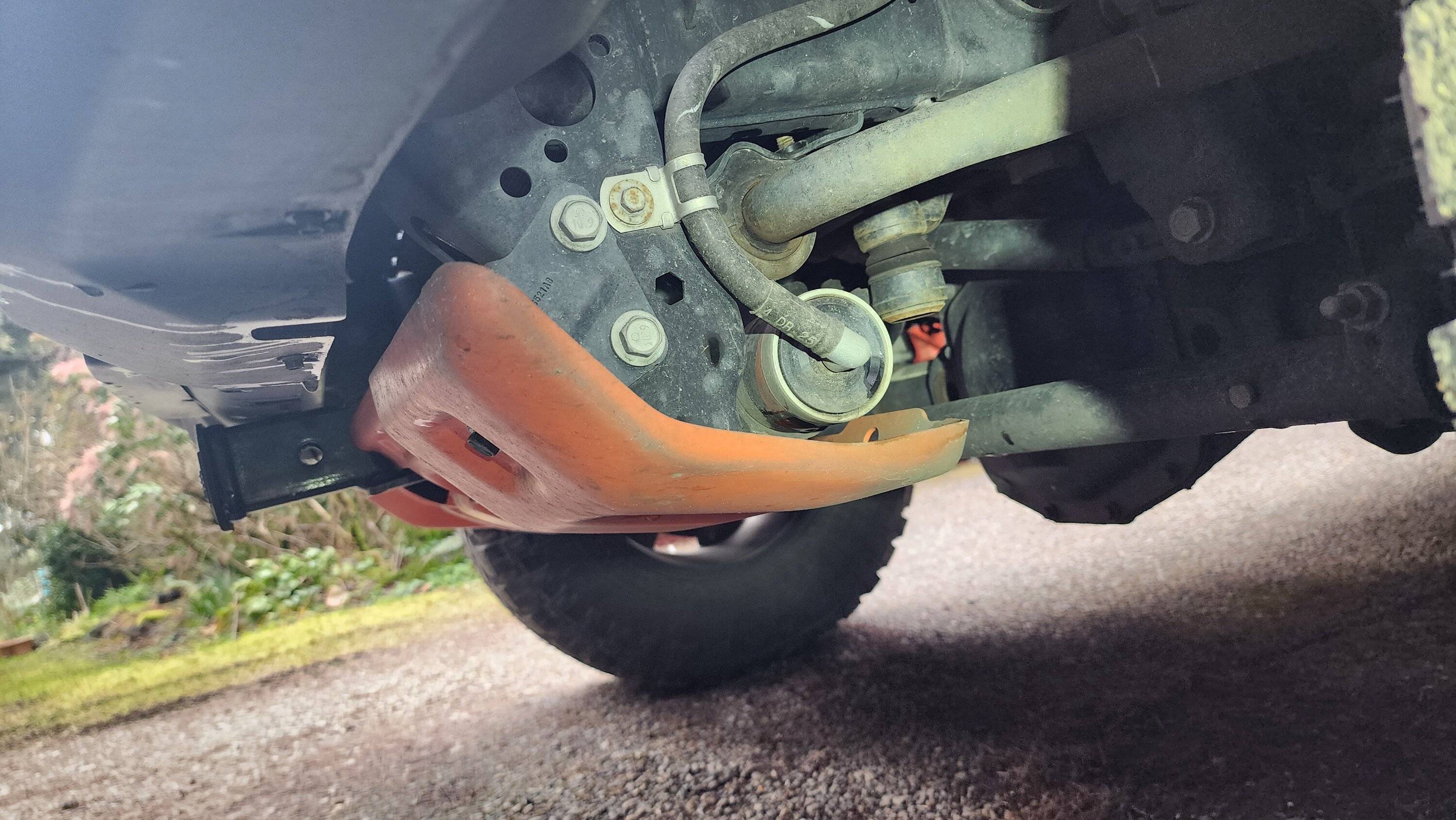

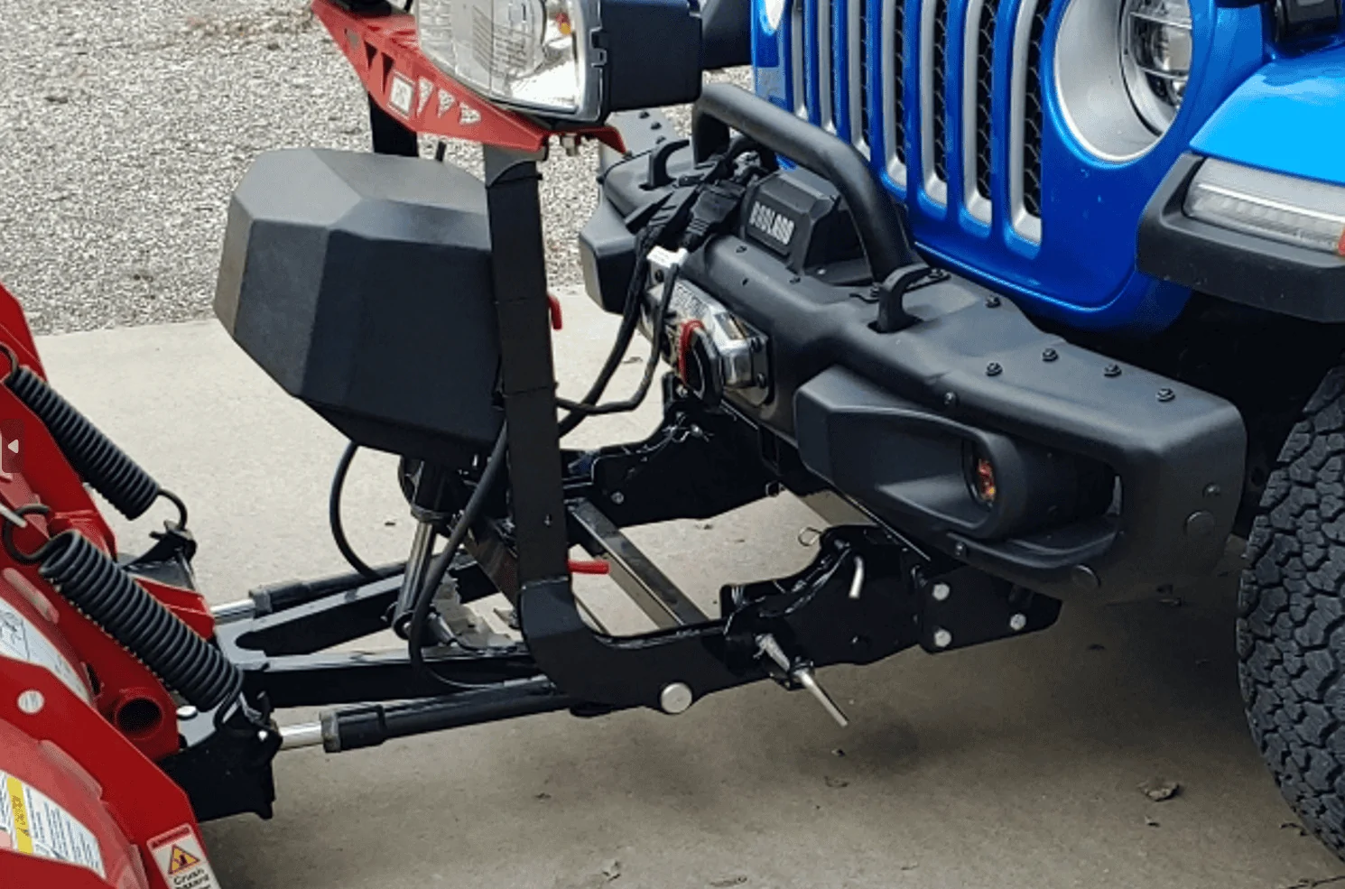

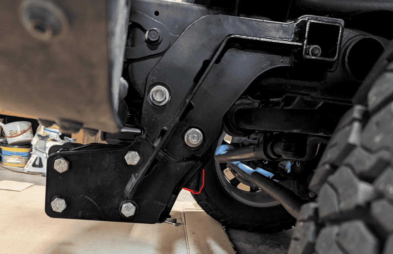

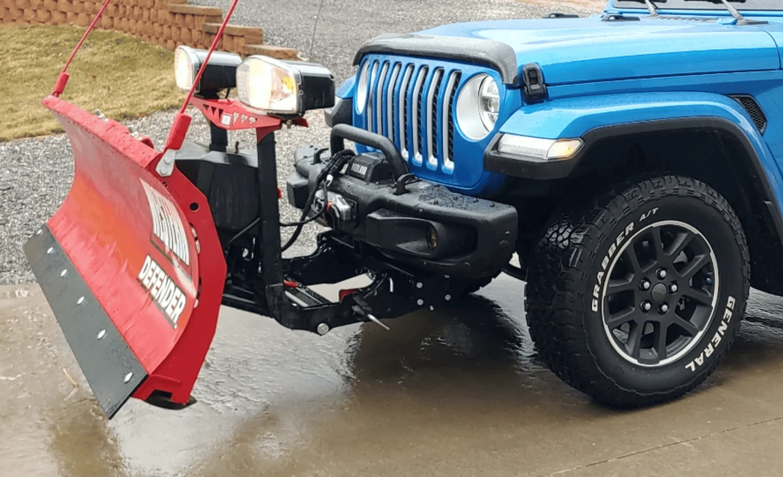

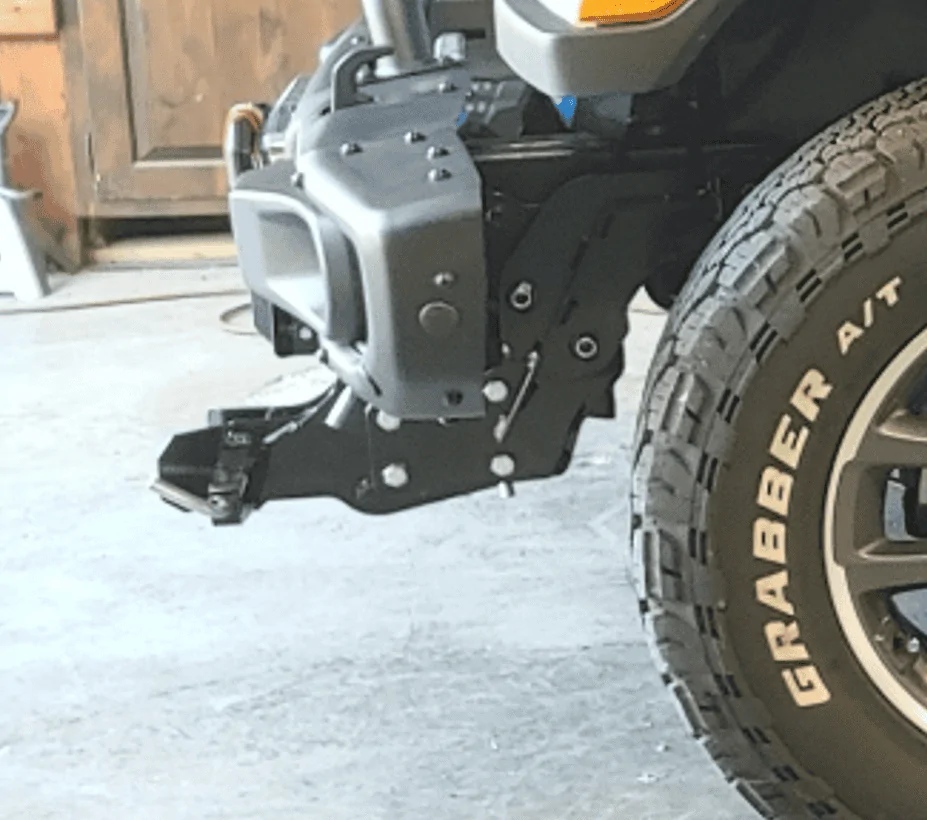

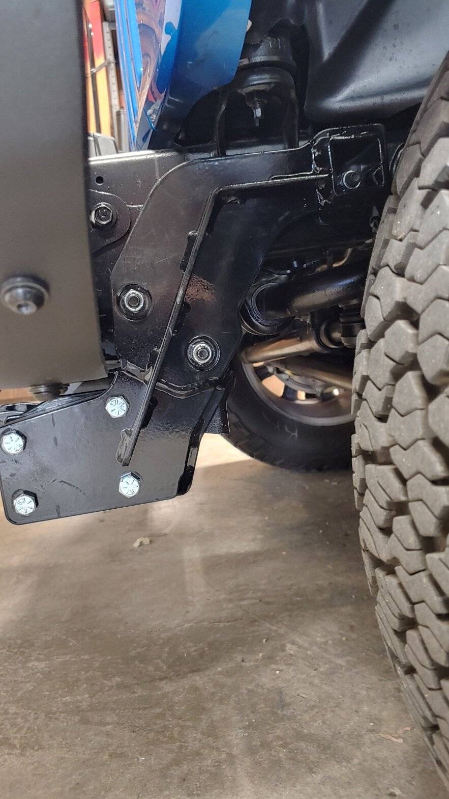

Yeah, color me curious, like my cats - I gotta know stuff and see stuff.

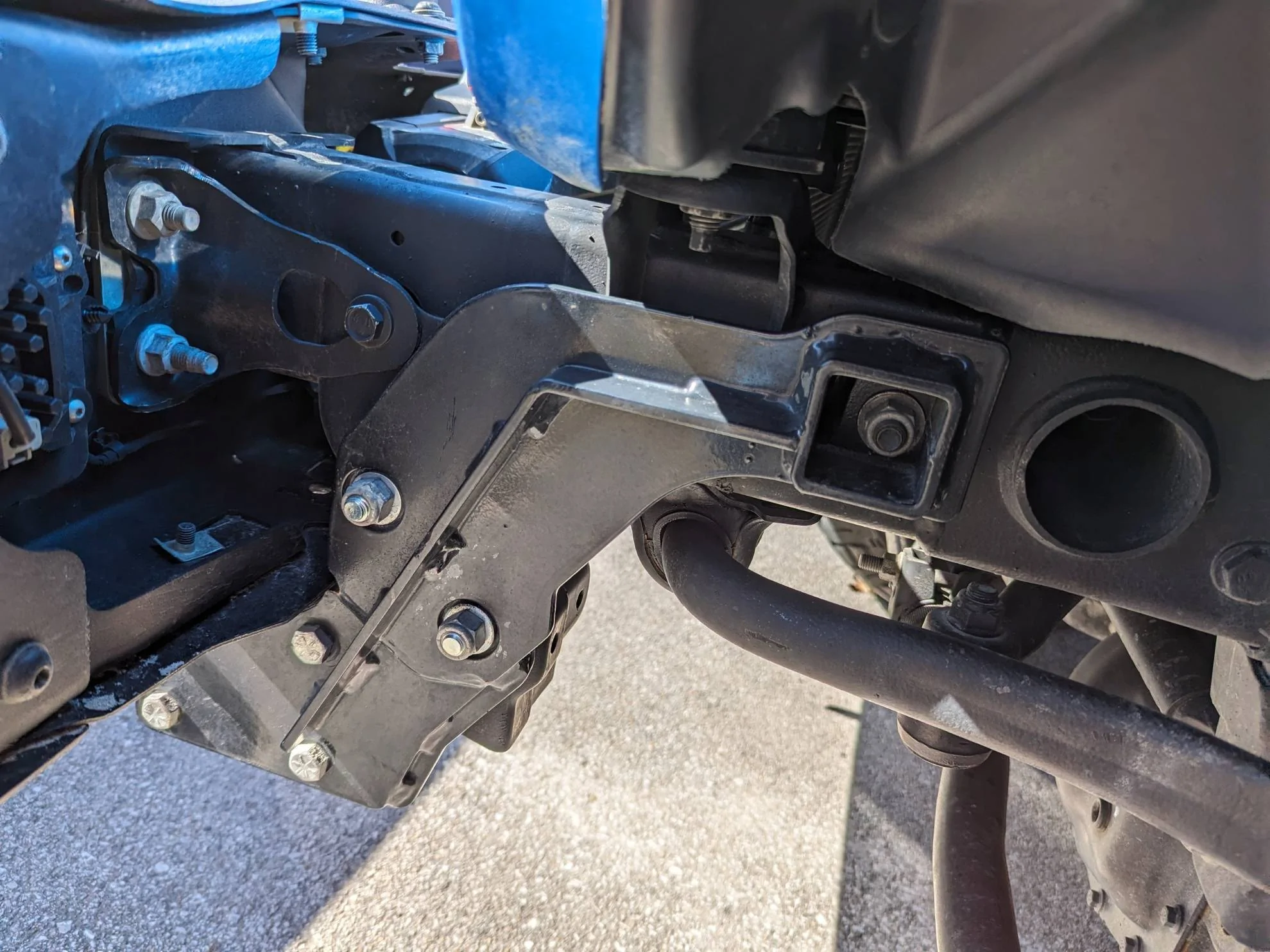

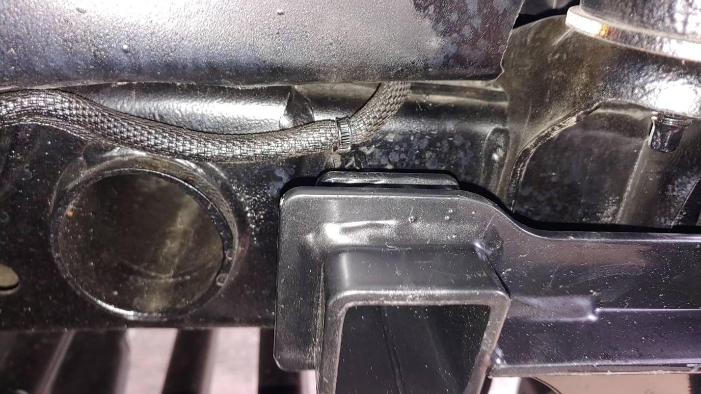

Can a snow plow like I have fit a Mojave? Could my front receiver fit Mojave?
The answer to both is - uh, no.
Can't run the skid plate with snow plow brackets, and the receiver would kill the reservoirs.
Did a ton of measuring and picture taking and the one that said "no" to me was this set of pictures -
My Overland with snow plow brackets installed (I remove them for summer to gain clearance back and reduce wind drag)
Red indicates the horn or drop-down of the frame that the plow brackets mount to -
And Mojave -
Ironically, my JT Overland as it sits right now, sits at almost the same heigh as a stock Mojave. I measured to door sills, to frame points, to rear receiver, etc. and if you put my tires on the Mojave, it would sit exactly the same if not a tad lower. Some points measure the same, others are only about 1/4" difference from frame to ground. Rear receiver is the same 18" from ground to the bottom of the inside of the receiver on both trucks.
My plow says my brackets are for 22" or lower, and I'd need different mounting brackets for 22"+
My Overland measures 22.25" from the ground to the point they measure on the frame - the Mojave? About 1/8" difference - heck add a winch to the front and they'd sit exactly the same.
I just got curious as to why the plow places say no to Rubicon or Mojave and what the heck the real differences were.
Now I know.
Yeah, I had to see what a 2024 Mojave "green" interior looked like in person, among other things. Was there making an appointment for our JLU defroster recall and the park sense goofiness and Scott said "come on out and measure and take pictures all you want".
Sorry, Scott - the shock reservoirs are definitely a problem, no way for the front receiver or my plow mount. (not to mention needing to rob a bank or something, maybe meet up at the border and move some more product for some fast cash)
I'm sure there's plenty of kits to relocate the reservoirs and you can delete the skid. But at this point whats the Mojave got that your overland doesn't in the line of what you need the vehicle to do? There's not really a reason to go Mojave over any other trims unless you like takin whoops at mach jesus. just my 2 cents.

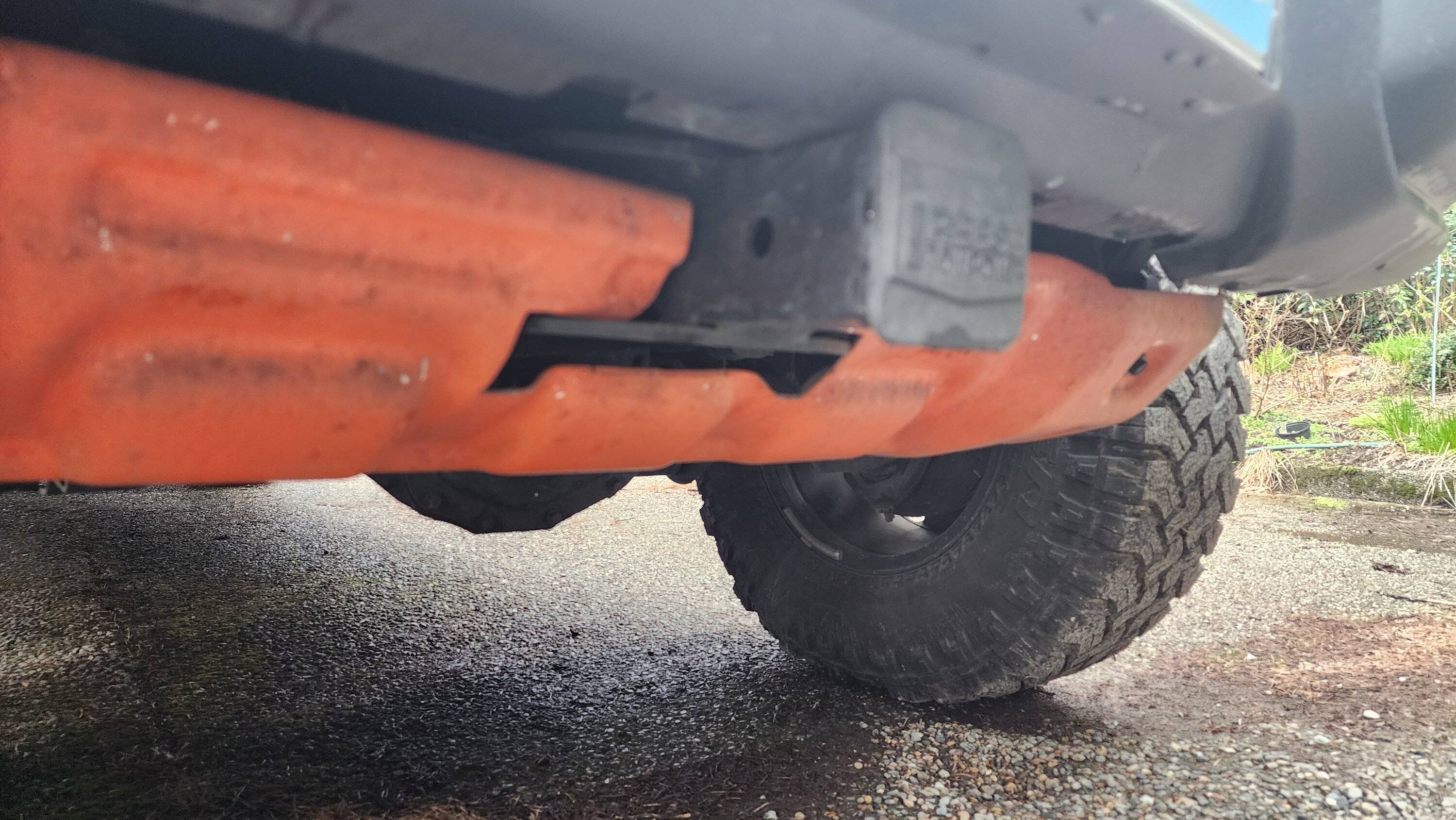

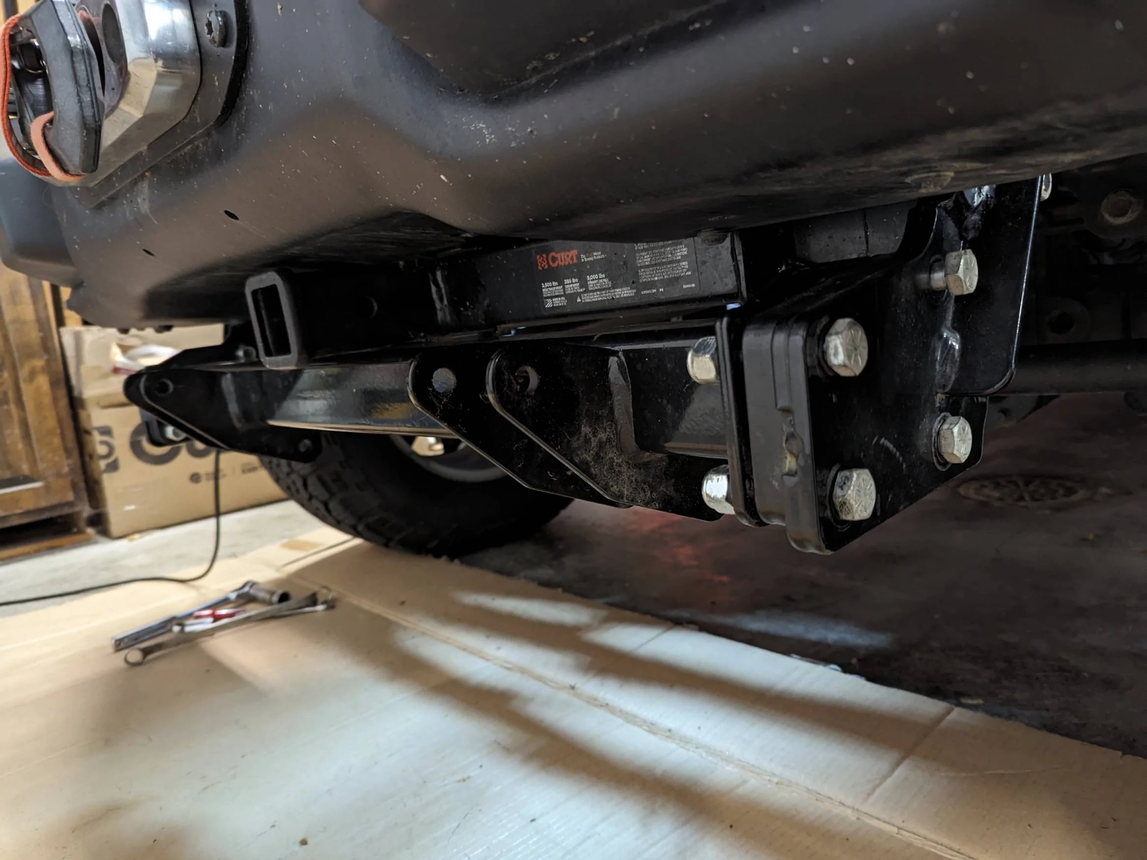

I mounted a Curt front receiver hitch on my '21 Mojave. I had to adjust the Hitch and resevoir mounts for mount bolt clearance then cut out the metal skid plate

Jeep Gladiator Why I could never run my snow plow on a Mojave PXL_20240229_174634303
Jeep Gladiator Why I could never run my snow plow on a Mojave PXL_20240229_174639607
Jeep Gladiator Why I could never run my snow plow on a Mojave PXL_20231013_190344575
Jeep Gladiator Why I could never run my snow plow on a Mojave 1709243424984
And Mojave -
Jeep Gladiator Why I could never run my snow plow on a Mojave PXL_20240229_174614439
Jeep Gladiator Why I could never run my snow plow on a Mojave PXL_20240229_174554471

It's been a couple years, but I mounted a Curt front receiver hitch on my '21 Mojave. I removed the reservoir mounts and "adjusted" the mounts with a grinder to allow the receiver hitch to mount to the correct locations. Itdidnt take too much adjustment and I felt the adjusted resevior mounts can still do their job. The reservoirs sit exactly where they came from the factory. I did this to use my warn M8000 front and back while keeping it in the covered bed (or garage) until needed. Should be suitable for a light weight snow plow...?
Jeep Gladiator Why I could never run my snow plow on a Mojave 20240304_151329
Jeep Gladiator Why I could never run my snow plow on a Mojave 20240304_151404

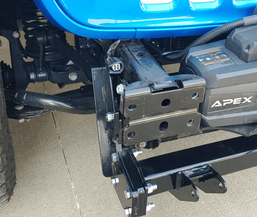

My snow plow mounts to the sides of the frame - (skid plate must be fully removed to have plow mounting bar on the truck)
Jeep Gladiator Why I could never run my snow plow on a Mojave 20221009_091506_HDR
Jeep Gladiator Why I could never run my snow plow on a Mojave 20221009_091452_HDR
Jeep Gladiator Why I could never run my snow plow on a Mojave 20221005_144917
Jeep Gladiator Why I could never run my snow plow on a Mojave 1709595410776
Jeep Gladiator Why I could never run my snow plow on a Mojave 1709595447670
Jeep Gladiator Why I could never run my snow plow on a Mojave 1709595499663
Jeep Gladiator Why I could never run my snow plow on a Mojave 1709595710102
