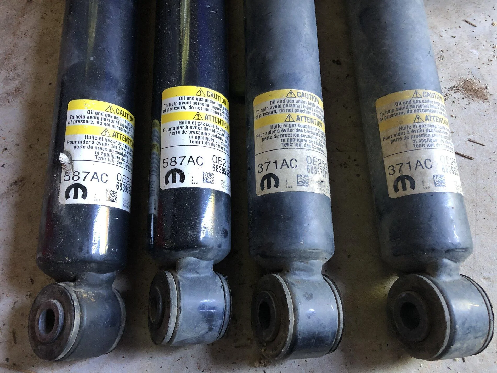

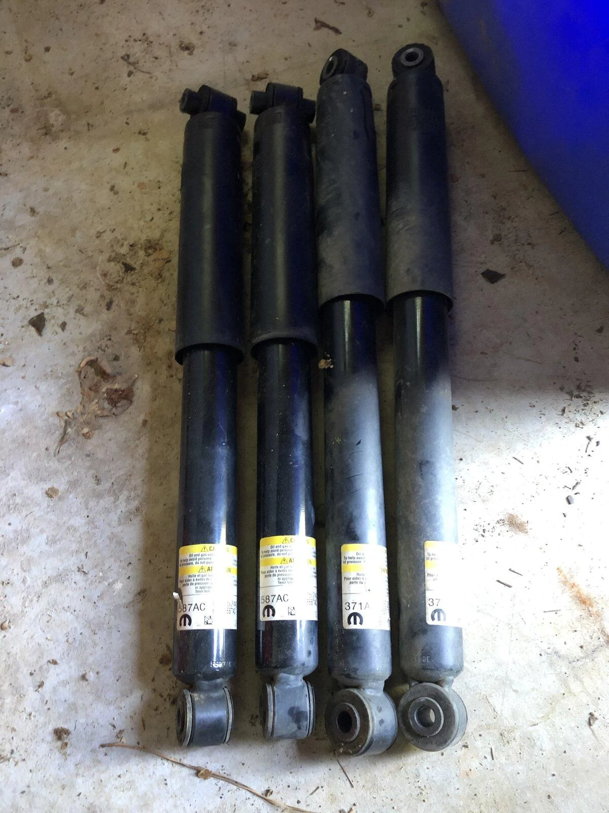

Thanks for the write up, much appreciated. Do you happen to have the max tow option on your sport? Or do you happen to still have the old shocks laying around and if so could you share the part numbers. I have noticed the same with my stock sport s with the max tow option with respect to the shocks not quite seeming to conrol the springs very well.
better late than never :) my oem sport s, no max tow
Jeep Gladiator My experience, OEM sport s shocks to Falcon SP2 2.1 FA766FC9-4CE8-4FE2-94AD-C88B96667366
Jeep Gladiator My experience, OEM sport s shocks to Falcon SP2 2.1 B775EBD2-D208-42B1-B623-3C6AE9E10BCB
