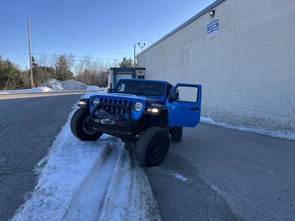

The XR has a 1.5 inch lift from factory, I added a 1 inch front spacer to hold the bumper/winch and remove the rake. I was running the longer shocks for the 2+ lift or whatever the spec was. The fronts were right under the length where a new driveshaft is recommended.
Jeep Gladiator Falcon SP2 2.1 long term experience anyone? 1744502396241-oa
Jeep Gladiator Falcon SP2 2.1 long term experience anyone? 1744502432670-l7
Had more room to flex here but I hadn't changed out the sway bar links to the Mopar lift kit links yet and wasn't sure how far to push it. Once I did swap the longer links in and flexed it fully the springs were just at a point where they were barely loose, it worked out well. Sorry but no good pics of that.
