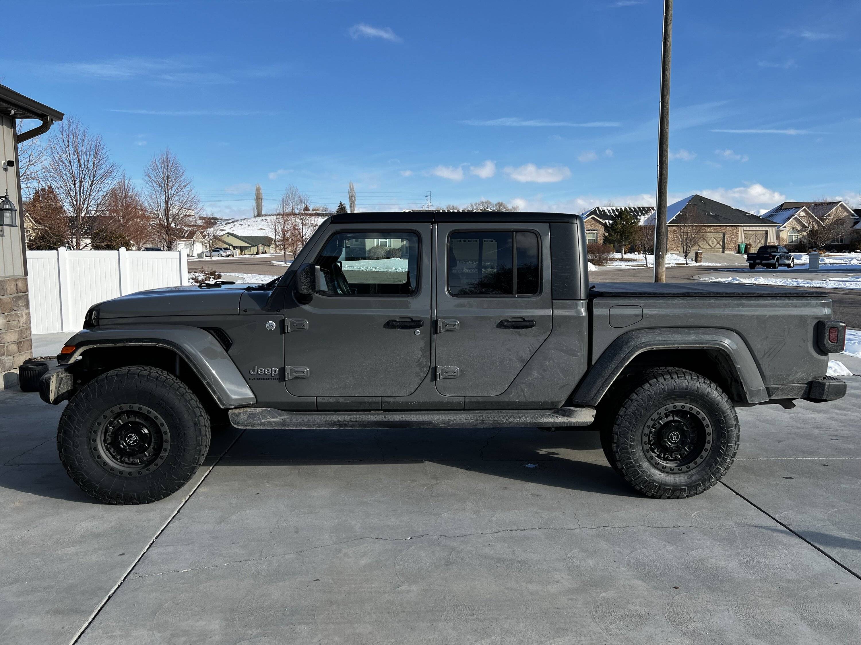

Mine is my daily driver and I’ve done some blm roads and camping. I have the BDS 2” leveling kit and run 35’s and I don’t have any rub. Maybe down the road I’ll lift it more, but for now, for the money and my uses this is perfect.

Your rig looks great! Same color and general plan.

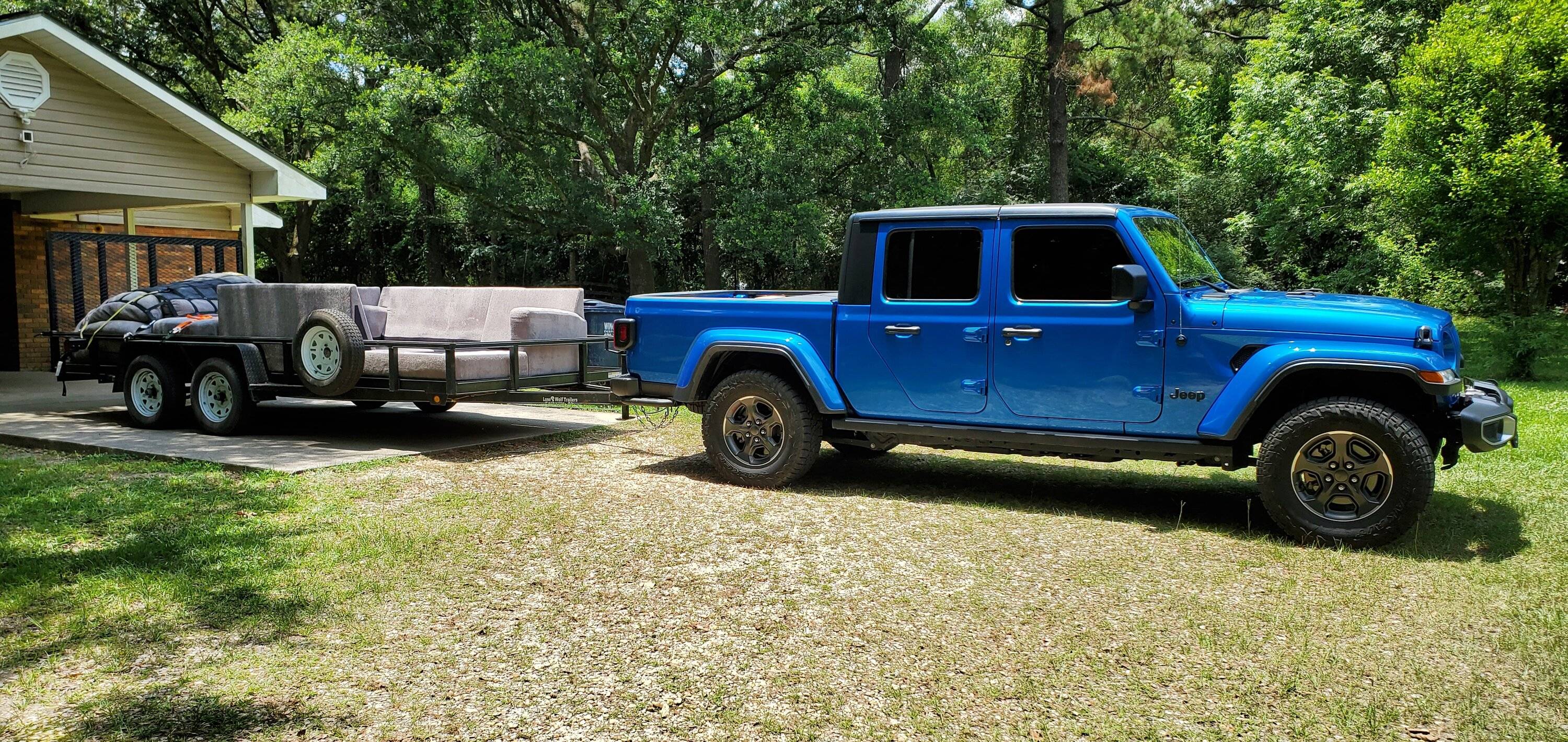

My truck with a 1.5" Teraflex spacer up front. Not too bad.
