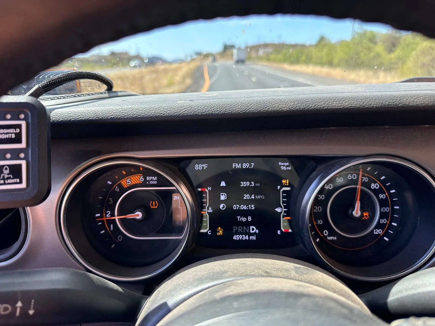

Speedo is accurate to within 1 mph.
19.7 is what I calculate. The full to bone dry empty range is ~ 530 miles at 72mph

Seen your build on Reddit as well. Really looking forward to more details on your fuel tank.
when its ready for sale ill make sure to post in here for ya bud. So far it seems to be 7/8s when full and it holds a while at 1/4 tank. We believe thats because of the 7 gallon discrepancy stock vs fuel cell. The gasser will probably be exactly accurate
