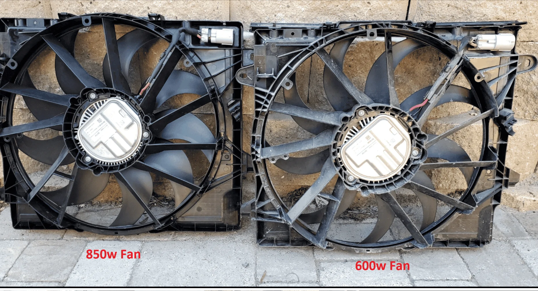

The fan is for increased cooling capacity. 850 versus 600 watts. The blades are much wider, I am sure the CFM change is large. It will pull a hell of a lot more air through the radiator fins. The alternator is needed since the fan greatly increases the amperage draw enough where Jeep doesn't feel the base alternator is good enough.
At 12vDC:
600w: 50 amps
850w: 70 amps
Better air movement is essential when traveling in hot climates, or in the desert/dunes.

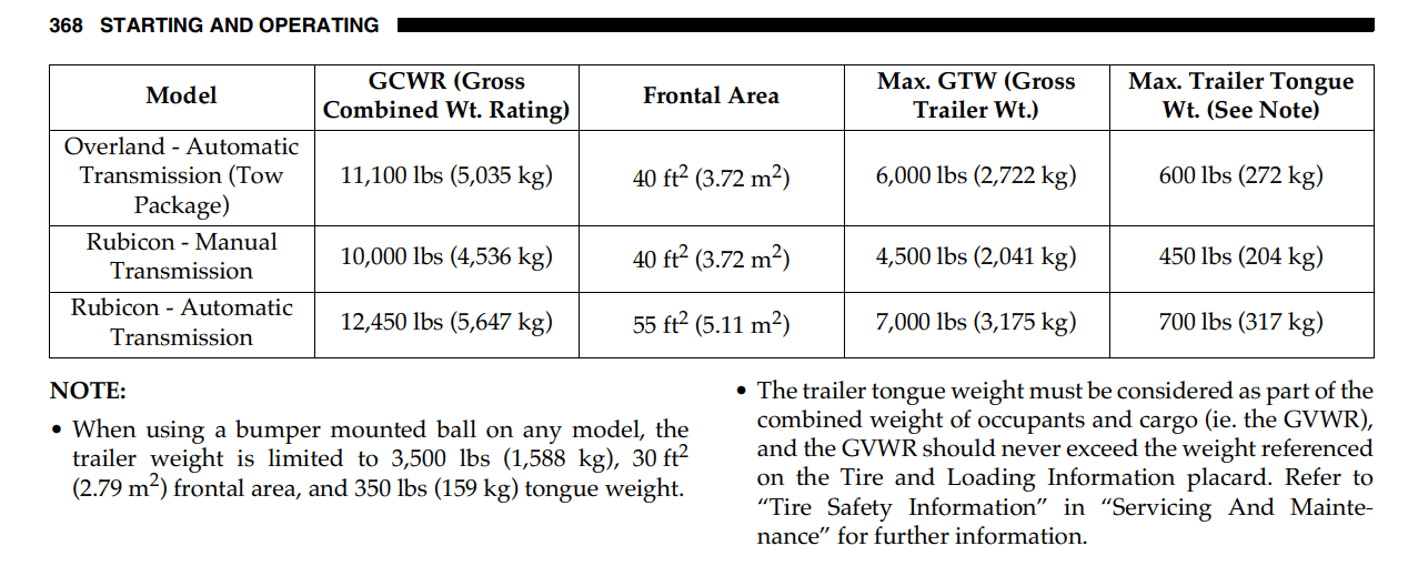

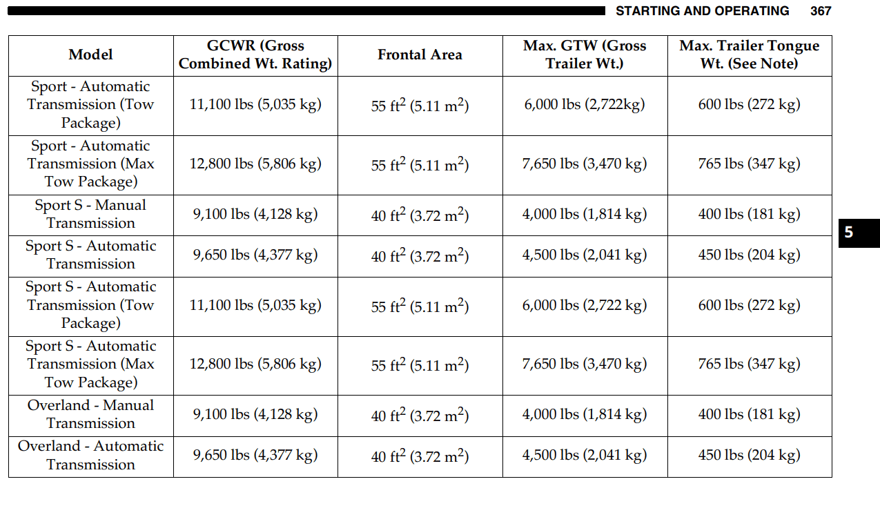

Trailer Towing Weights (2021 OM)
Model *GCWRMaximum GTWMaximum Trailer TW
Sport MT9,100 lb (4,128 kg)4,000 lb (1,814 kg)400 lb (181 kg)
Sport AT9,650 lb (4,377 kg)4,500 lb (2,041 kg)450 lb (204 kg)
Diesel Sport AT12,100 lb (5,488 kg)6,500 lb (2,948 kg)650 lb (295 kg)
Sport AT (Tow Pkg)11,100 lb (5,035 kg)6,000 lb (2,722kg)600 lb (272 kg)
Diesel Sport AT (TP)12,100 lb (5,488 kg)6,500 lb (2,948 kg)650 lb (295 kg)
Sport AT (Max Tow)12,800 lb (5,806 kg)7,650 lb (3,470 kg)765 lb (347 kg)
Sport S MT9,100 lb (4,128 kg)4,000 lb (1,814 kg)400 lb (181 kg)
Sport S AT9,650 lb (4,377 kg)4,500 lb (2,041 kg)450 lb (204 kg)
Diesel Sport S AT12,100 lb (5,488 kg)6,500 lb (2,948 kg)650 lb (295 kg)
Sport S AT (TP)11,100 lb (5,035 kg)6,000 lb (2,722 kg)600 lb (272 kg)
Diesel Sport S AT (TP)12,100 lb (5,488 kg)6,500 lb (2,948 kg)650 lb (295 kg)
Sport S AT (Max)12,800 lb (5,806 kg)7,650 lb (3,470 kg)765 lb (347 kg)
Overland MT9,100 lb (4,128 kg)4,000 lb (1,814 kg)400 lb (181 kg)
Overland AT9,650 lb (4,377 kg) 404,500 lb (2,041 kg)450 lb (204 kg)
Diesel Overland AT12,100 lb (5,488 kg)6,500 lb (2,948 kg)650 lb (295 kg)
Overland AT (TP)11,100 lb (5,035 kg)6,000 lb (2,722 kg)600 lb (272 kg)
Diesel Overland AT (TP)12,100 lb (5,488 kg)6,500 lb (2,948 kg)650 lb (295 kg)
Mojave MT9,900 lb (4,491 kg)4,500 lb (2,041 kg)450 lb (204 kg)
Mojave AT11,450 lb (5,194 kg)6,000 lb (2,722 kg)600 lb (272 kg)
Rubicon MT10,000 lb (4,536 kg)4,500 lb (2,041 kg)450 lb (204 kg)
Diesel Rubicon AT11,800 lb (5,352 kg)6,000 lb (2,722 kg)600 lb (272 kg)
Rubicon AT12,450 lb (5,647 kg)7,000 lb (3,175 kg)700 lb (317 kg)
For the Rubicon and Mojave, there is no distinction between with or without tow package, only the trans. For that reason, a NON tow package Mojave is rated 4500 manual trans 6000 auto trans. With tow package? The same.
I have Max Tow Sport and it’s rated 7650

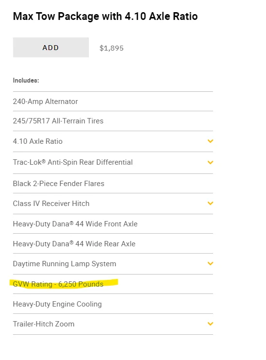

Current build option just calls it the tow package.. But it has supposedly better cooling By " heavy duty engine cooling"... 100% false advertising... Even on the sport s where max tow is shown, it still has the generic "heavy duty cooling" so probably all the same on the cooling front regardless of package.
Negative, I have 2020 Max Tow Sport and has the larger Alt and fan
