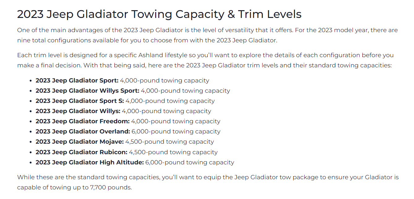

So this one I’m looking at has a class 2 hitch rated at 3500 lbs but I have seen where Mojave with no max tow is 4500. Class 4 is rated for 10,000lbs but I think the Mojave with tow package can tow 6500lbs. Seems like this is sadly a no go
Mojave can't have Max Tow. The only 4500lb rating I can find for Mojave is manual trans. Autos are 6000.
No Gladiator period is rated for 10,000. The highest is 7650 on a Sport S with Max Tow option.

The thing is, with the Mojave, only 2 ratings are listed:
MT: 4500
AT: 6000
There is no separate "with" and "without" tow package on this trim like there is for Sport and Overland.
There is nothing on the door sticker. So - this leads me to believe the tow package does not increase the tow rating for the Mojave, so he'd be fine, up to the rating for the transmissions given.
