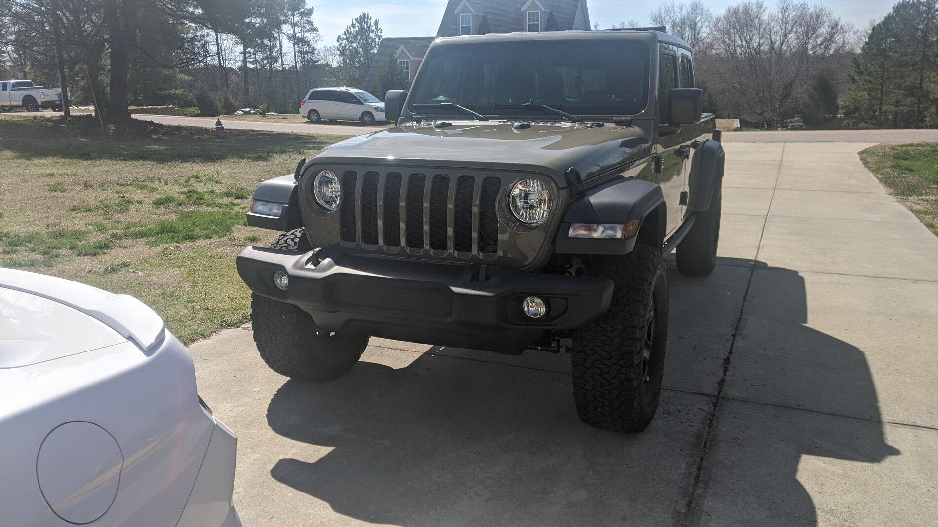

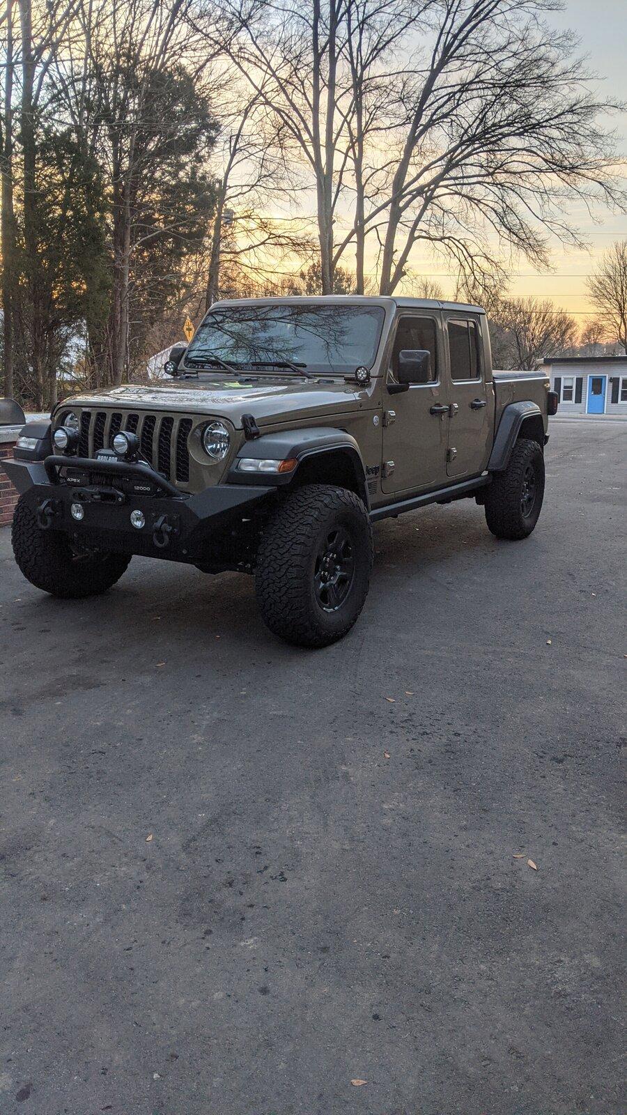

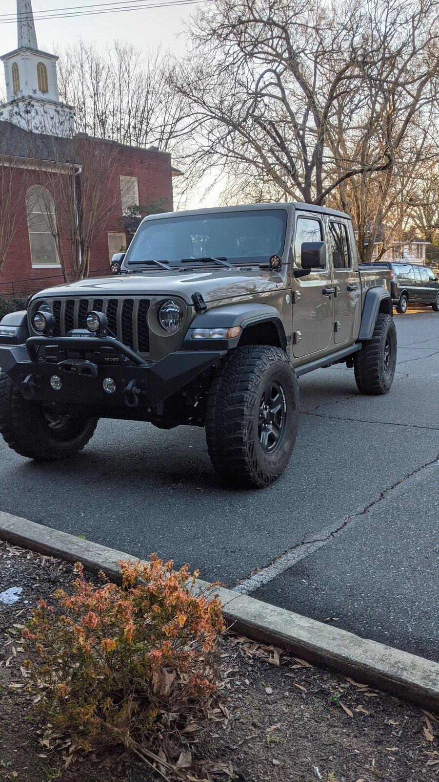

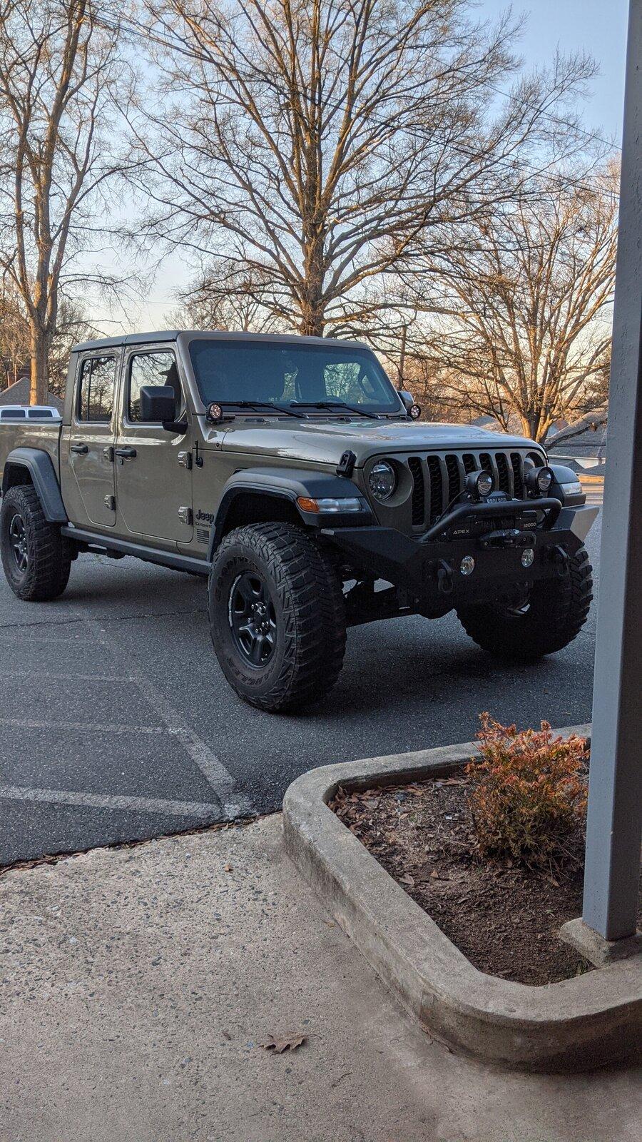

I had 315 70 17 BFG KO2S and January moved up to 37 12.5 17 Goodyear Kevlar MTRs. I'll say this I love the look of the 37's but I'll probably buy a set of A/T's in 37 when I wear out these MTRs. I love how the MTRs look but coming from the BFG KO2s to something like the MTRs you notice a difference in the ride quality. I'm going to put on some Geo Brackets and a adjustable Track bar to see if that helps. Also mpg wise I'm at 16.5 right now and I was at about 18.5 on the BFGs but that's expected when going up in size. I'll see if the MPGs get any better or worse as I drive it more. Here's some pictures of both
315 70 17 BFG Ko2s stock wheels with 1.75" wheel spacers and Rubcion Suspension front springs and 2.5" ReadyLift
Jeep Gladiator Need advice - Best "upgraded" tire size on stock Sport S rims? PXL_20201219_123537613
Everything the same on 37 12.5 17 Goodyear MTR's
Jeep Gladiator Need advice - Best "upgraded" tire size on stock Sport S rims? PXL_20210221_124427553

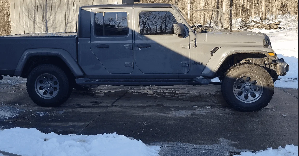

Loving the photos everyone. When I do eventually upgrade I'm thinking i'll be going 33"-34" (either Falken ATW3 or Toyo AT3) and either a 1.5" / .75 level or the Clayton 2.5" RideRight depending on fit. I won't be offroading so I don't need to go huge - but I do want to make sure everything fits.
Playing with my budgeting spreadsheet I've realized this is an expensive hobby to get into XD (And I'm loving my first Jeep!)

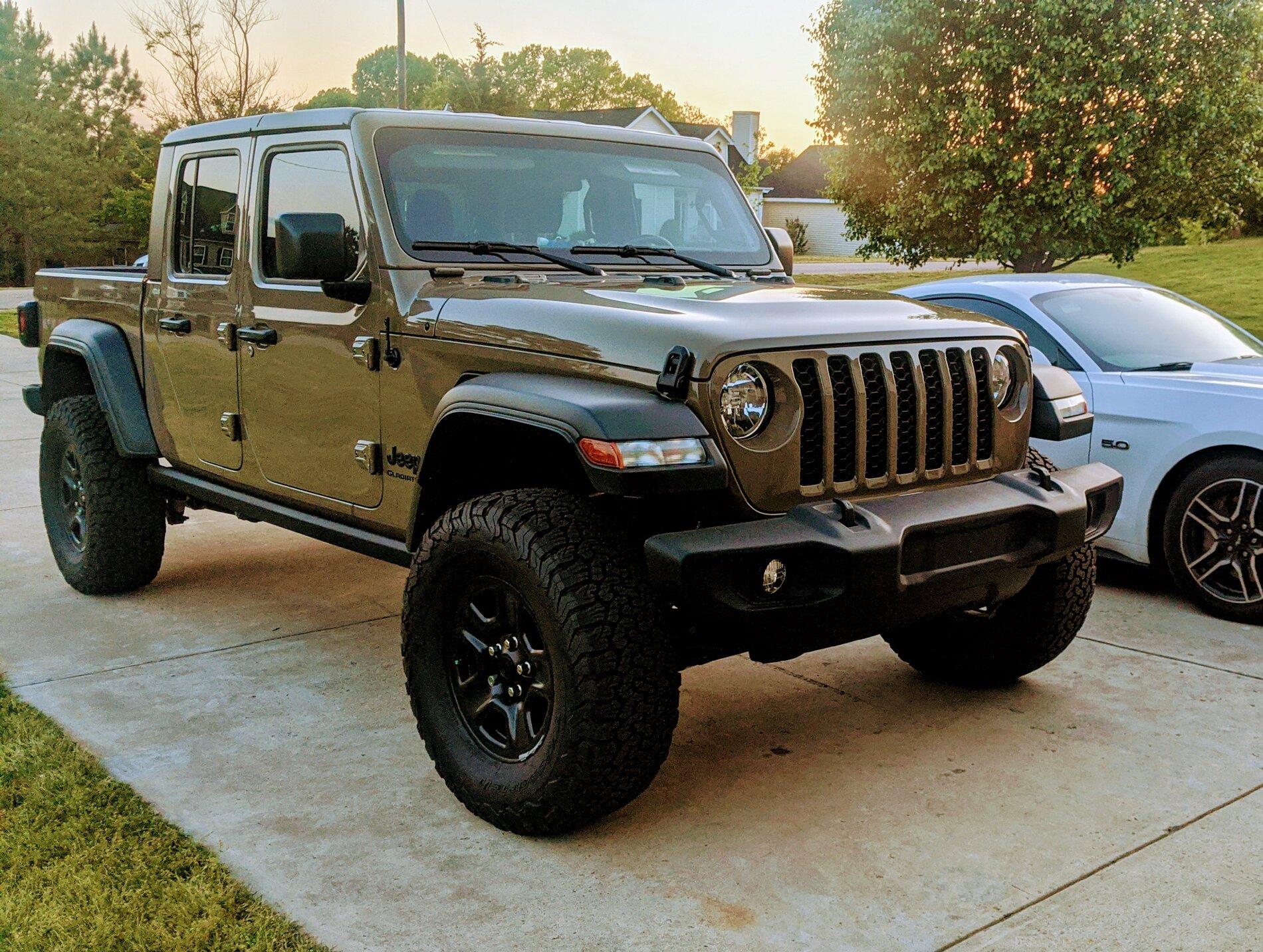

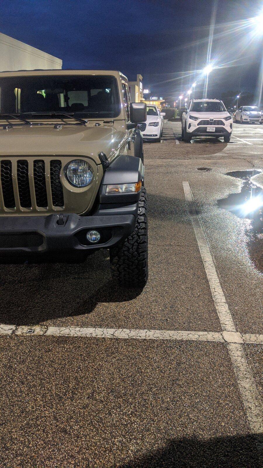

I went with the Falken AT3's in 255/80-17 (33.1x10.5) and a Rancho Level It kit up front:
Jeep Gladiator Need advice - Best "upgraded" tire size on stock Sport S rims? Annotation (34)

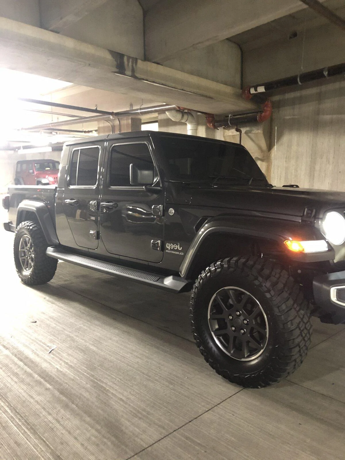

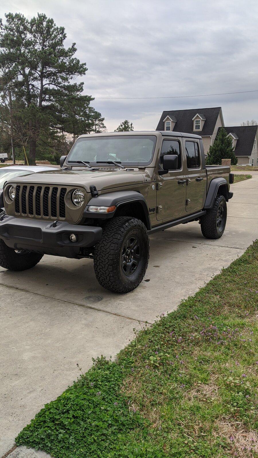

Went with 2.5in Rough country leveling kit (coil springs) 1.75in wheel spacers, and 35in BFG km3. May remove spacers in future to see how it looks. ??‍♂
Jeep Gladiator Need advice - Best "upgraded" tire size on stock Sport S rims? 55530731-B3B6-466F-A4BE-2542D30973A1
Jeep Gladiator Need advice - Best "upgraded" tire size on stock Sport S rims? F8F5893E-AE26-4EBD-85A6-FBBDE9A875ED
Jeep Gladiator Need advice - Best "upgraded" tire size on stock Sport S rims? 3BECAC36-7E54-41AB-A362-C04A4622FD4A

Lift and tires look awesome! Ive never been a fan of an aggressive bull dog look personally. I have 1/4in spacers on my wheels now which gave me a little tire peeking out. I have 1/2in once sitting at the house, just haven't stuck them on.
Thank you man! Yea I’m in the same boat, some angles it looks great some angles they stick out too much. Going to take them off here soon and see how they look/ride. Plusssss they sling up everything on the side of the truck lol

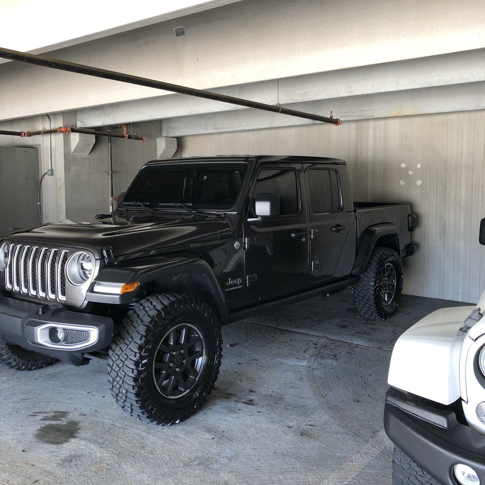

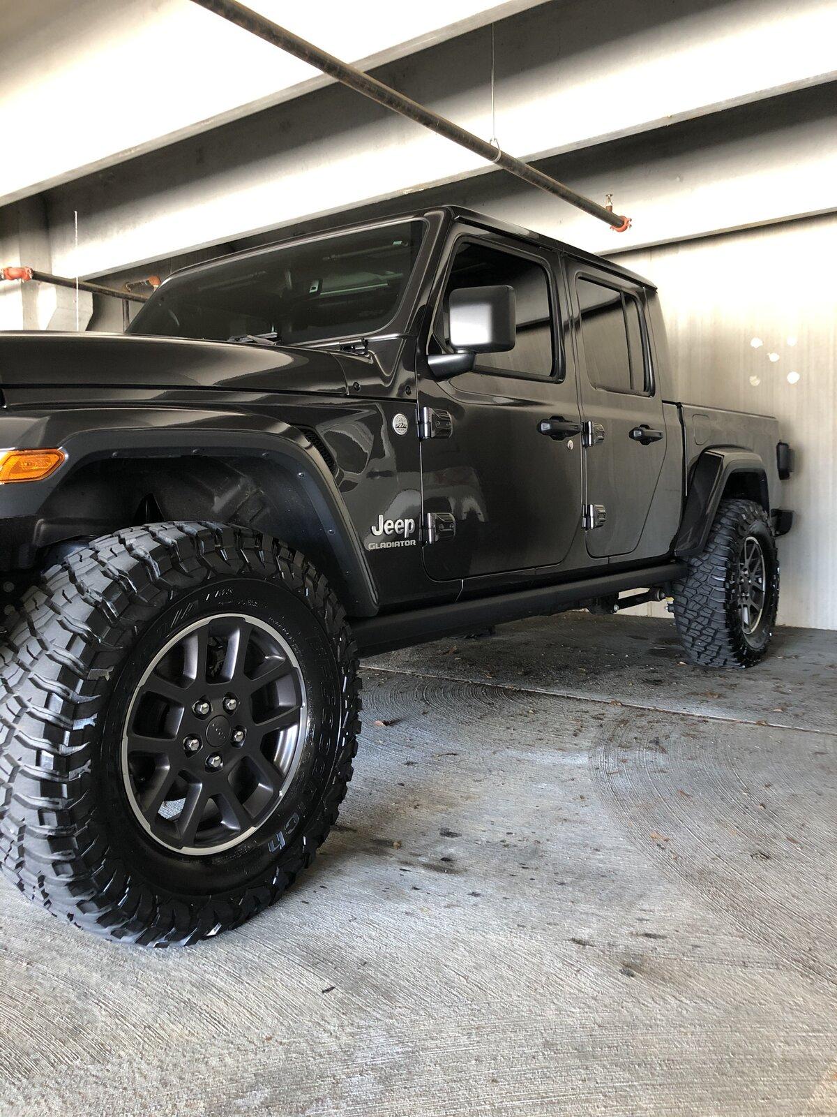

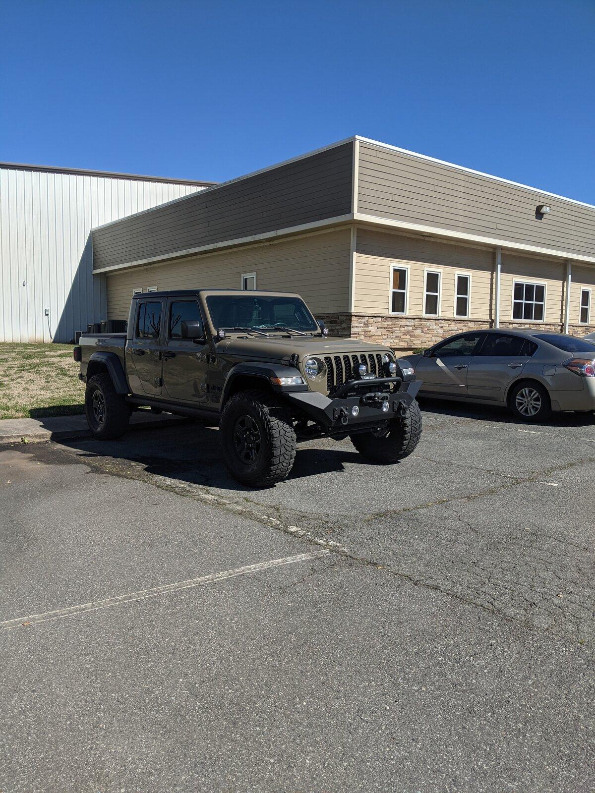

Looks good, do have a Max Tow or Regular sport/Overland because if you remove the wheel spacers on a regular sport or overland with stock wheels you will hit the lower control arms at full lock. Here is a idea of what it would look like with spacers removed and installed. I'm running 1.75" spacers on mine with a 2.5" ReadyLift also was running BFG KO2S in a 35 before going to the 37's included some pics for your reference
No lift no wheel spacers
Jeep Gladiator Need advice - Best "upgraded" tire size on stock Sport S rims? IMG_20200213_183121
Jeep Gladiator Need advice - Best "upgraded" tire size on stock Sport S rims? IMG_20200213_183153
With 2.5" ReadyLift and no wheel spacers
Jeep Gladiator Need advice - Best "upgraded" tire size on stock Sport S rims? MVIMG_20200315_104758
Jeep Gladiator Need advice - Best "upgraded" tire size on stock Sport S rims? MVIMG_20200308_120959
With 2.5" ReadyLift and 1.75" wheel spacers which you already know
Jeep Gladiator Need advice - Best "upgraded" tire size on stock Sport S rims? IMG_20200411_195801
2.5" ReadyLift, Rubicon Take off front springs, 1.75" wheel spacers and Goodyear MTR 37 12.5 17 tires
Jeep Gladiator Need advice - Best "upgraded" tire size on stock Sport S rims? PXL_20210224_182008948
Jeep Gladiator Need advice - Best "upgraded" tire size on stock Sport S rims? PXL_20210221_124411601

Thanks for the detailed response!! Your tires don’t look like they stick out as wide as mine do, maybe it’s just me haha. My gladiator is one big optical illusion. From one angle it has some squat, other angle it’s nose diving.. tires look big up close, look stock at 20 yards away hahahah. What am I to do ??‍♂
Yours looks great man! I need 37s ?

Yeah I thought my 35's looked big until I went up to 37's, now I'm hooked. I get what you sayin though 100%, feel the same way about mine. Every angle looks different, worst angle is looking at it from the rear, I'm still trying work on that. I almost got it where I want it at right now though with the overall look.
