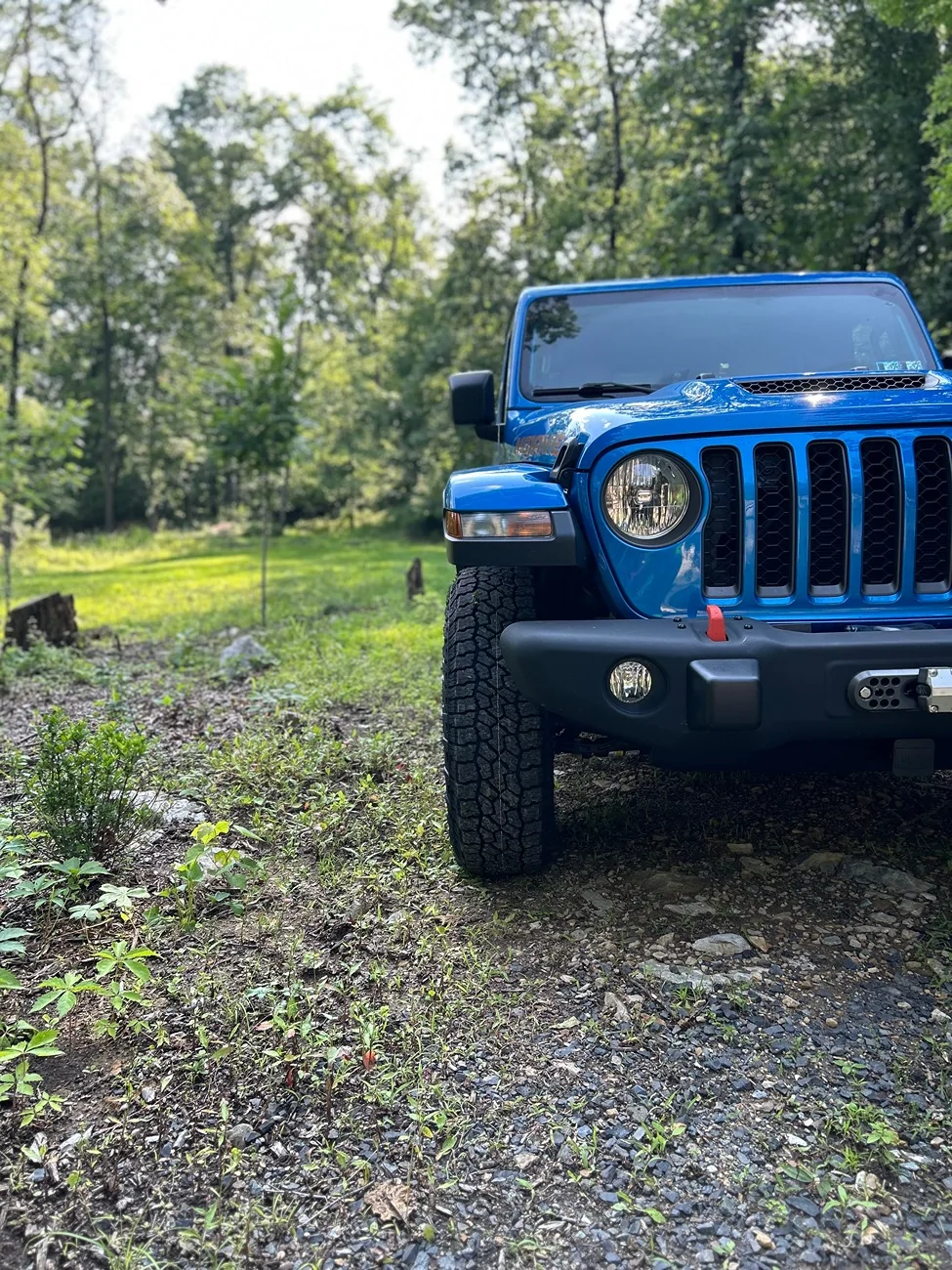

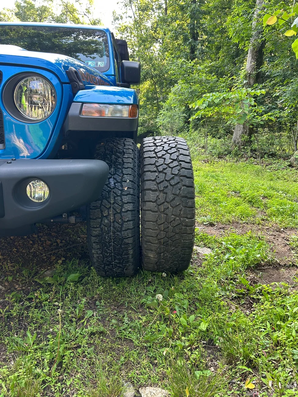

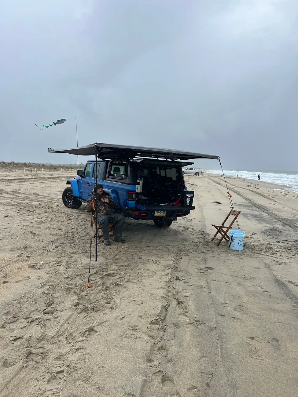

I went with the 255/80/ 17 AT4 and love them they are 33.3” tall compared to stock 32.5, I run a Mojave go off roading and surf fish driving on beaches. They a little bit lighter but a better tire then the AT3 and have a 60,000 warranty . Your biggest problem is you have a mud tire instead of a AT tire for your needs, my Original tires got noisy around 45,000 and I wanted to go skinny. The steering has changed a lot to a easier feel, I saw no difference in the woods and I think they are better on the beach , by being narrower they are not pushing as wide of little wall of sand in front when driving. They will be better in snow in a couple months too!..Jack
Ps: I know everyone says wider is better but since 1976 I have been running the beaches with everything from a CJ-2A on 11x15 , Scrambler, Tahoe’s, Suburban, Chevy pickups , even a 1984 small Wagoneer , my Mojave had widest tires of them all and is the only truck I got stuck with and that was at low pressure , ran my Suburban for eight years 25psi front, 20psi rear and never a worry , enjoyed driving around stuck trucks and pulling them out
