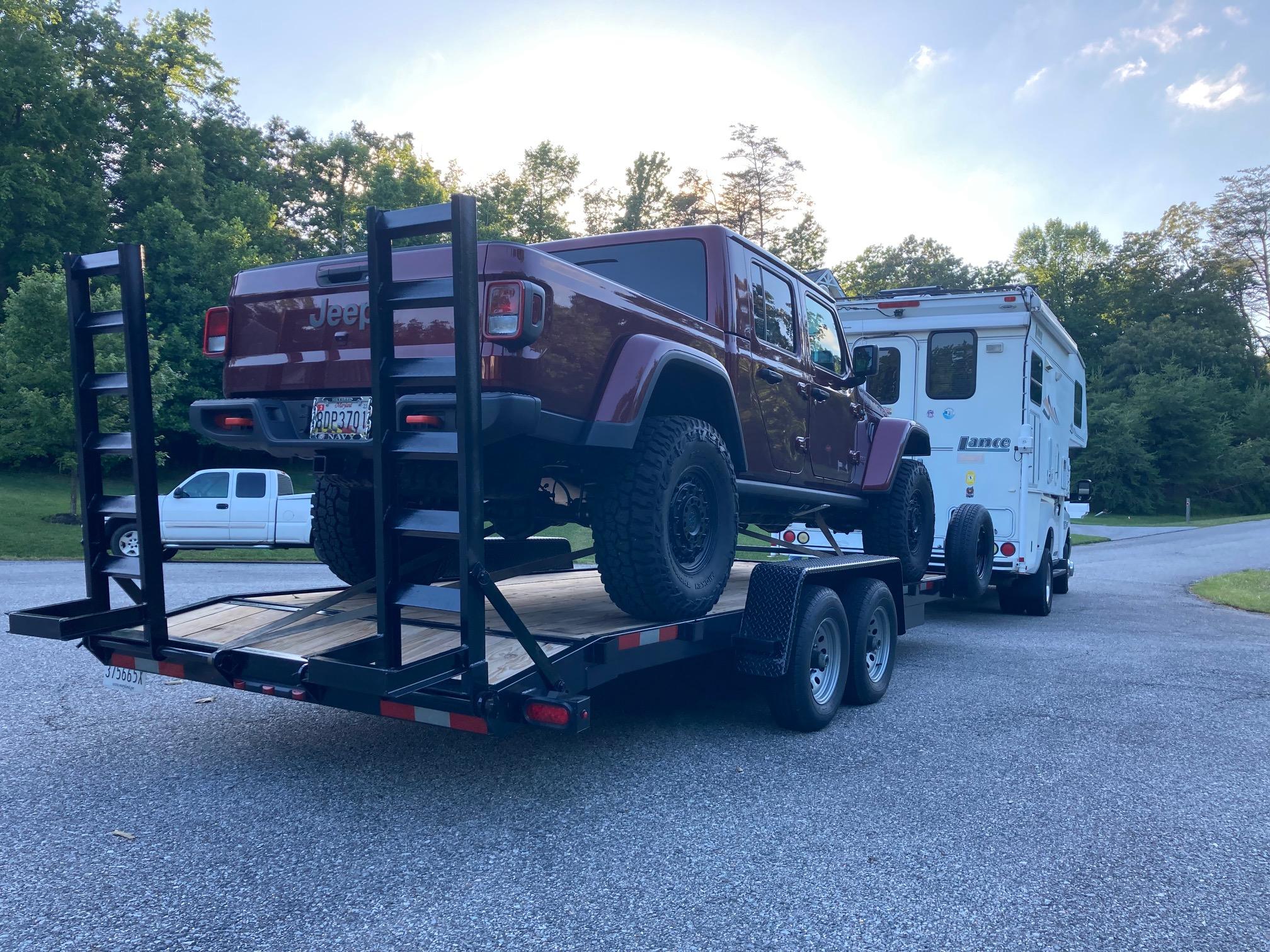

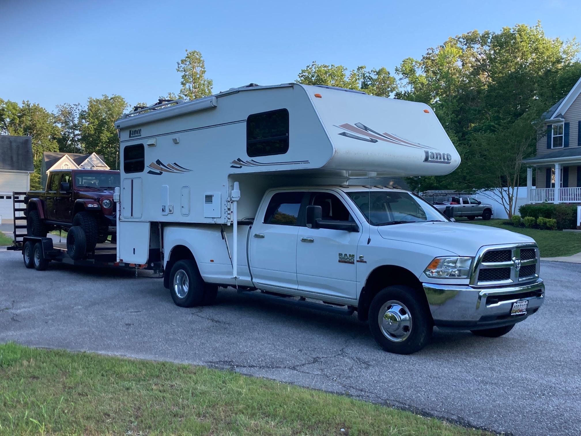

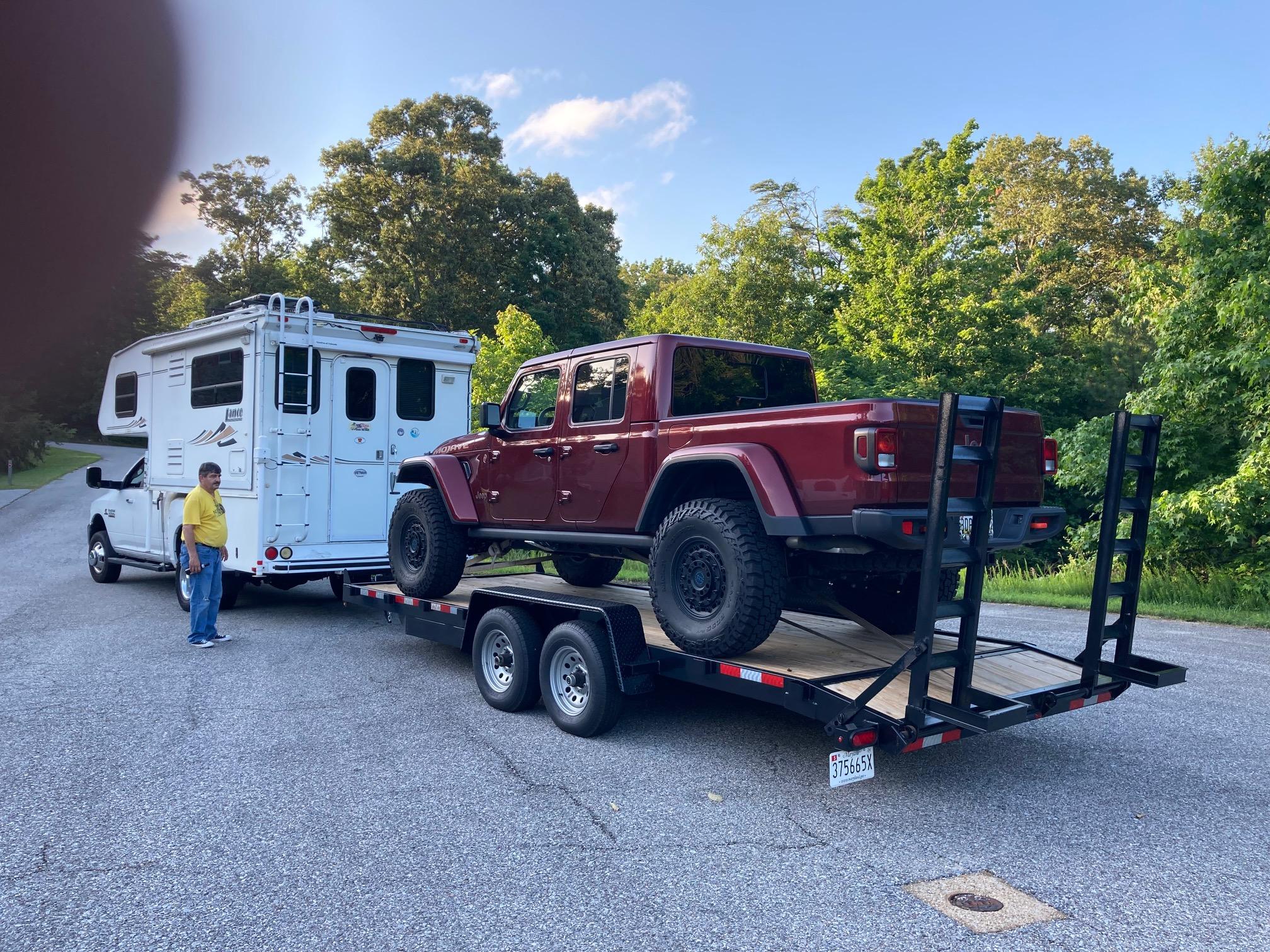

My background of building Jeeps fulltime for a living dates back to 1977 when I first started working at Rancho. After Rancho, I worked for Mickey Thompson and a number of other offroad and custom shops for decades.
I will be going into fulltime retirement soon. Several of my friends and previous Jeep builders are retired and spend several months a year (8-10 months) off roading. That'll be what I do soon.
Knowing where I'll be wheeling several months a year required a certain level of build to include reliability. So I went mild with a set of 37's & small lift on my Mojave. Deep gears, locked F&R, armored, Atlas 5.0 etc is minimal for where I'll frequently be. I'll mostly be in the southwest (Johnson Valley, Ocotillo, Corral Canyon, Superstition, Anza Borrego, Moab, AZ, Table Mesa, Sonora, Martinez Canyon, CO, Billings Canyon, 21 Road, NV etc).
For the serious stuff, I'll mostly use my 1 ton YJ that's on 39" stickies. The JT will be used for most anything else. Both will be trailer queens that I'll pull behind my dually CTD with a Lance camper.
I have a Honda 700 SxS and Yamaha Kodiak 700 Quad as well for hunting duties that I'll bring on the trailer too from time to time. I have a 16' Tracker bass boat for days I don't go wheeling.
