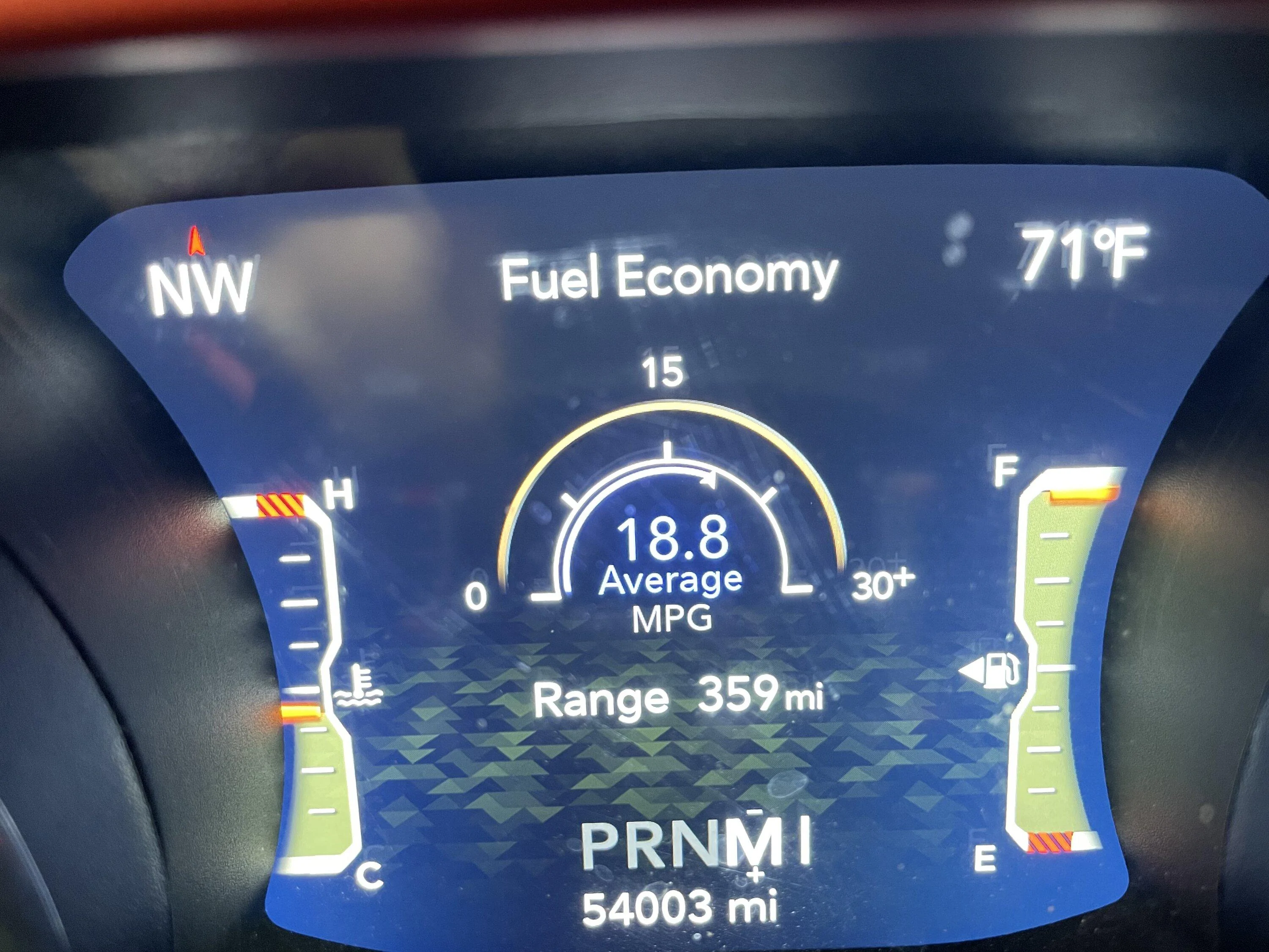

That’s impressive, mine with 35s doesn’t do that well empty or towing.
Maybe is primarily driving on flat ground for me. I’m also told I’m old and drive like an old man by my grown children. No jackrabbit starts or hard braking. Ive adjusted tire size to 39.75 (actual size) on superchips flashcal then double checked speedo with gps.

Maybe its a miles thing...She gets better with a bit of mileage under the belt
