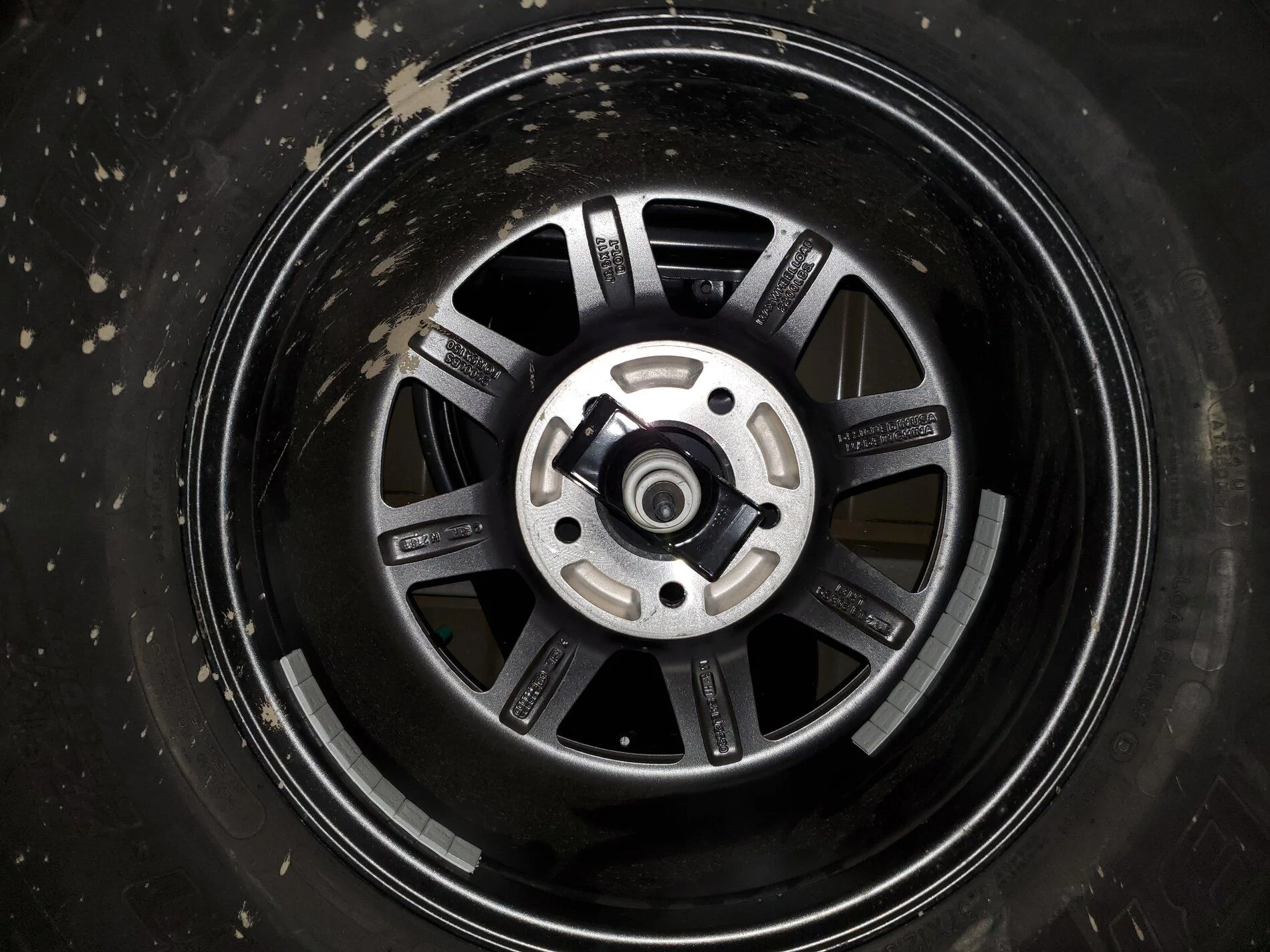

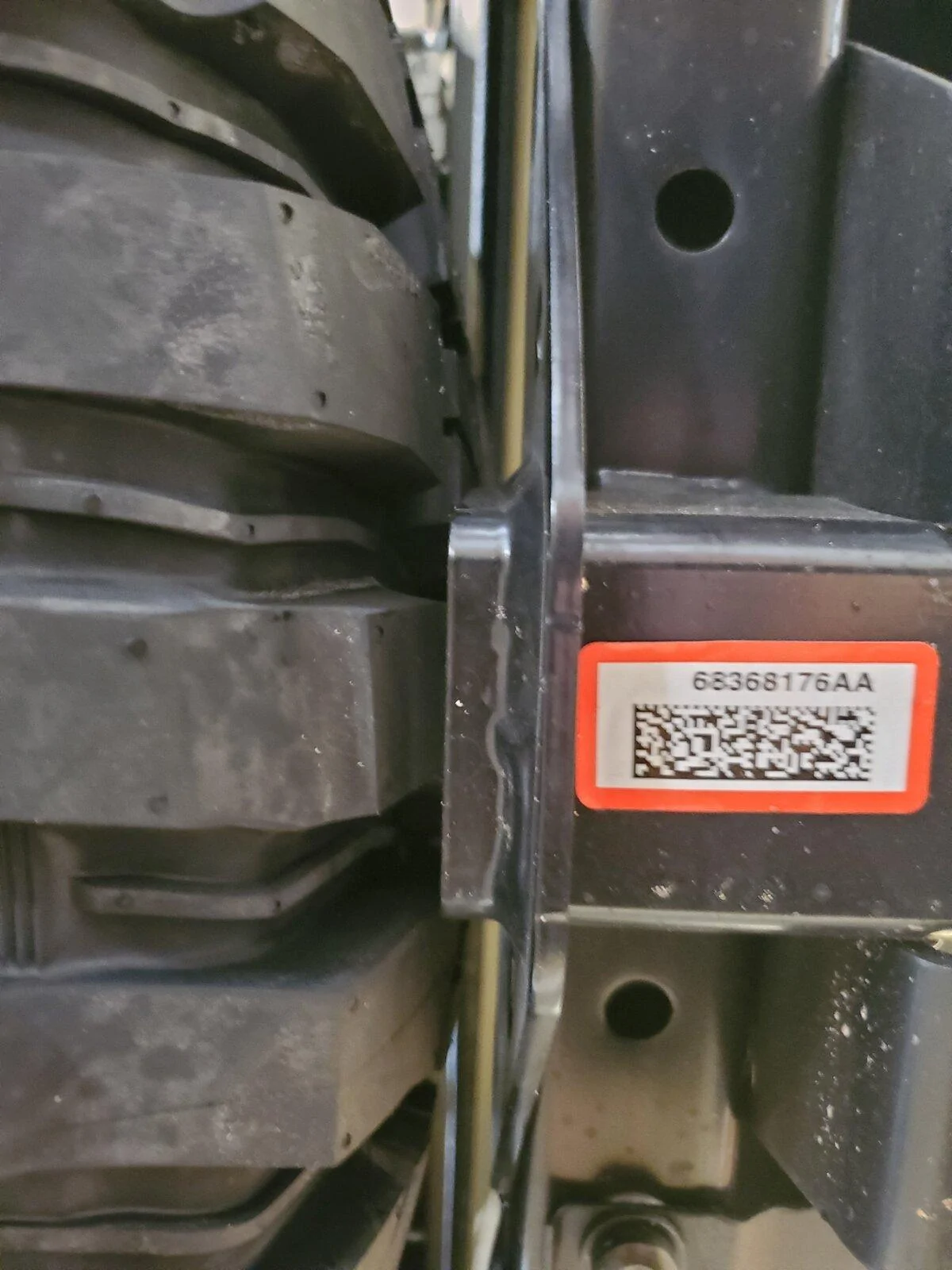

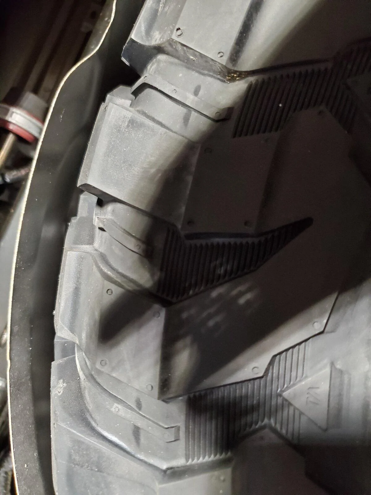

Sure do. 17 x 8.5 with 4.5 bs. Not much room for more, but my setup fits.
Jeep Gladiator Tire size of spare 20210111_100836

I run 37" BFG KM3's with the exact same rim as my spare, YES it does fit fully inflated. BFG's are one of the smaller 37's out there but before that I fit a fully inflated Ironman 37" in there. It does fit but it is super tight. I like having the exact same spare tire & wheel so it doesn't affect my day when I'm wheel'n off road and I need to use it. I know guys who run a donut spare just to get them home but I don't see the point if you can't keep on hav'n fun on the trail. We aren't driving minivans!
