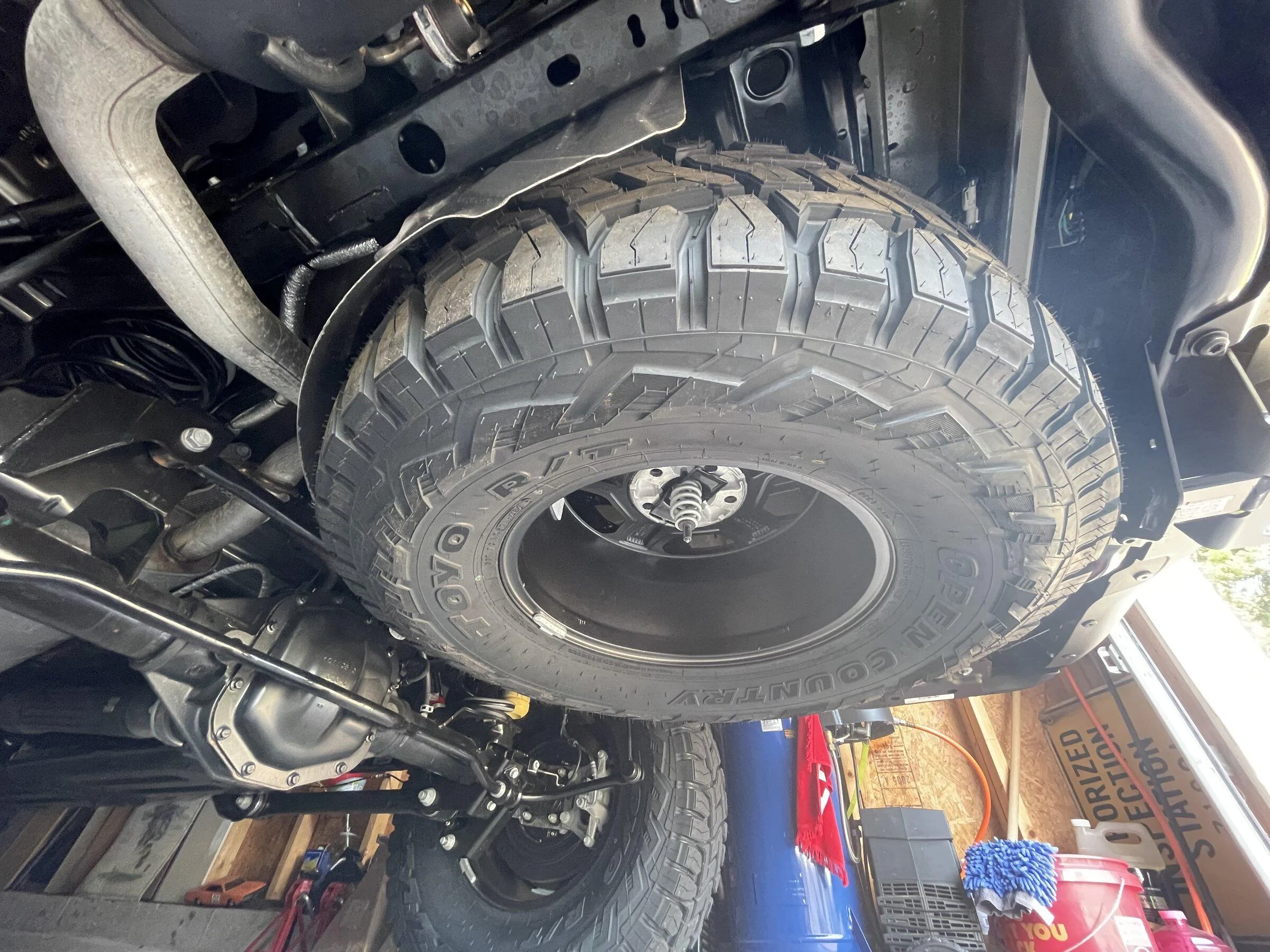

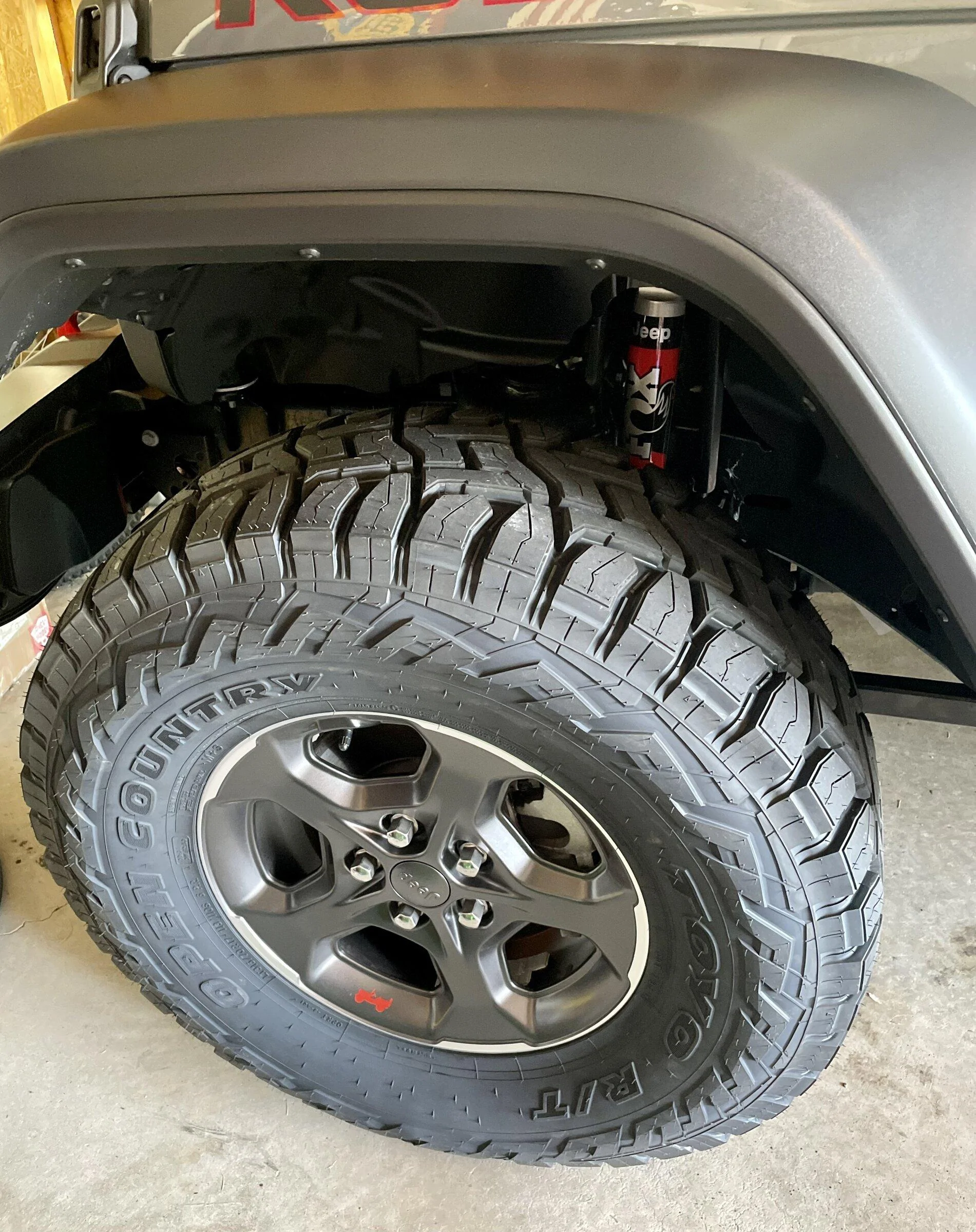

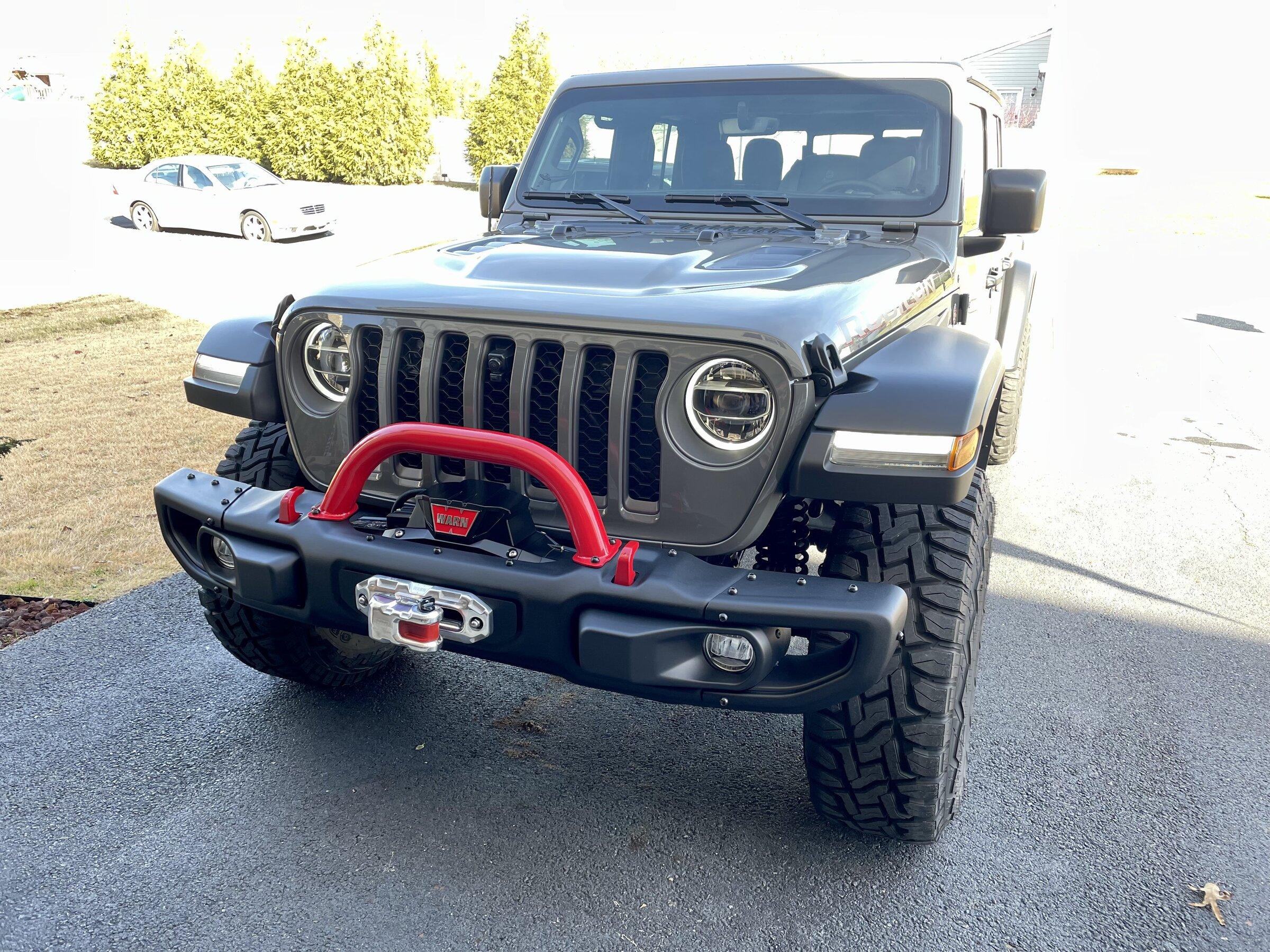

You’ve got to do what’s best to suit your needs and ignore anyone telling you that you’ve gotta have 37’s, 40’s, whatever to be happy.

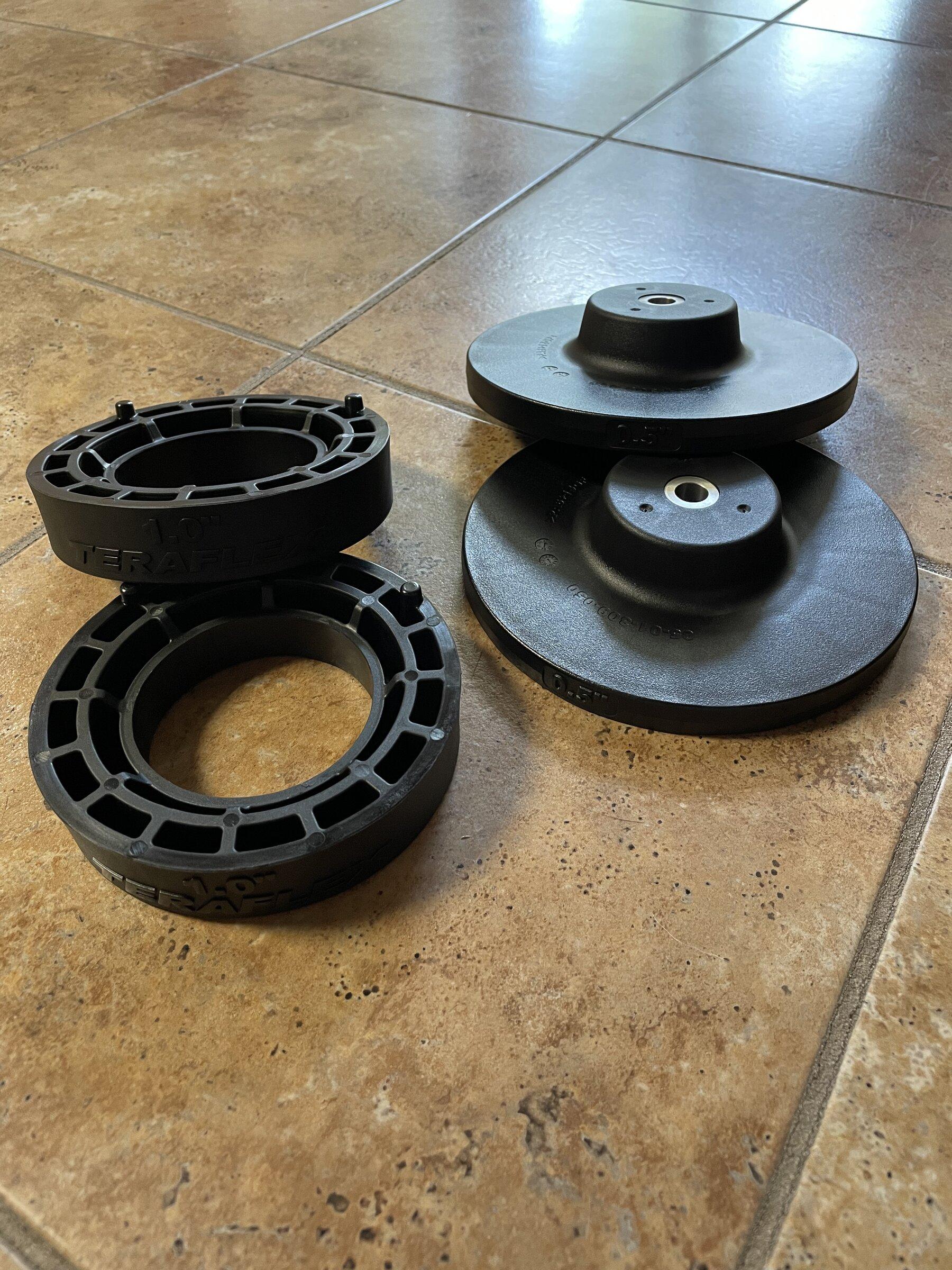

I’ve gone with a 1” front, 1/2” rear teraflex spacer. 315/70’s C load rated (34.5”?) on stock wheels. It’s a good slightly off-stock solution for me. With the 4.10’s, the acceleration and fuel economy difference is negligible.
37’s on the Mopar lift would be great, but it’s more important for me for it to still fit in the garage. In addition, they would make getting in and out for the wife and daughter even more difficult than it already is. 35”ish tires still fit under the bed for a matching spare. Finally, none of these minor mods I’ve completed are going to cause any significant premature wear.
What would I change? Perhaps installing both the 1” and .5” spacers up front instead of just the 1”. I lost about half an inch with installation of the steel bumper, winch and winch plate. However, at this point I don’t think it would be worth disassembly for just .5”. We’ll see how it sits once I install my rack & RTT.
How are those Toyo RTs?

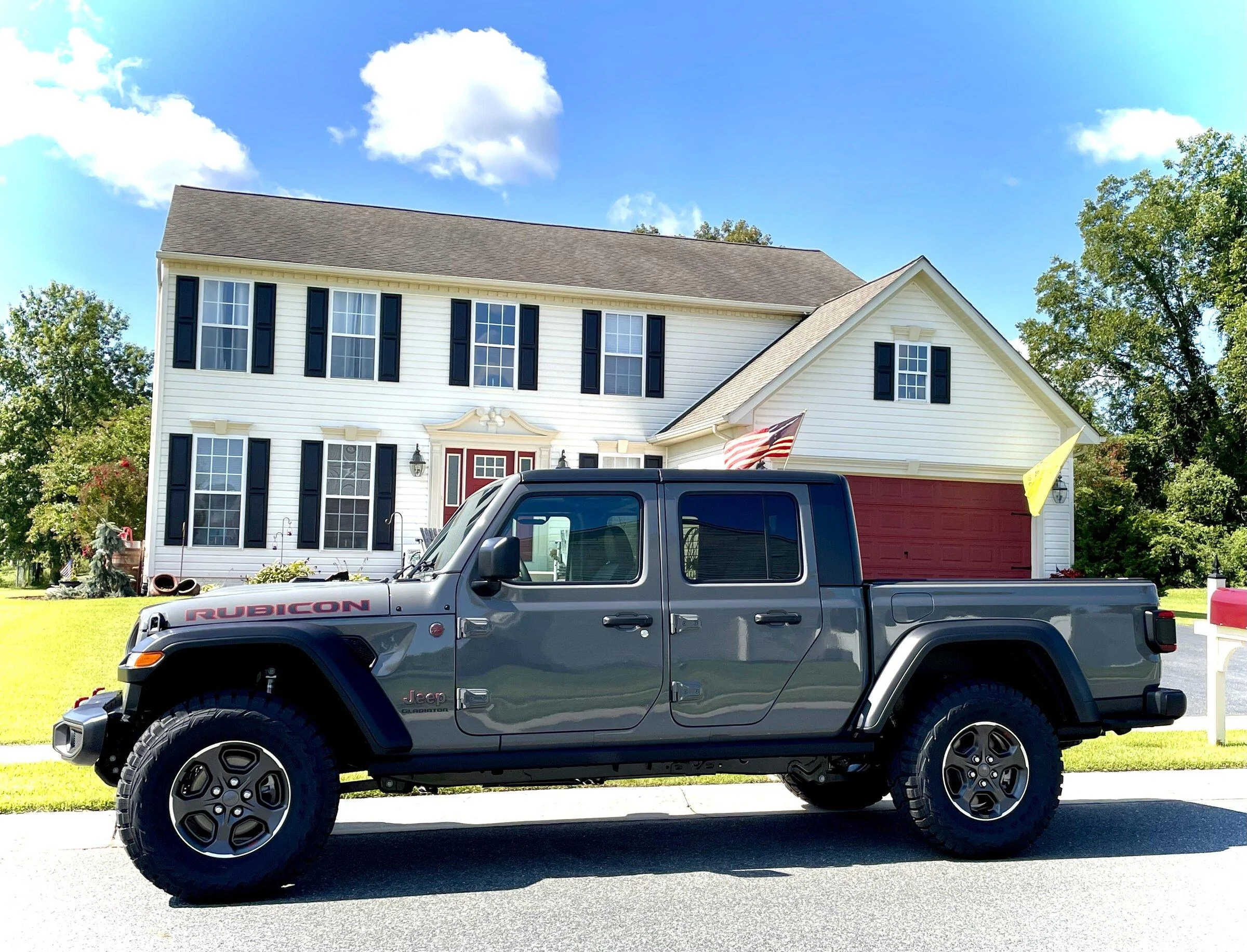

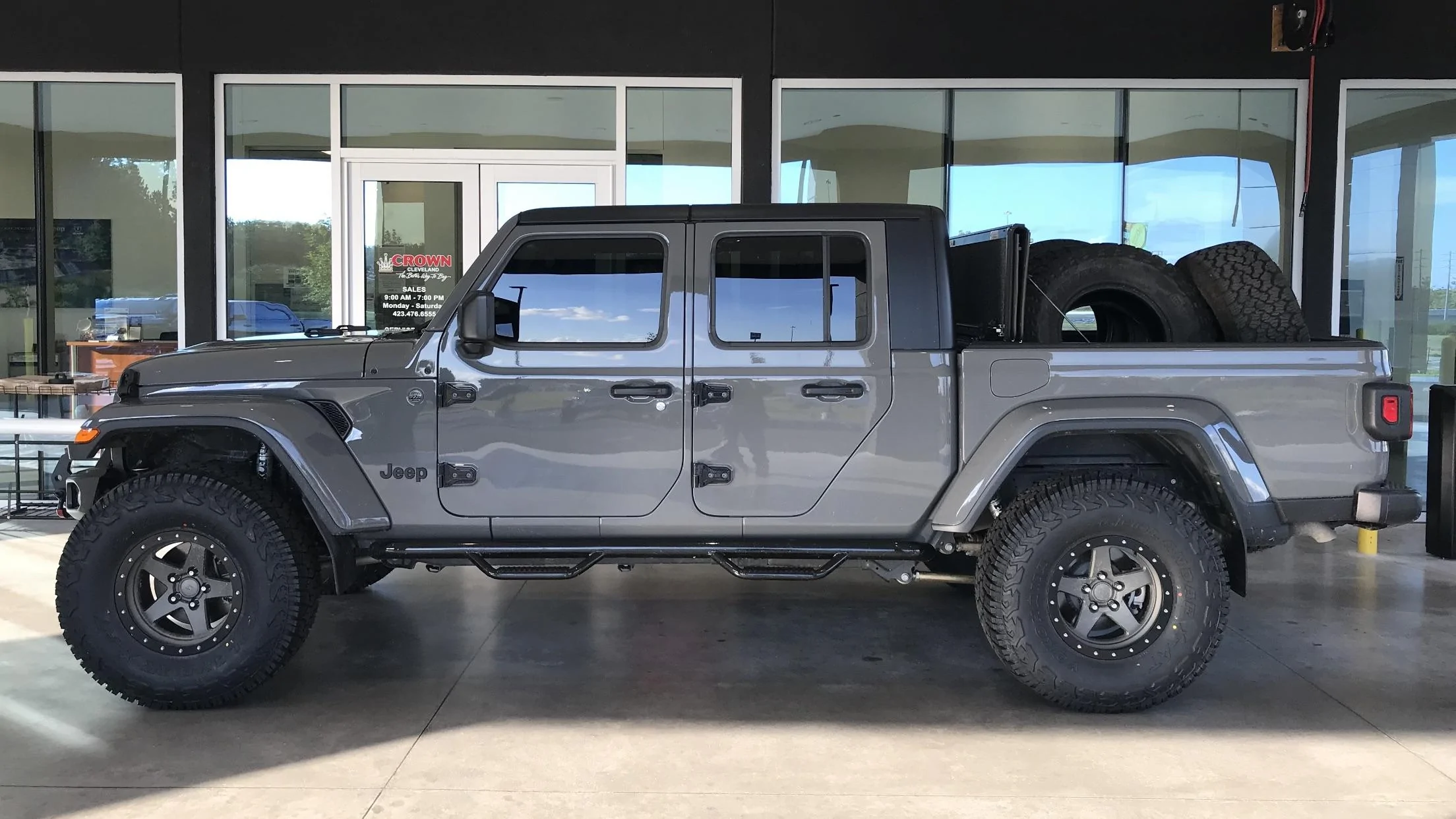

Jeep Gladiator Devils advocate of upping tire size. C84347CF-1761-4137-A127-AB50DDED1765
Jeep Gladiator Devils advocate of upping tire size. 16C9221C-4CCC-4DE2-9A00-4DF98AC49268
This is mine on 35s vs 37s a couple months later. I settled for 35s and kind of regretted it knowing that I wanted 37s. So in the shop it went for a regear to 5.13s and 37s.
