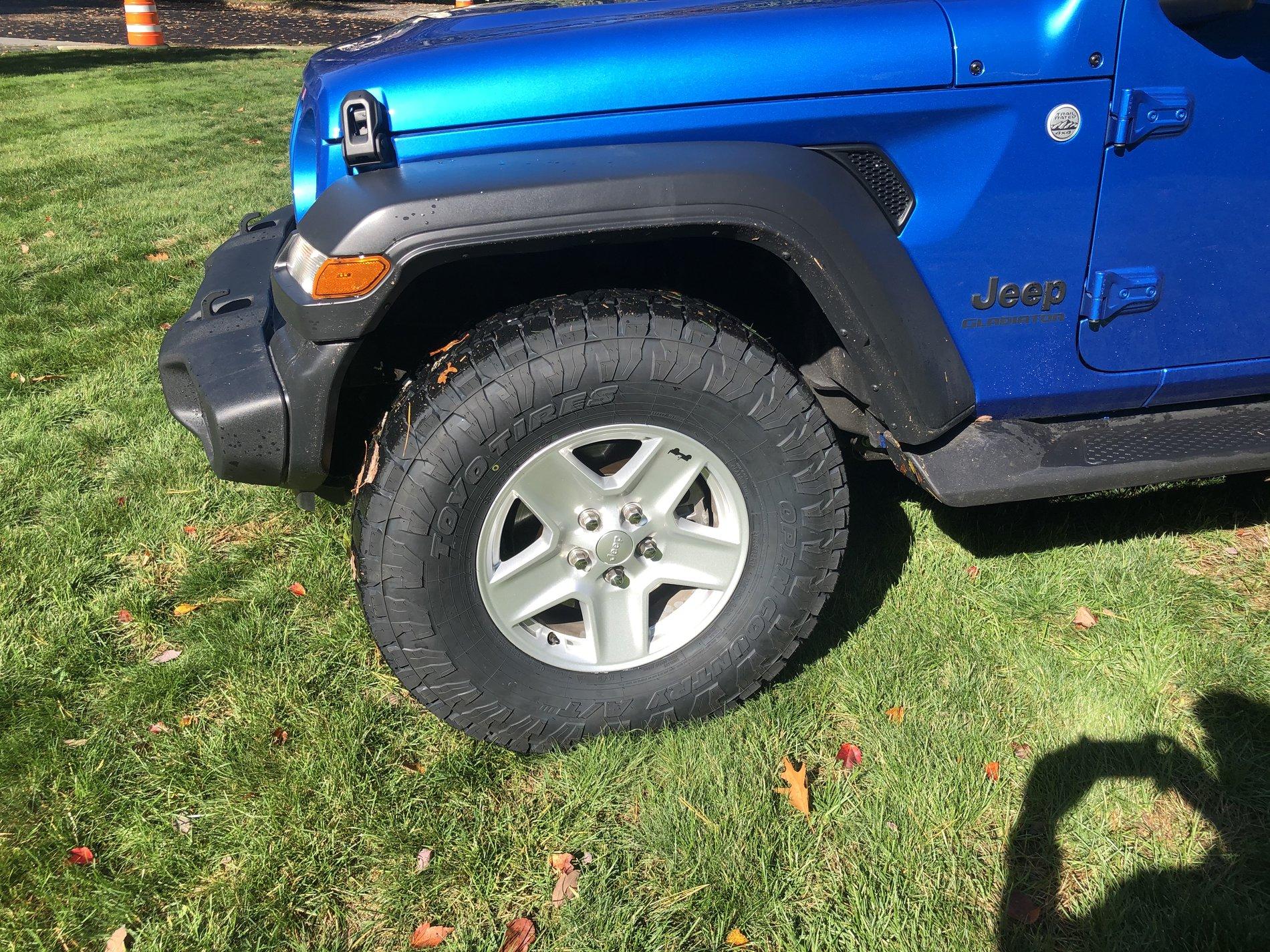

Need advice - Best "upgraded" tire size on stock Sport S rims?

I'm running BFG KO2s on mine in a 315 70 17 which is basically a 35 inch tire. No issues at all with this size on stock wheels. When they wear out I'll get 37 12.5 17 BFG KO2S and they will be fine as well.
How many inch lift on it?
About 3-1/4 in the front and 2.5 in the rear. I'm running a 2.5 inch Readylift SST lift kit with Rubicon Takeoff springs in the front. Kept my max tow springs in the rear. I'm running Goodyear kevlar MTR 37 12.5 17's now.
